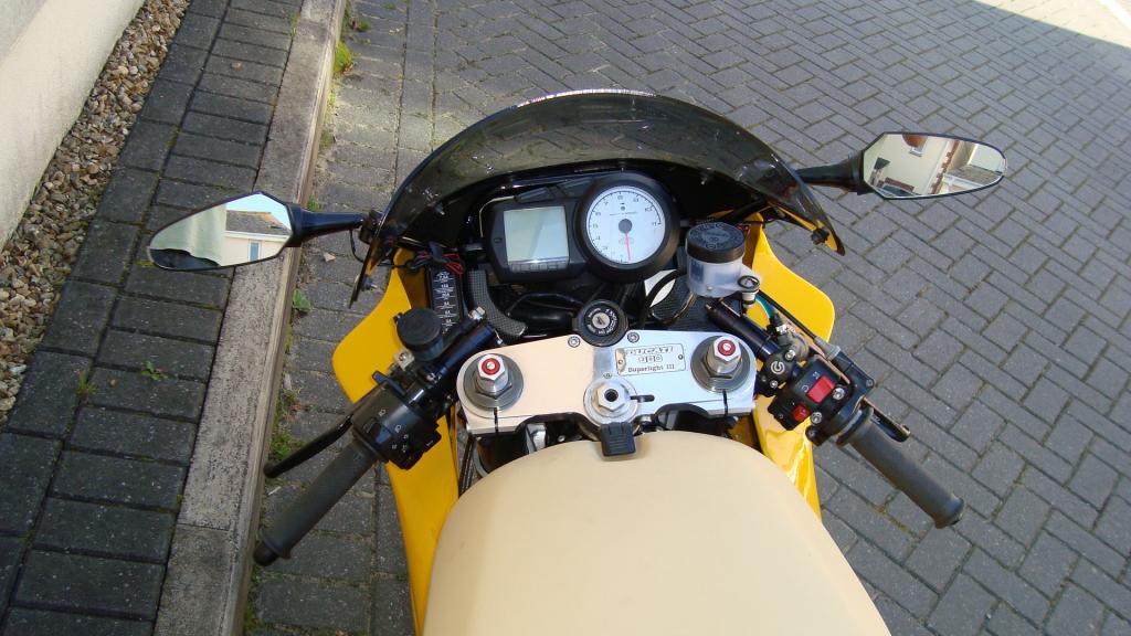

    Howdo!
    I've fitted a set of Moto Science mirrors to my Superlight and are far better, less vibration, longer stem = better visibility (More than just your elbow). Downside they are expensive and you either need to use the supplied fixing bracket or alter the subframe and headlight cowl for the shorter distance between the fixing points (Which you could do for any mirror) I did this as I had altered the headlight frame for other mods & had a new un-drilled cowl.
    223.jpg Moto-Science : The Ducati Mirrors Specialist
    They also have built in LED indicators which initially I wasn't that keen on but have wired them up and they seem ok.
    Cheers Pablo

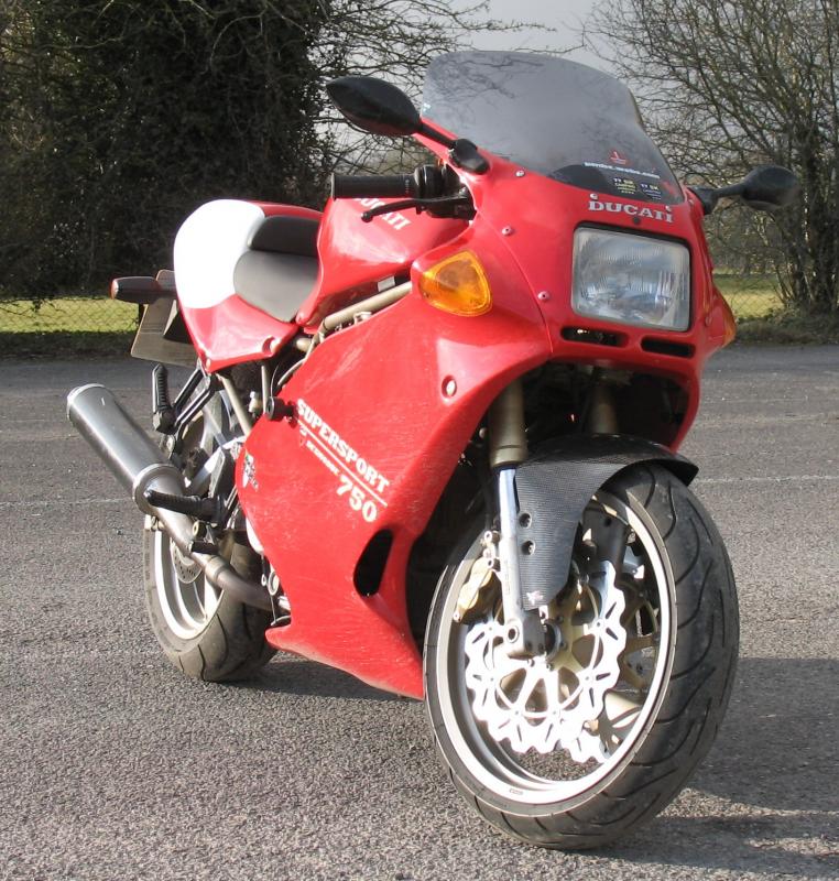

  4. I replaced mine not long after getting the bike as the oem ones where crap!
    i just went for a set of fairly cheep long arm ones, they work fine, with no real vibration, (when in the right gear:rolleyes:)
