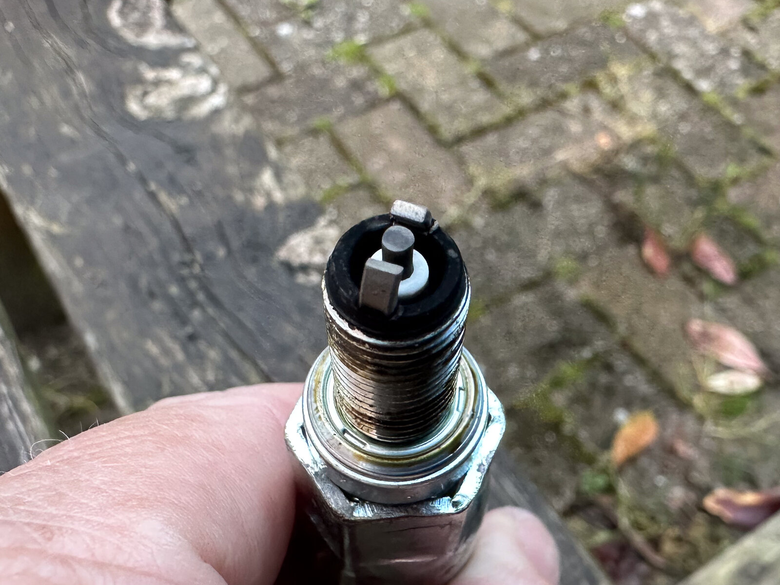

  12. After thinking the bike was sorted after new coils, TPS reset, throttle bodies adjusted, new plugs, new fuel filter and pump checked/cleaned VR wiring plug replaced, today its started with the same symptoms again. It ran well the other day but today its started playing up again with the bogging/stuttering between 3-6000 rpm, above that and she runs fine. Now have it booked in with BSD on there dyno, have to wait until the 13th of June as they are booked solid. Over the phone they think it could be a relay as they have seen it many times on Ducatis with same symptoms so will check that and also a custom map if needed. Suggested that the ecu could be detecting an issue and then compensating by over fuelling at lower revs which is causing the bogging possibly fouling up the plugs, Just want this sorted now as been dragging on : /
  13. Don't you have any codes that could point you in the right direction?
  14. unfortunately no codes on the dash or when my mechanic plugged in to his scanner, hoping getting it on the dyno will give some clues but something is making it run rich. This is a new plug (front) going to pull out the top one for a look soon as I get time
  15. Thanks need to check other plug tomorrow and see if both cylinders playing up, not checked injectors yet will google how to do that. Will look at the links iawdiag thanks, no codes on dash at the moment
  16. You can to some extent just eye them once removed, blocked holes or gummed up etc. Clean with brake cleaner and tap them like a generator. To really check them you need an injector tester. If they look suspicious or if you have only one cylinder with rich mixture i would just replace both injectors to rule them out.
    In iawdiag you can also see soft codes with does not show on dash and stored codes if they have not been cleared.
  17. Thanks put a new fuel pump relay in and new plugs and its still running like a pig even cut out on me twice after it got up to 84 degrees when I got stuck at a railway crossing, pulled away and it just cut out restarted while rolling and did it again.

  18. I'm still thinking it's fuel related. Have you tried E5 fuel and injection cleaner such as stp?
    How was the rear plug? Also black?
    Does it run bad all the time or is it intermittent?
