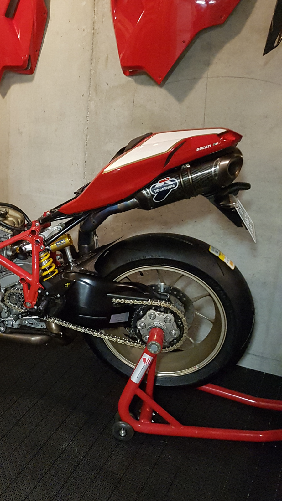

I have a AFAM carrier. At the moment I´m running a superlight sprocket at the rear. Actually looks realy similar to the one one the picture.
I have a AFAM carrier. At the moment I´m running a superlight sprocket at the rear. Actually looks realy similar to the one one the picture. View attachment 94304
