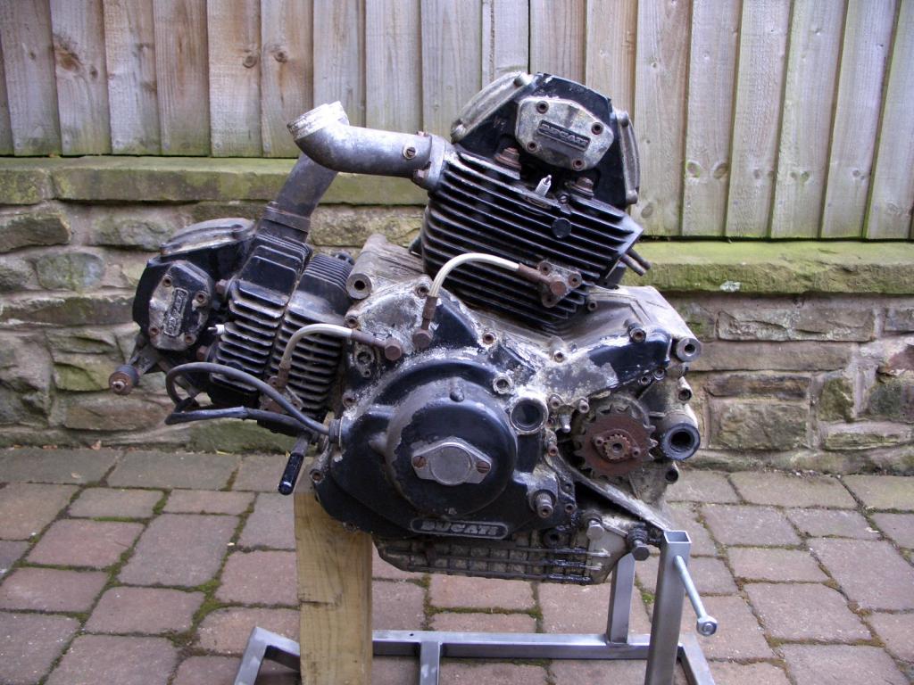

    engine before:
    Sorry don't have an 'after' shot yet...

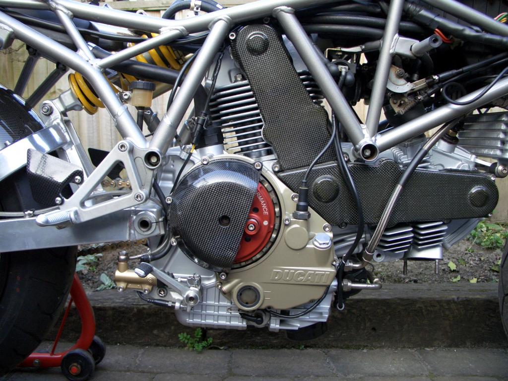

    but here's one I did earlier (900 SS/IE):

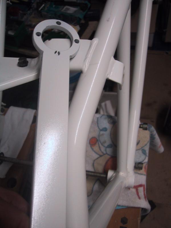

  19. I think vauxhall polar white is ok for the frame.
    I keep offering the test piece up and really can't pick any difference in colour, not sure if anyone can tell any better from picture.
