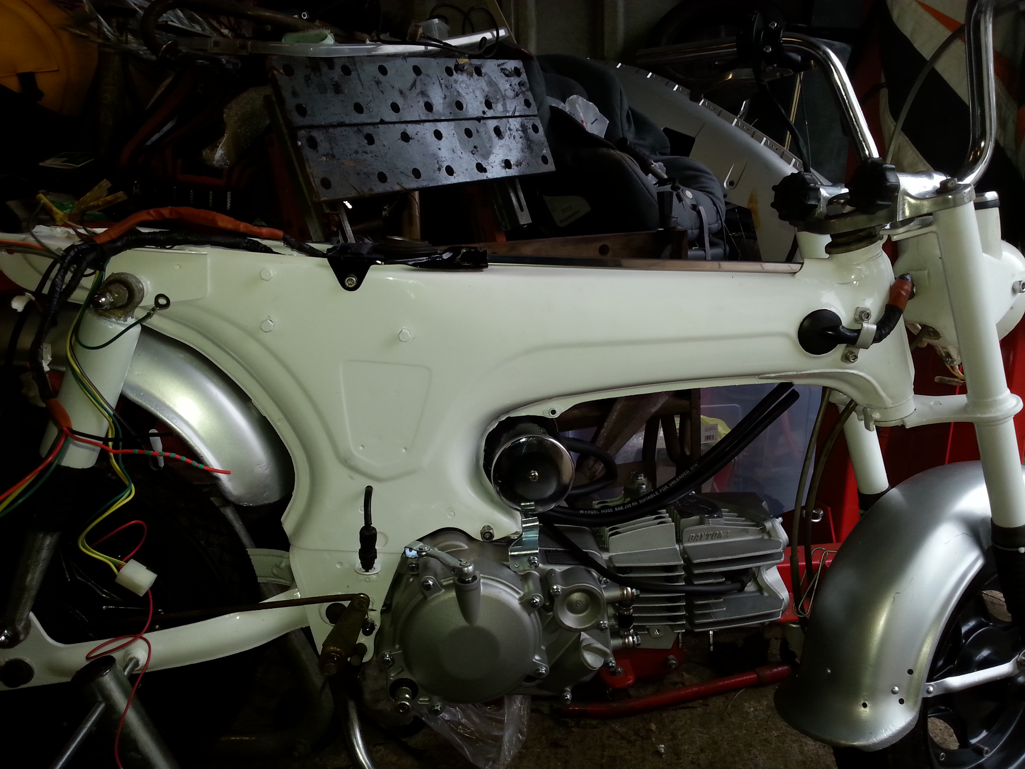

  3. Just in the process of doing mine. Fitted a Daytona 150 4 valve motor and 12 volt electrics. Need Oil Cooler and exhaust and we are ready to go

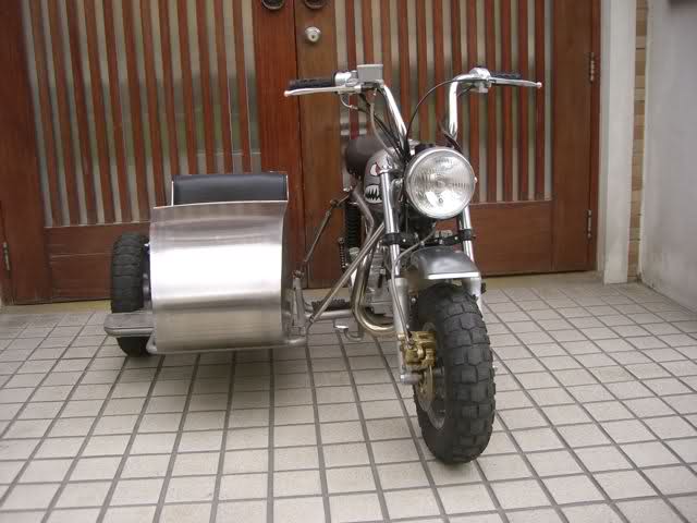

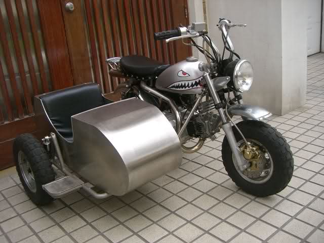

    Here is another of my custom Z50 bikes (sidecar) great shopping trolley and turns quite a few heads riding down the road in Shanghai. The base for the build was a Jincheng 50cc monkey bike replica in 2002 and still own and ride the bike today.
