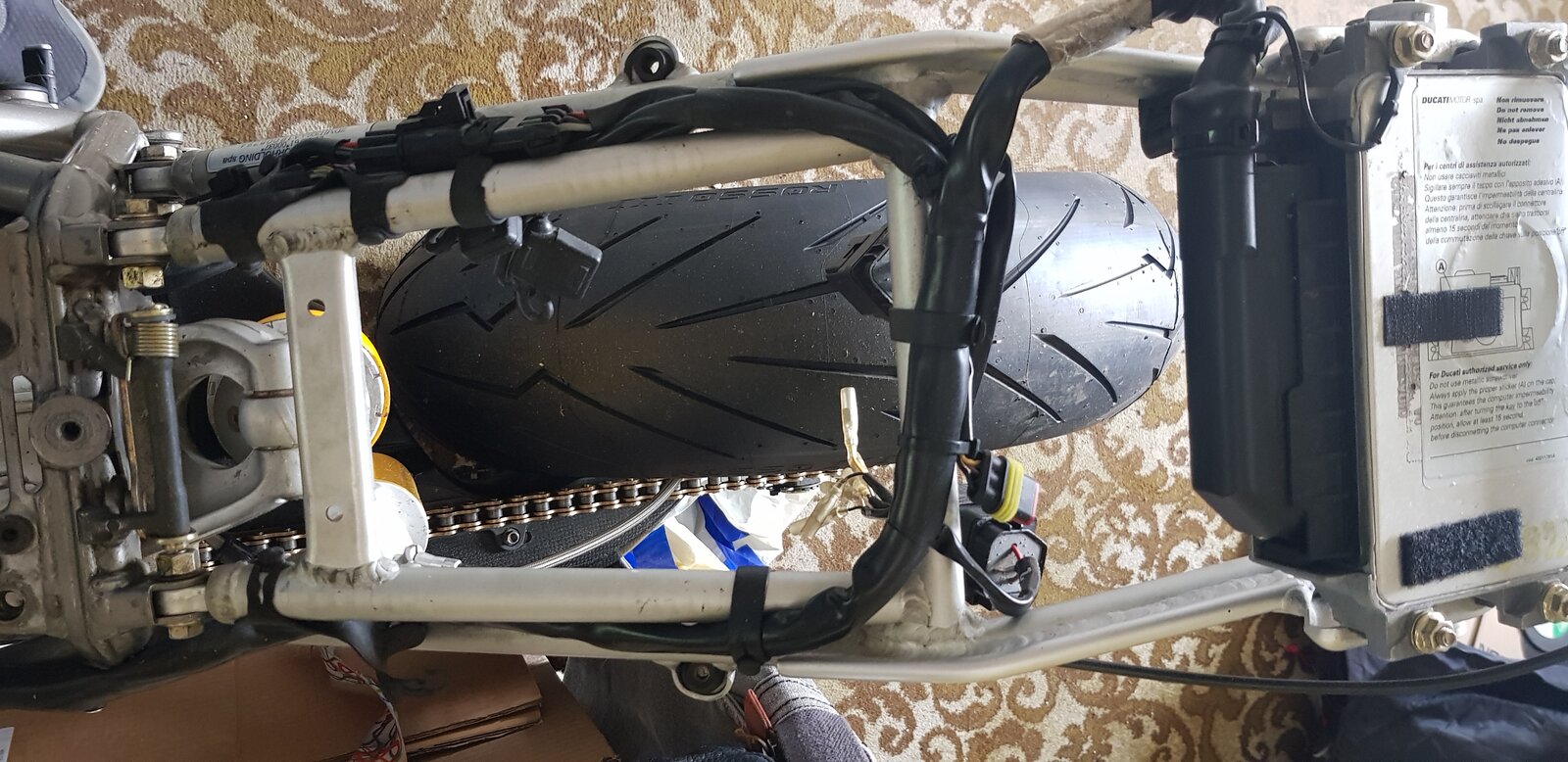

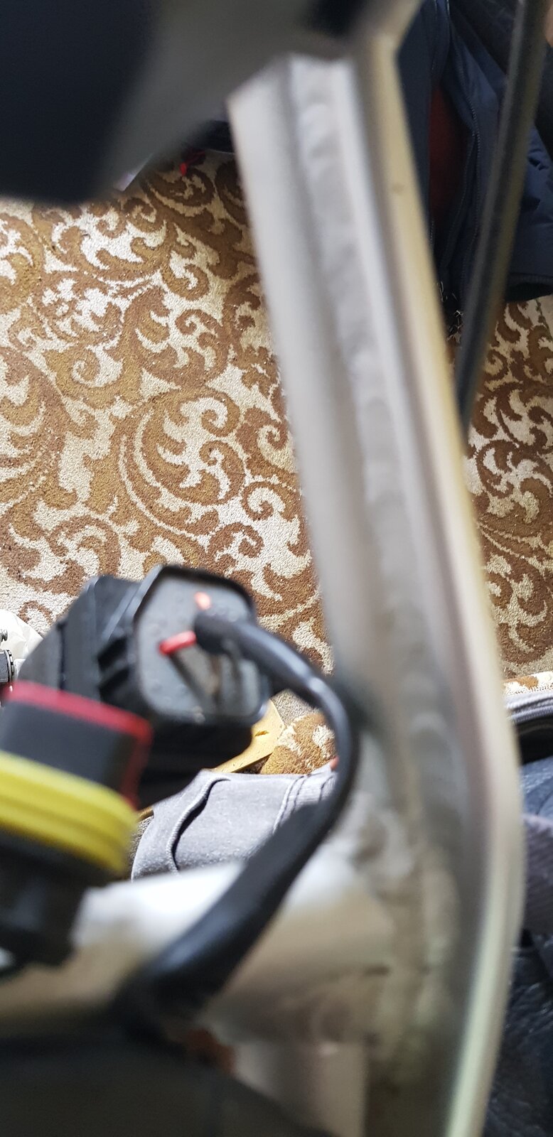

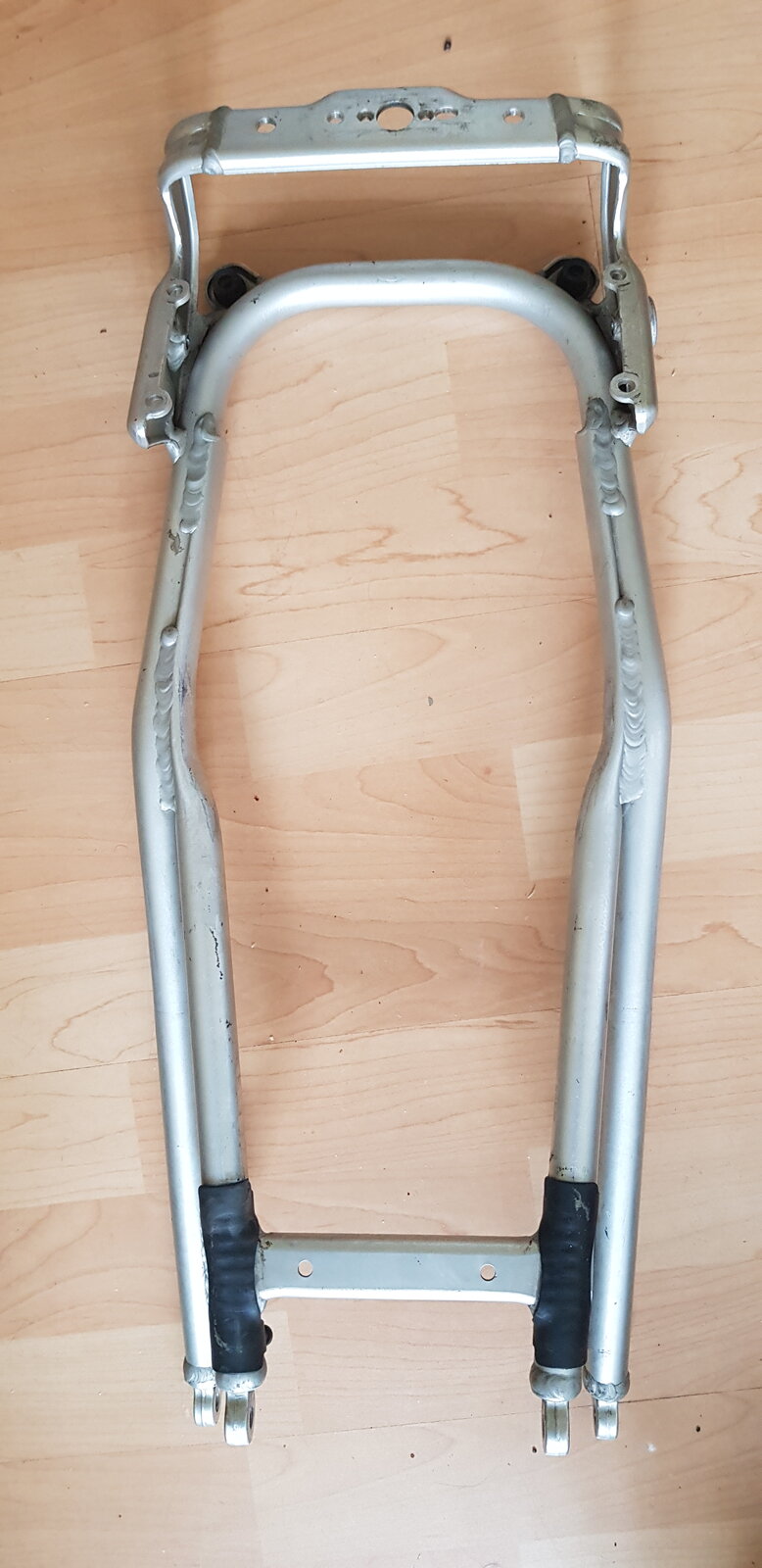

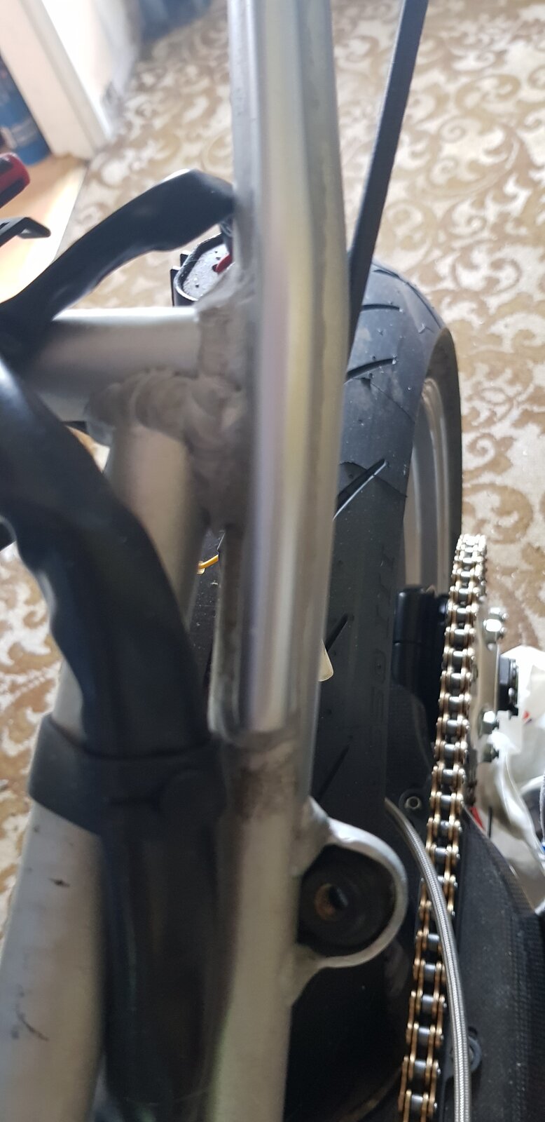

So this is what a 2001 748R rear sub frame should look like. And this is a 2002MY reinforced rear sub frame. As you can see from the last two pictures, the genuine bracing added an aluminium bar on top of the side rails not the abortion in your link. If I had to make a living with welding like that, I'd have starved to death. Not sure if the other bikes the listing mentioned had the 1.6M ECU because if they didn't, the sub frame won't fit without relocating the ECU. IMO, it is most definitely not worth £450. Andy
Andy’s right. And looking at the photos, the back half of the subframe had already snapped before the amateur attempt to strengthen it
