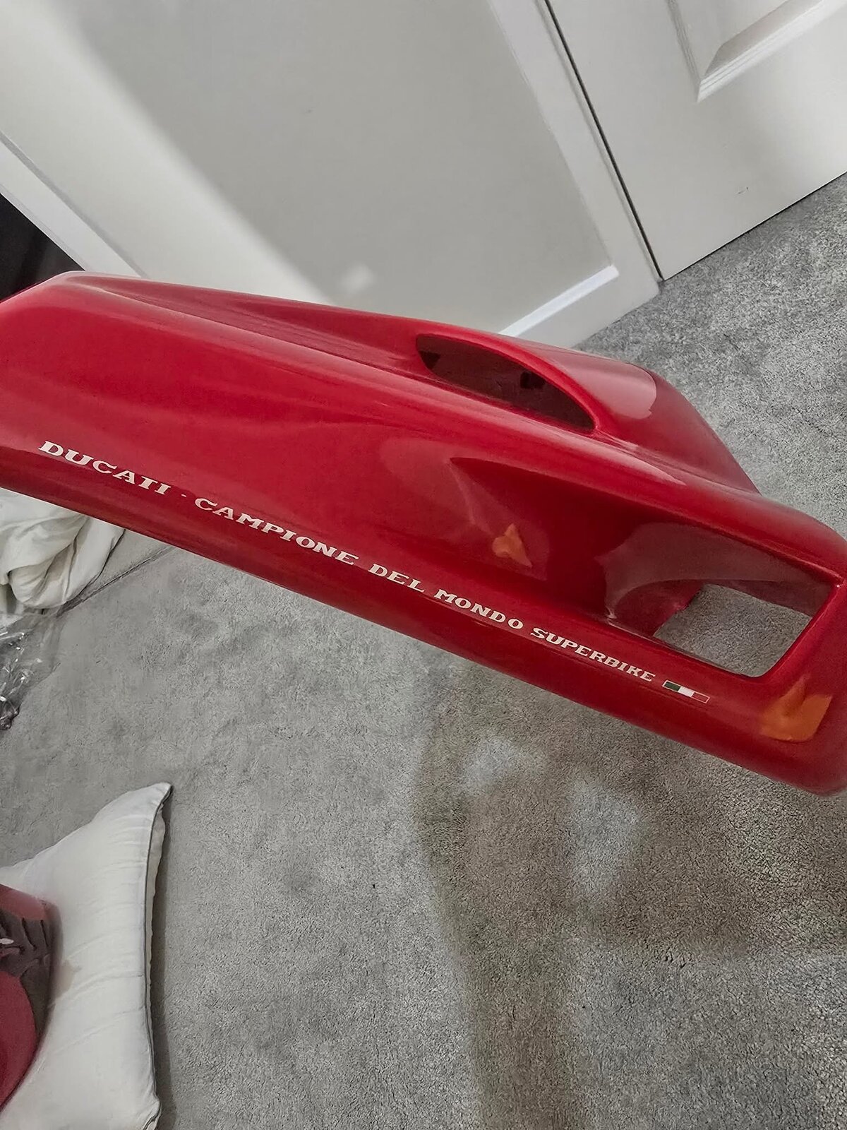

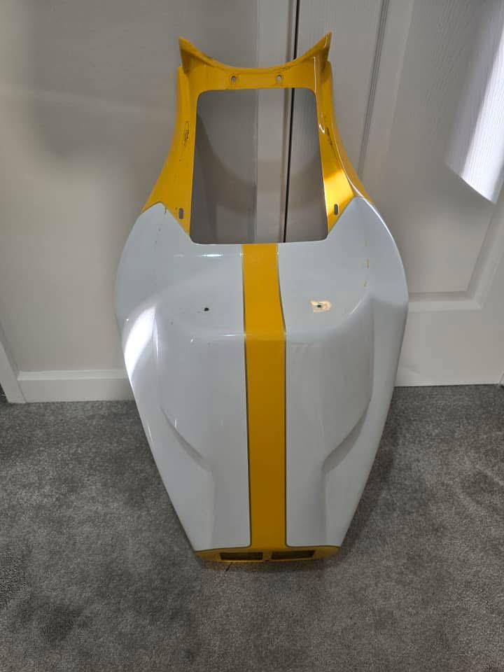

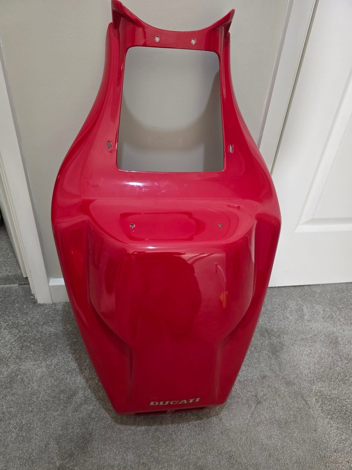

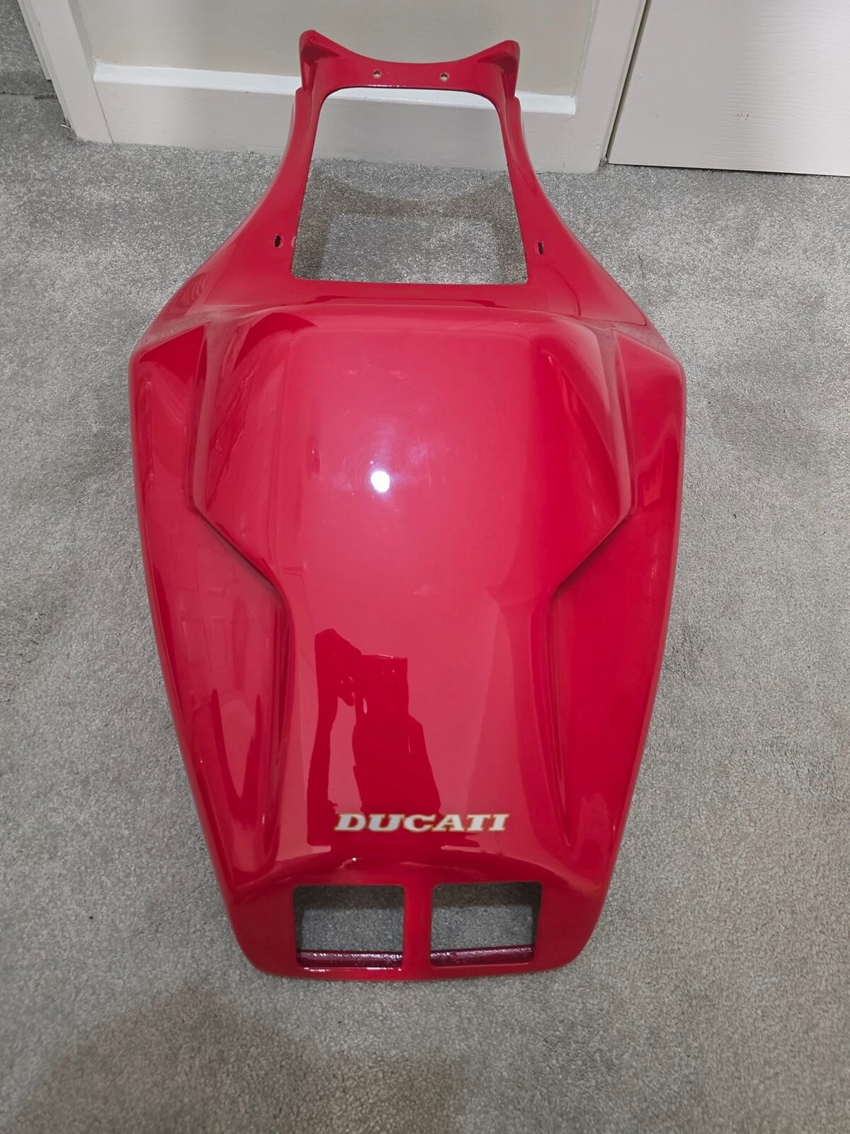

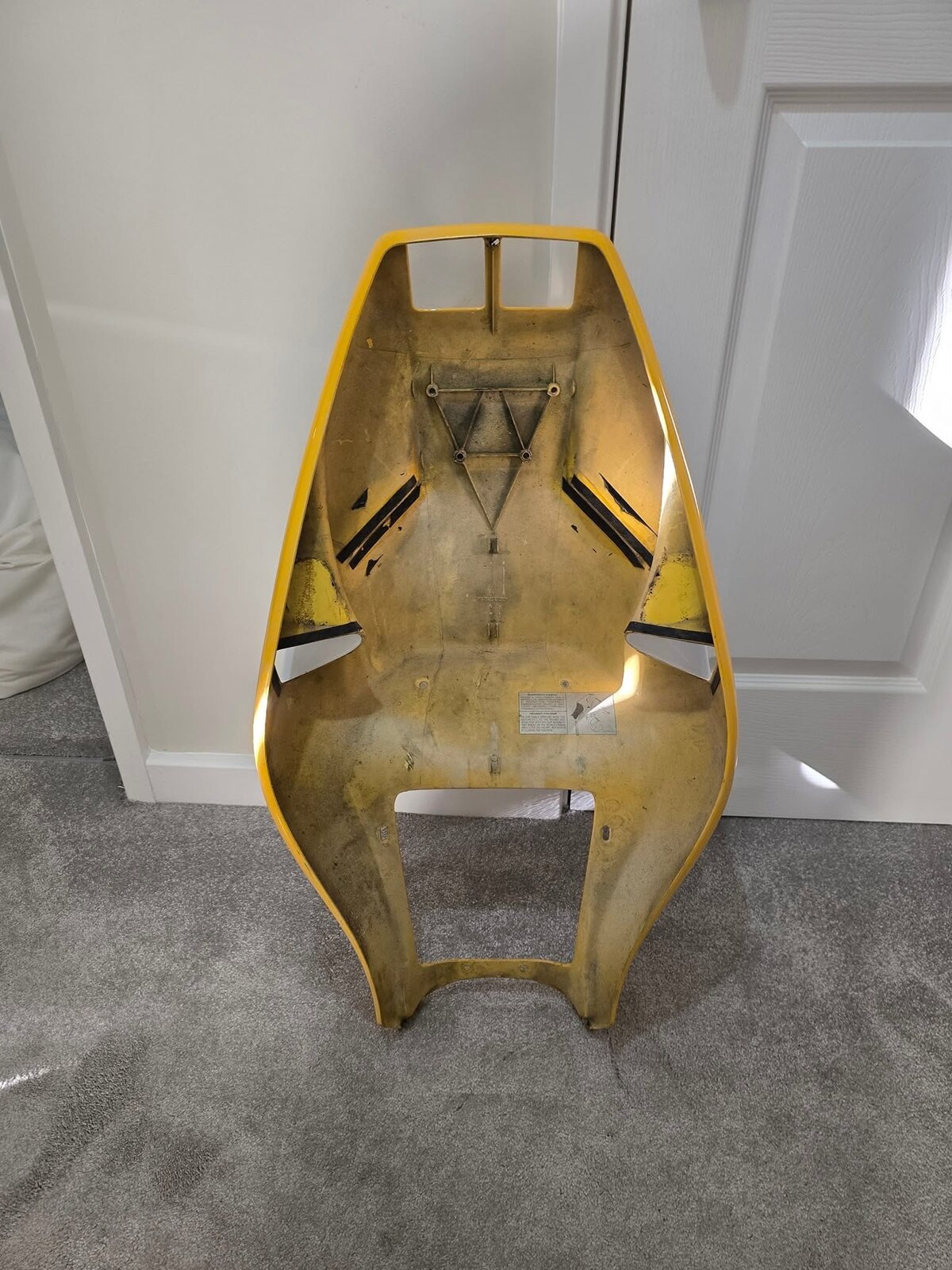

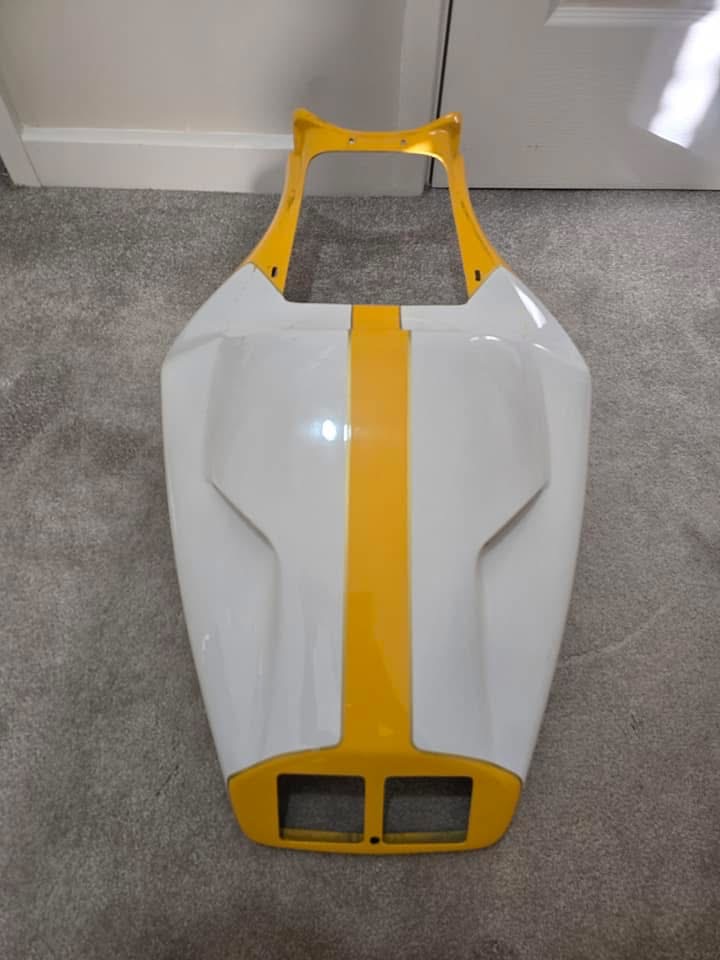

  1. IMG_2491.jpeg IMG_2490.jpeg IMG_2489.jpeg IMG_2488.jpeg IMG_2492.jpeg IMG_2493.jpeg IMG_2494.jpeg Would someone be kind enough to shed some light on the model these rear seat fairings have come from please?
    My thought is that the red is a 916 Strada or early 916 & the yellow from a 748?
    Thanks in advance
  2. Yellow one looks either 748sp, sps , r model.
    Is there any decals on the side of the yellow one??

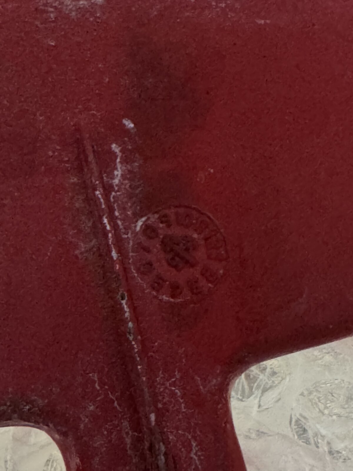

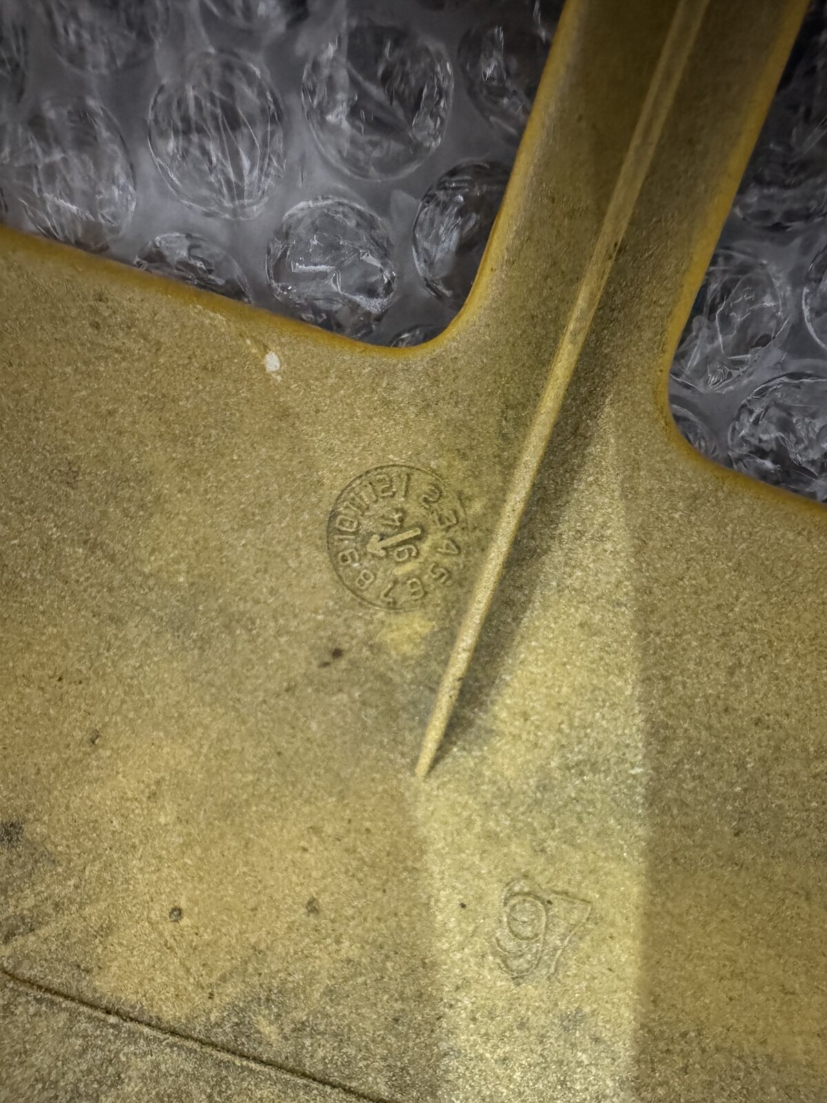

  3. There’s a wee circular date stamp on the inside down by the rear lights might be helpful.
  4. I have an SPS and I think it actually has 748 SPS written on the side at the bottom. I don't have the seat on the bike, but can check if you really want to know.
  5. IMG_2497.jpeg The yellow has no written decals on the side which is why I was unsure. It’s dated September 94.
    The red is dated August 94
  6. Both could be from a 916 Strada which you could buy in red or yellow. The 748SP was launched in 1995, which, given Ducati’s legendary “parts bin” assembly strategy, the yellow seat could be an SP. I’ve not been able to establish if the gold pinstripe was 916 and 748SP or just SP. Andy
  7. I have an SPS and the gold pinstripe was left on for those model years. Looking at my SPS, most of the parts were made in 1998 with a few in 1997, although the bike was registered in late 1999.
  8. Thanks for all the info.
    Seems it’s a 916 strada & SPS then!
