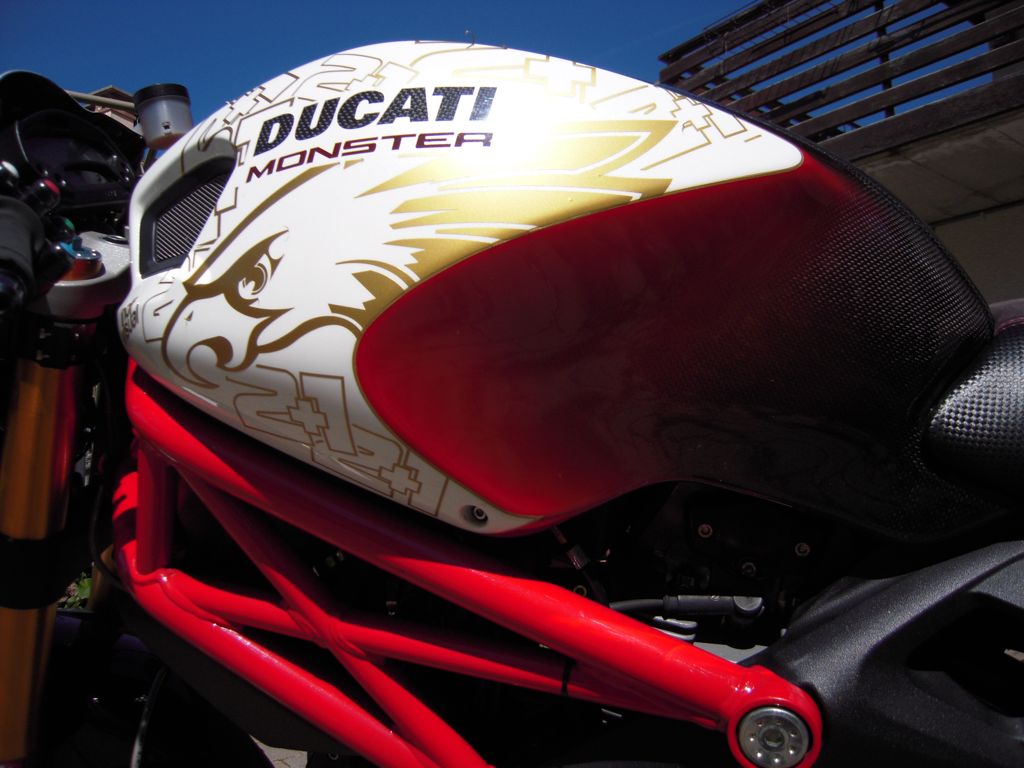

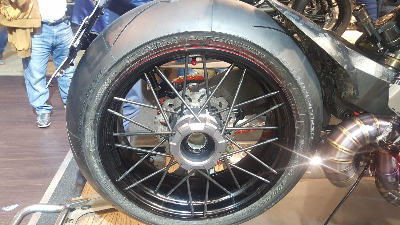

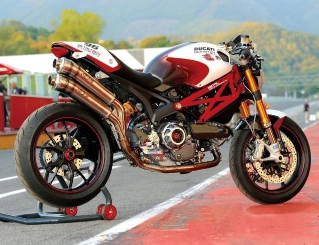

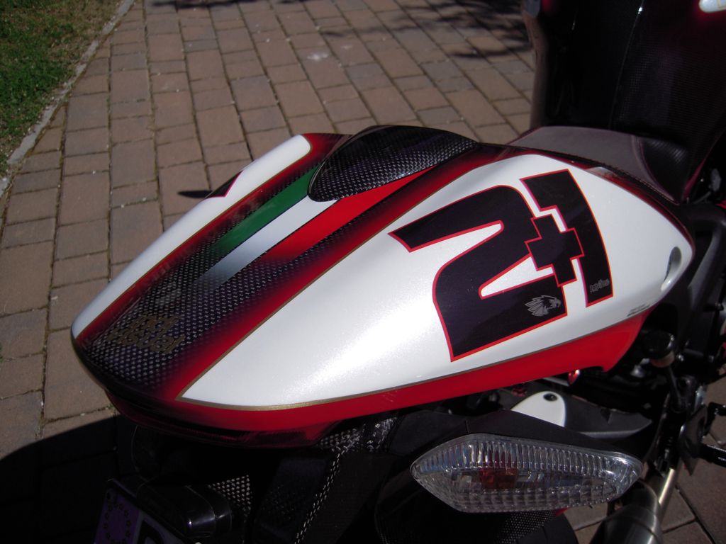

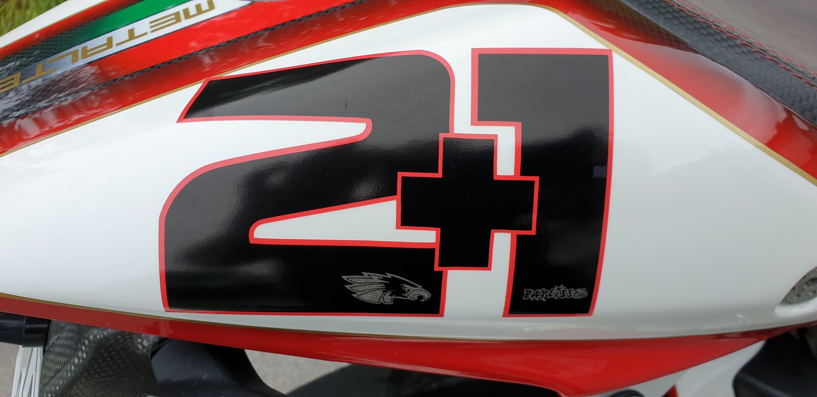

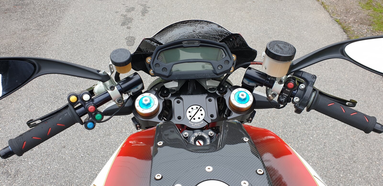

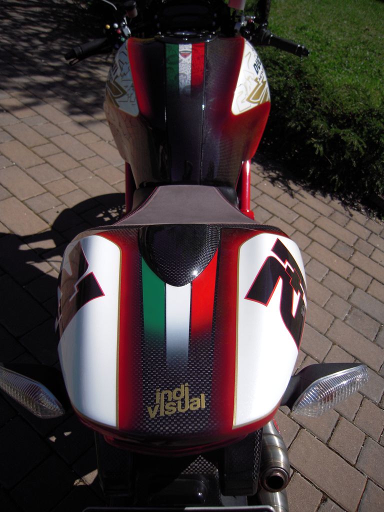

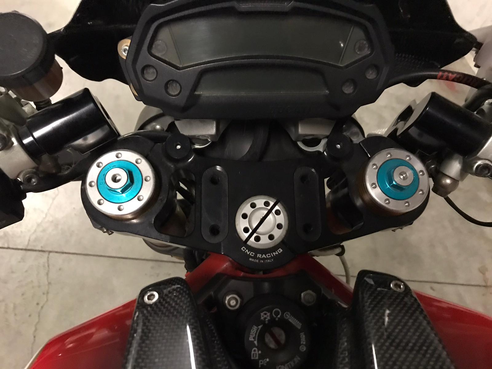

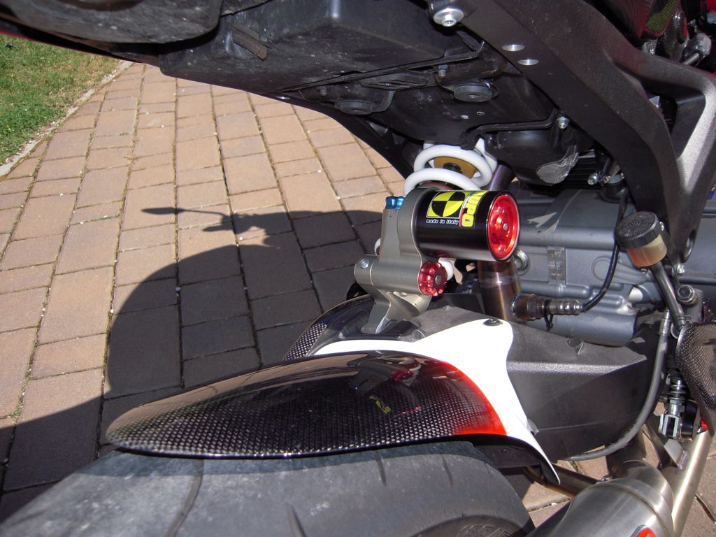

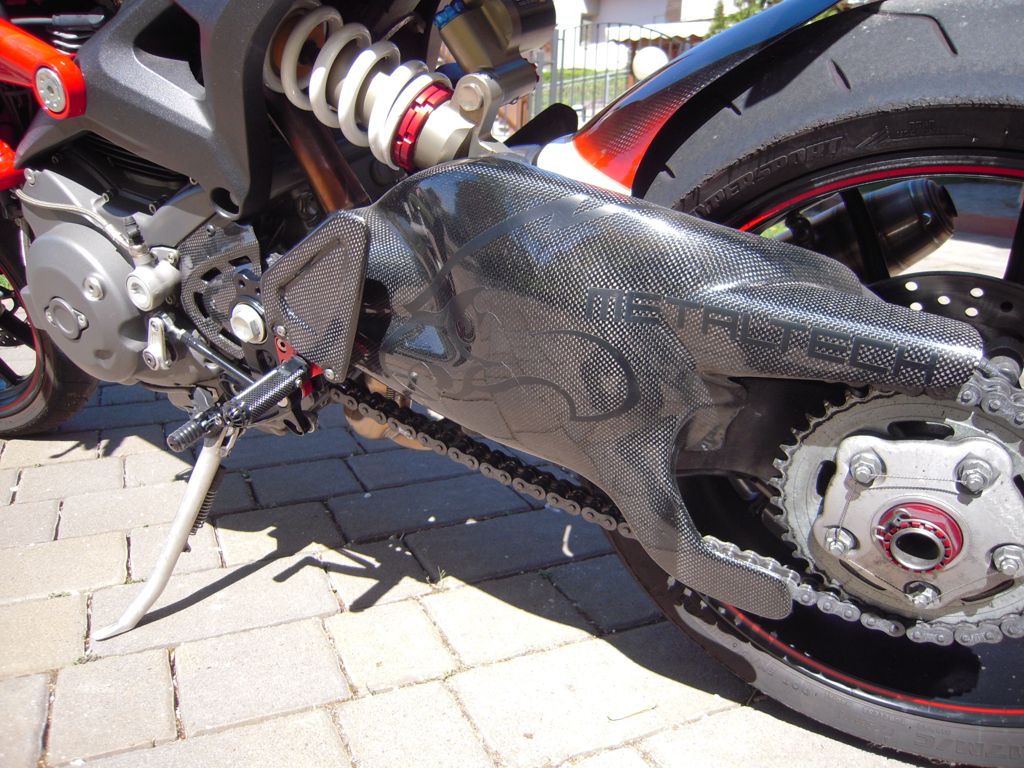

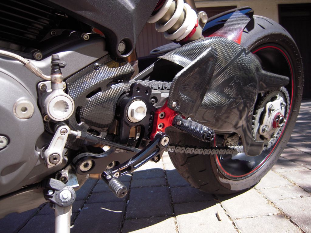

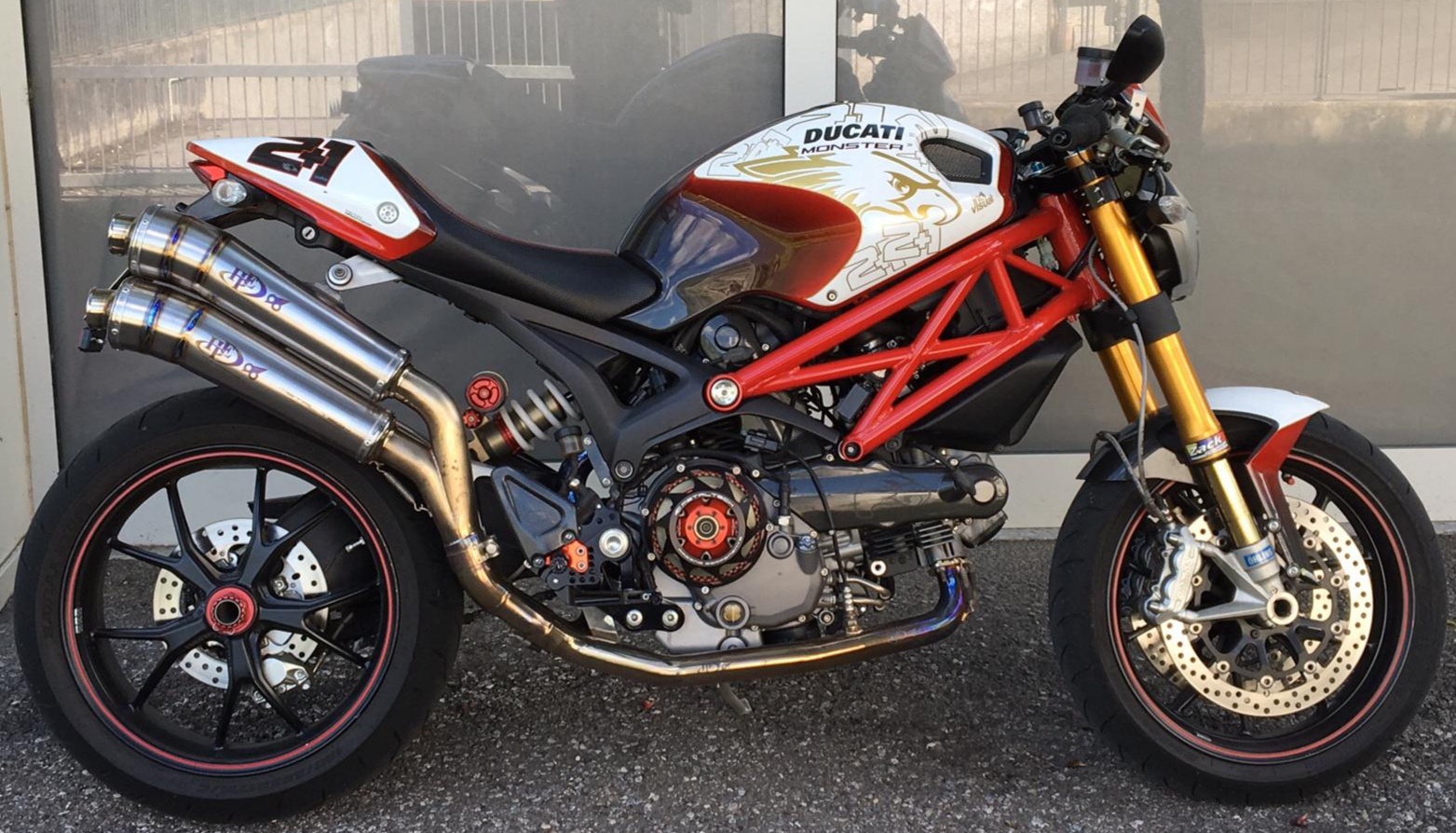

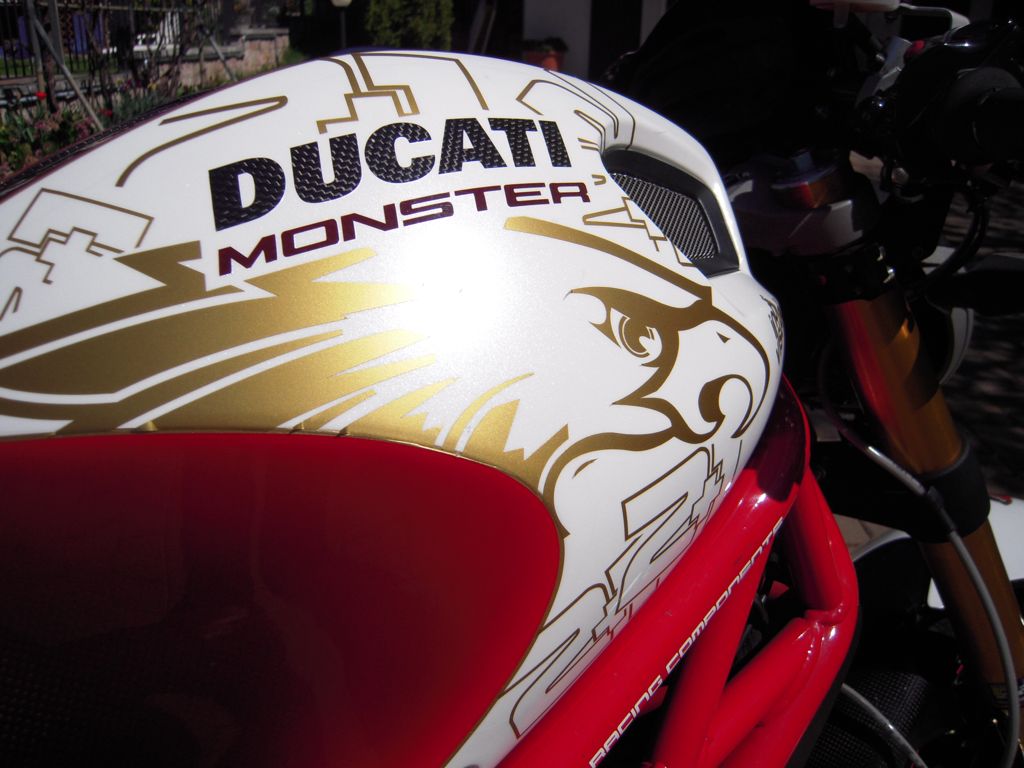

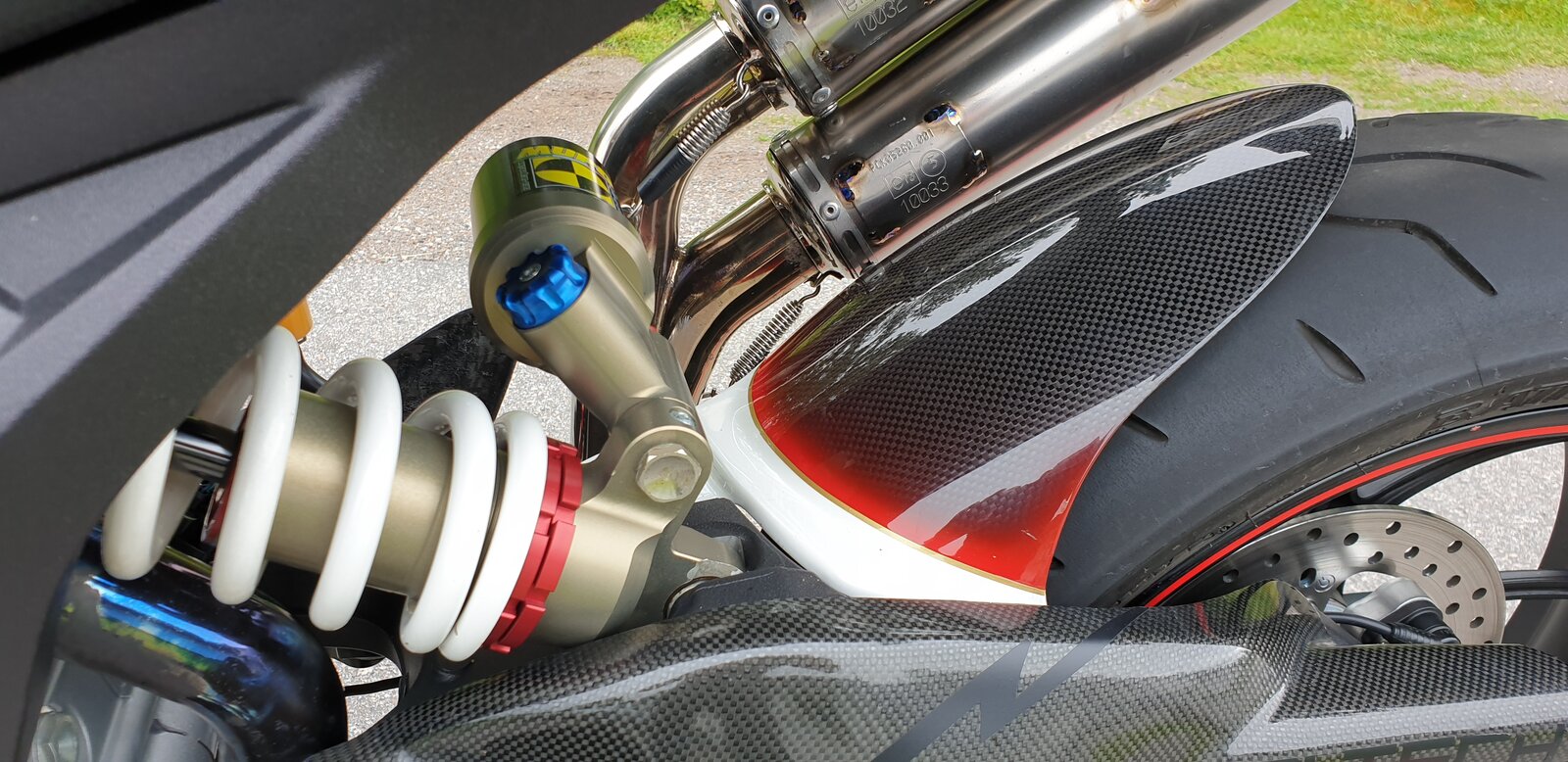

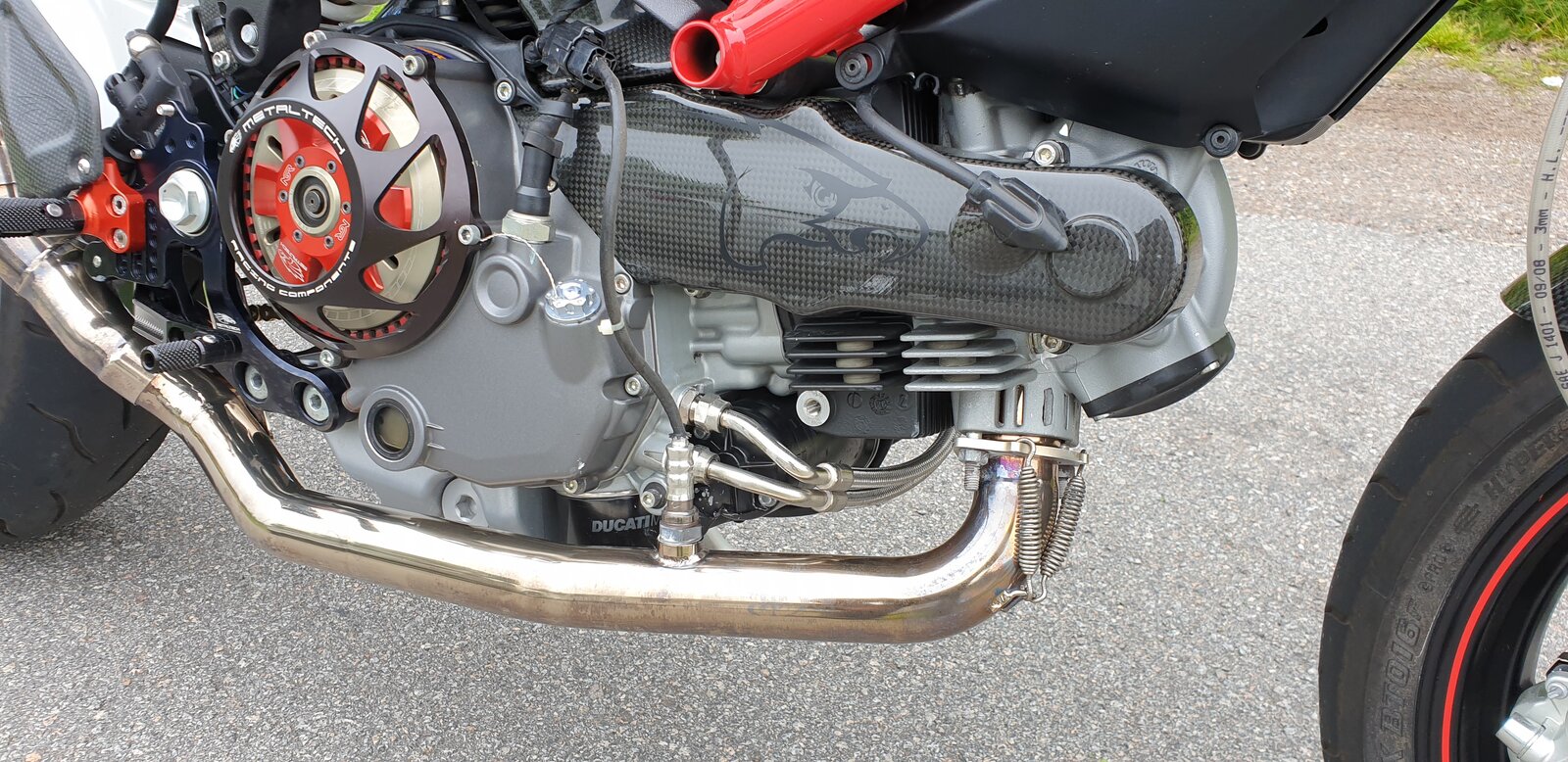

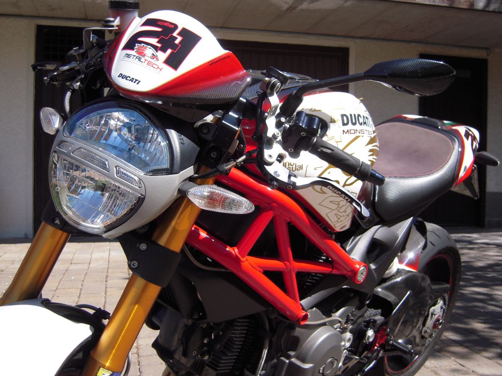

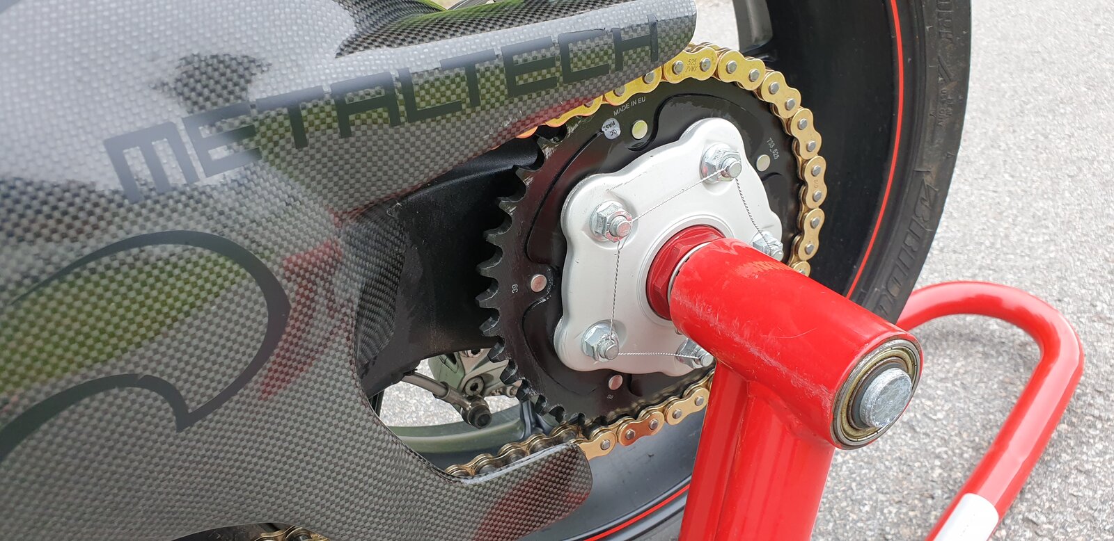

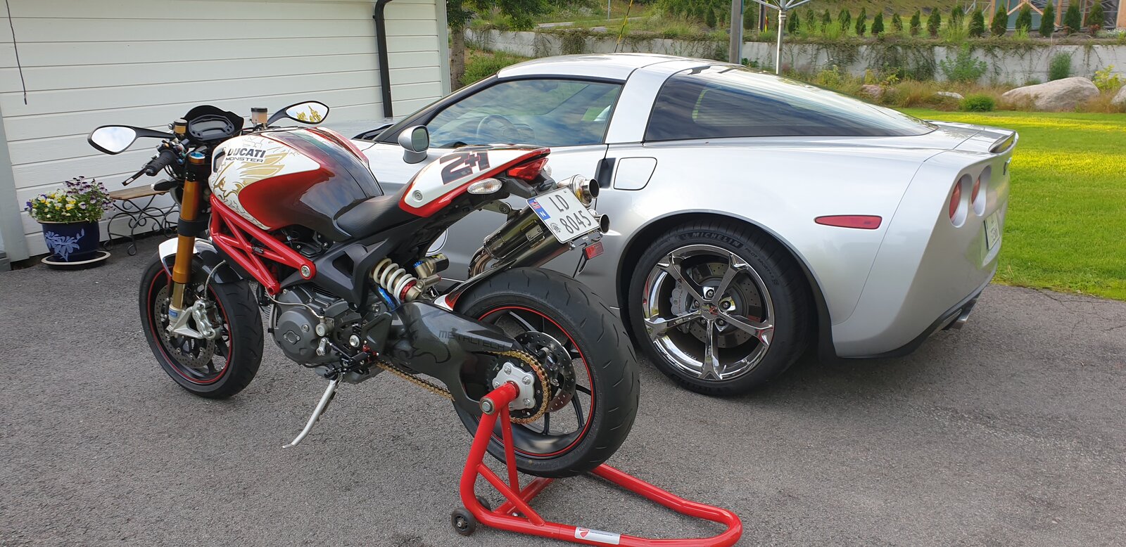

  1. I have been lucky and given the opportunity to take over this great Monster.
    This is my 3 Monster 1100 and I love these Ducati. Great design, fun to drive, air-cooled engine, dry clutch, and a fantastic sound and lots of low torque
    This is a very special Ducati Monster 1100, with lots of nice and expensive parts.
    To name the most important:
    - Ohlin's fork yard by SBK mechanic
    - Mupo rear shock
    - SBK slipper clutch
    - Metal Tech SBK adjustable footrest
    - SBK switches
    - Steering crown of CNC Racing in 7075 alu
    - brake and clutch lever in 7075 alu, Brembo
    Lots of carbon parts
    - alcantara sete
    - HPE exhaust
    The previous owner has worked in the MotoGP / Supebike "circus", and the Monster was modified when it was new by the company Metal Tech in Italy. It was exhibited at various events in connection with MotoGP and SBK, and World Ducati Week. It was exhibited at WDW 2012 and chosen to be one of the 10 most beautiful of the thousands who participated in the competition, and it was exhibited for 3 years in a row at EICMA (Milan motorcycle show) All parts of it are e-marked and approved, made by companies he collaborated with in his job in the racing world. Troy Bayliss # 21 was test driver, along with test driver for Ducati Luca Scassa # 99

  2. That's had the kitchen sink thrown at it
    Edit: Just realised that you're in Norway and 'might' not get the statement. I mean to say that the bike has had a lot of shiny items fitted :)
  3. Feck me pooh bear on steriods,welcome and looking fruity.:upyeah:
  4. Nice trinket.
    All that dosh chucked at it yet still has the original wooden calipers...
    Pretty though.
  5. Hilsener!
    Rather a pretty machine.
  6. Nice bike ,
  7. I have visited Tønsberg many times but never seen a decent bike there! Very nice Monster :upyeah:
  8. And wheels .
  9. Lots to choose from here, but one of my favorites is these rims from Borani. Artwork

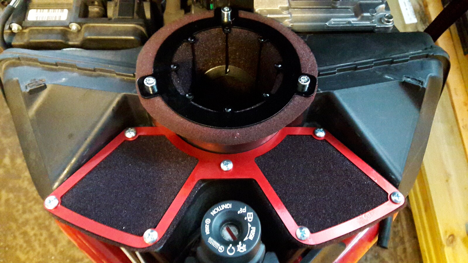

  13. This amazing Monster deserves a tuning that works. Since I have previously rebuilt 2 Monster 1100 Evo and 1 Hypermotard 1100 Evo SP with this setup, it was easy for me to choose this solution for this one as well.
    ECU will be mapped with Hypertrick map from Italia Bike Center in Arboga in Sweden.
    The mapping is set up with MWR air filter, and works perfectly.
    The engine then gets both higher power and torque, but most importantly, it becomes silky smooth to run at low speeds. With this setup, it also works in the city. The sound from the intake is magical and addictive. Recommended :upyeah:
    Picture of previous conversion of an 1100 Evo

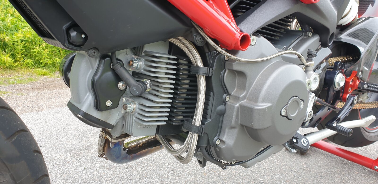

    Well, I like to wash a little too. Grease and dirt must not be allowed to stick.
    Once it has burned well into the cooling fins, then you have a problem.
    I usually spray the engine with engine cleaner, and then I have a paintbrush that I clean between the cooling fins, and in tight places. I also have a product (Diamant Weisserstein) that I use on cooling fins and exhaust systems. Then I wash with a good shampoo.
    I like her clean ;)

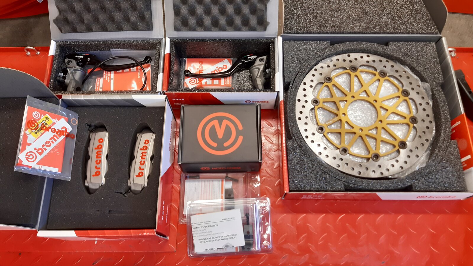

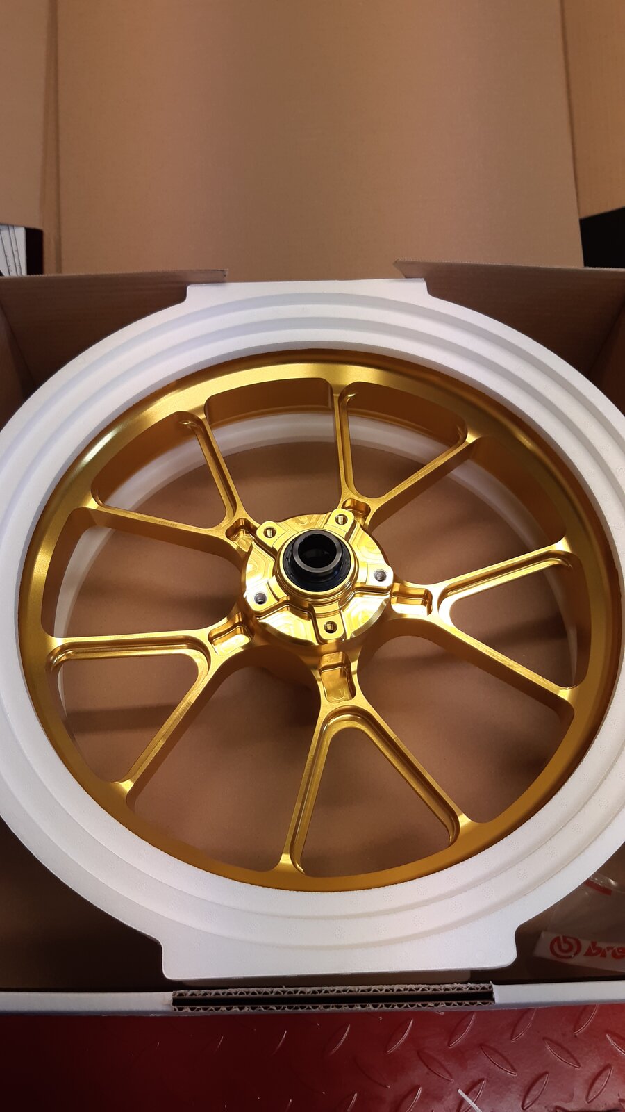

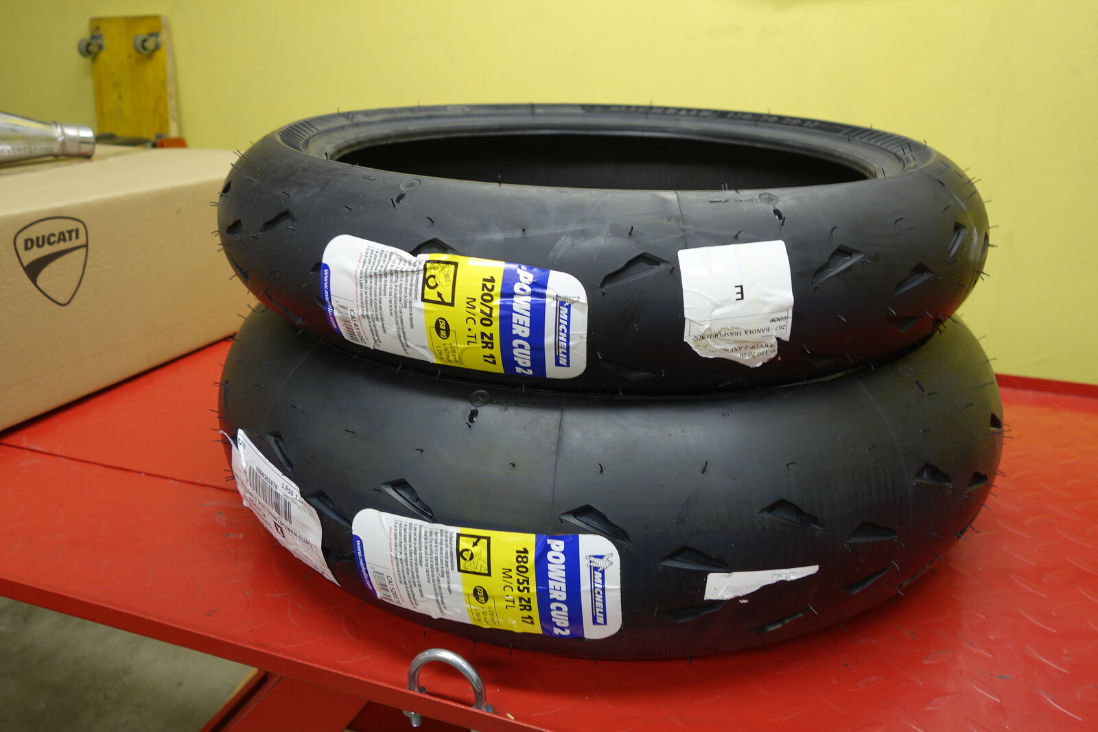

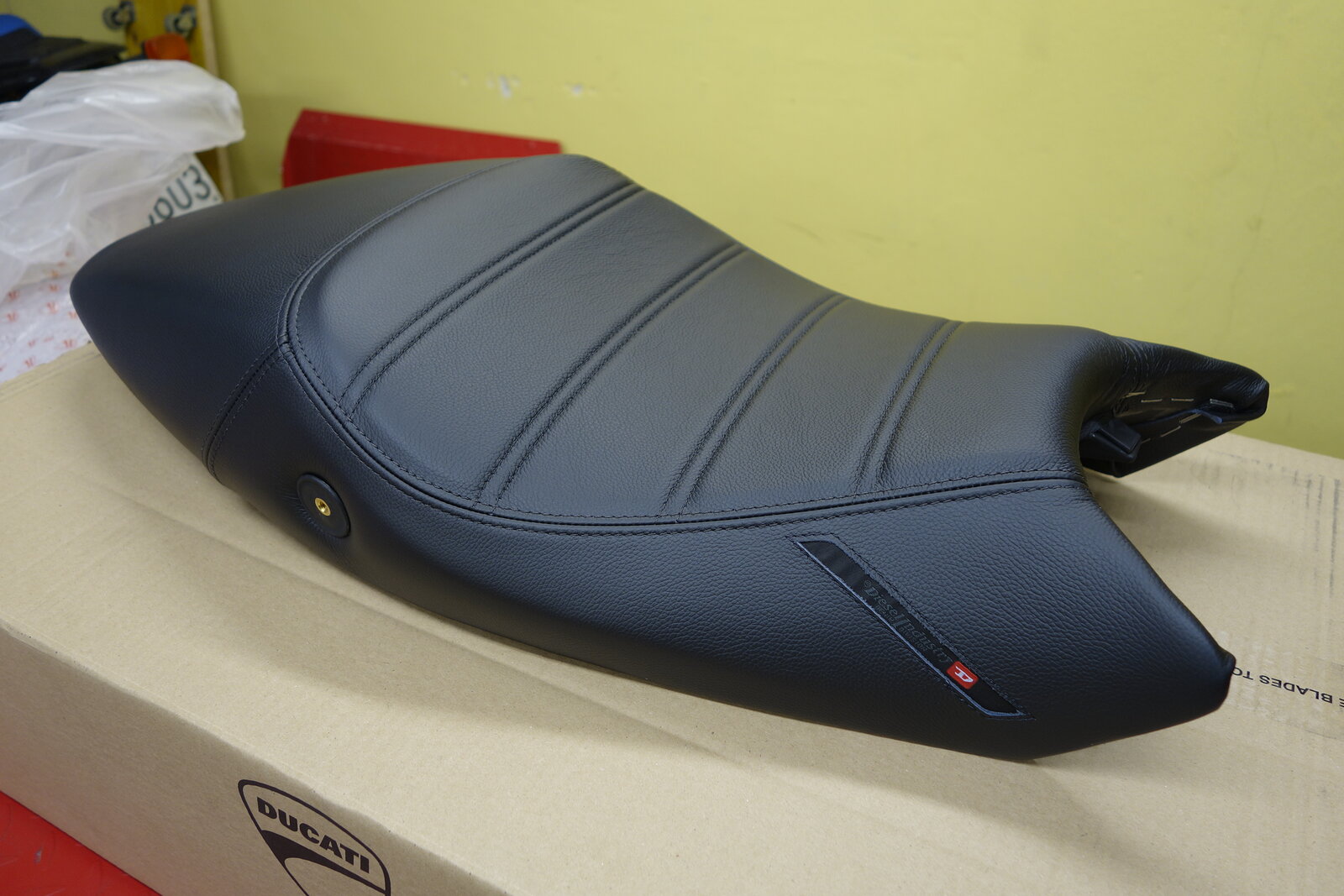

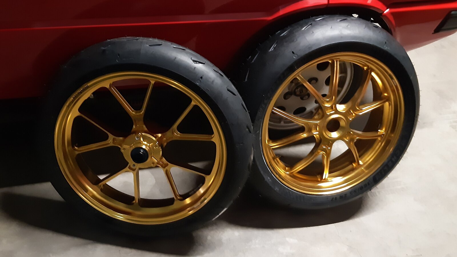

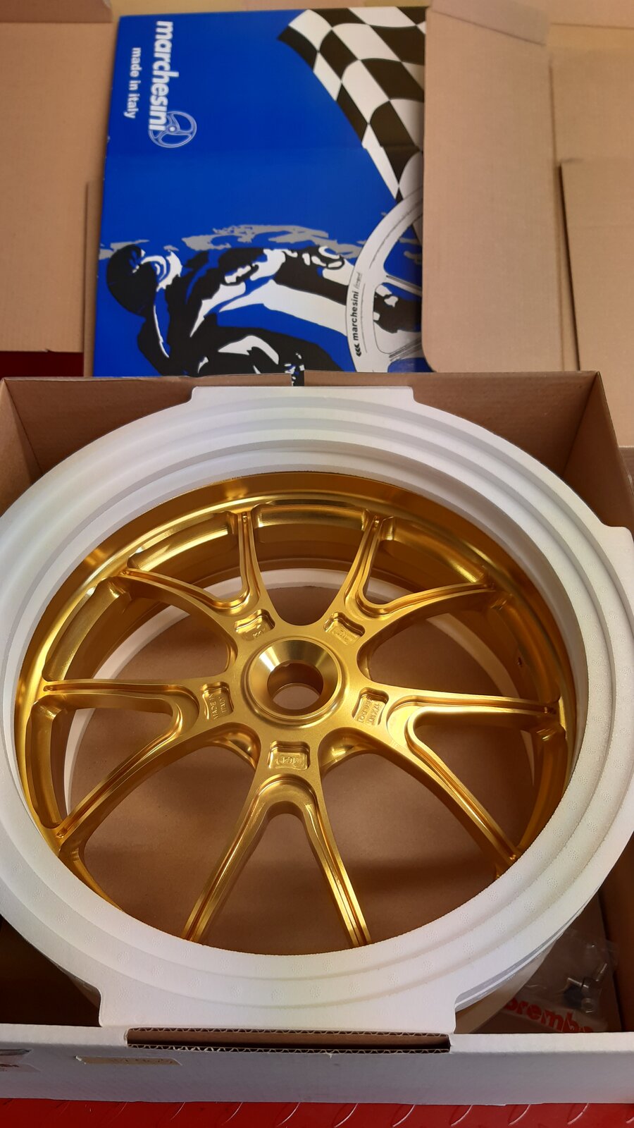

  15. Then the list of ordered parts for my Monster has arrived.
    The parts come up from Italy in April via my contact person in Italy Jan Kristiansen.
    He also runs the company mcimport.it, and imports motorcycles from Italy to Scandinavia.
    Can highly recommend him.
    MCIMPORT.IT
    • M10RS Compe rims in gold, anodised
    • brake caliper M4
    • RCS 19 corsacorta brake pump
    • RCS 16 corsacorta clutch pump
    • Motocorse black retain. corsacorta RCS
    • RCS corsacorta mirror holders right
    • RCS corsacorta mirror holders left
    • Brake discs "Supersport"
    • NCR clutch slave pump
    • Monster Diesel seat
    • used air filter box + (MWR Power up Filter Kit + Hypertrick map)
    • Michelin Power Cup 2
      20220325_113245.jpg 20220325_113253.jpg 20220325_112716.jpg _DSC1127.JPG _DSC1129.JPG 1200x900-Motocorse-RCS19CCB1-500x500.png 20220326_101053.jpg
  16. Nice shopping trip!
  17. Lovely :cool:
    But these fluid reservoirs have to go :upyeah:

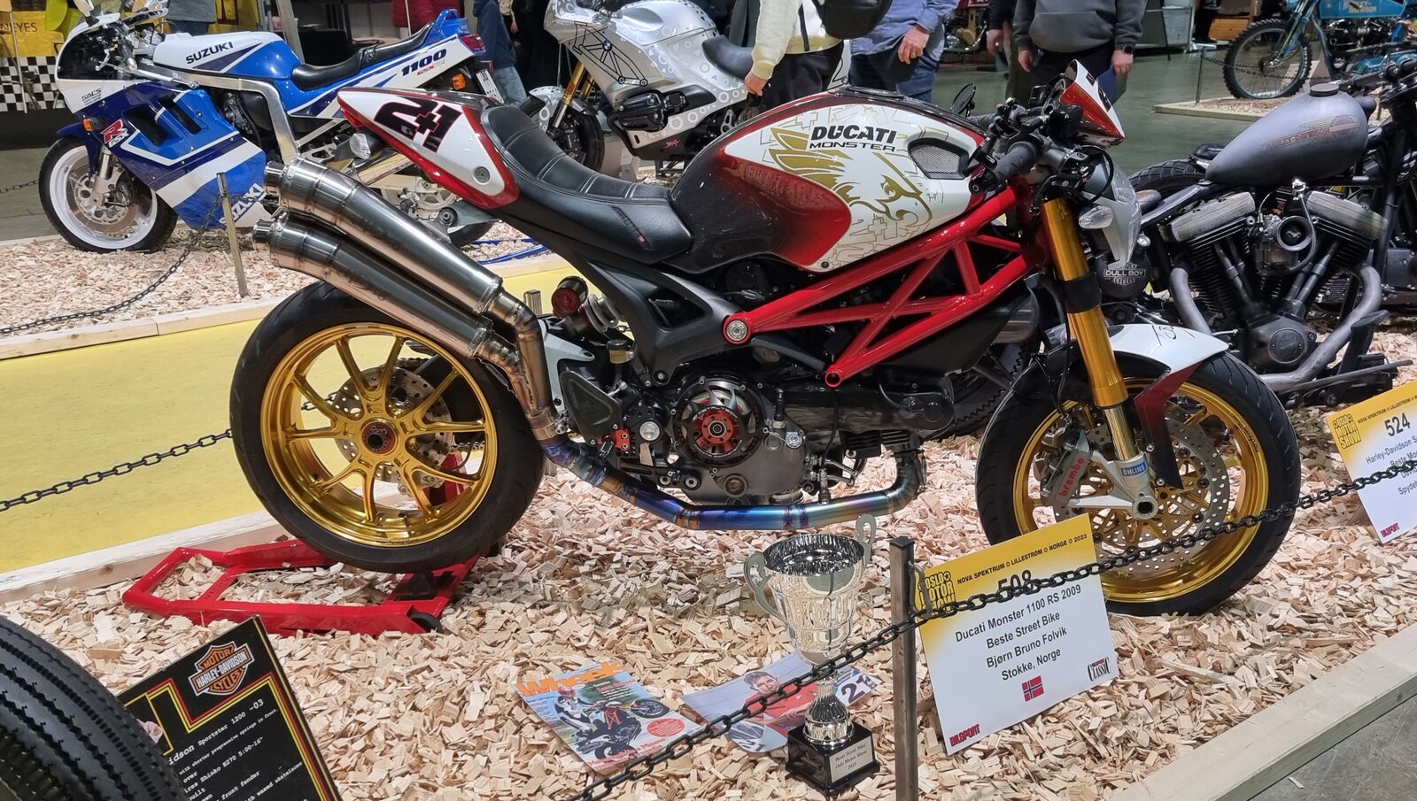

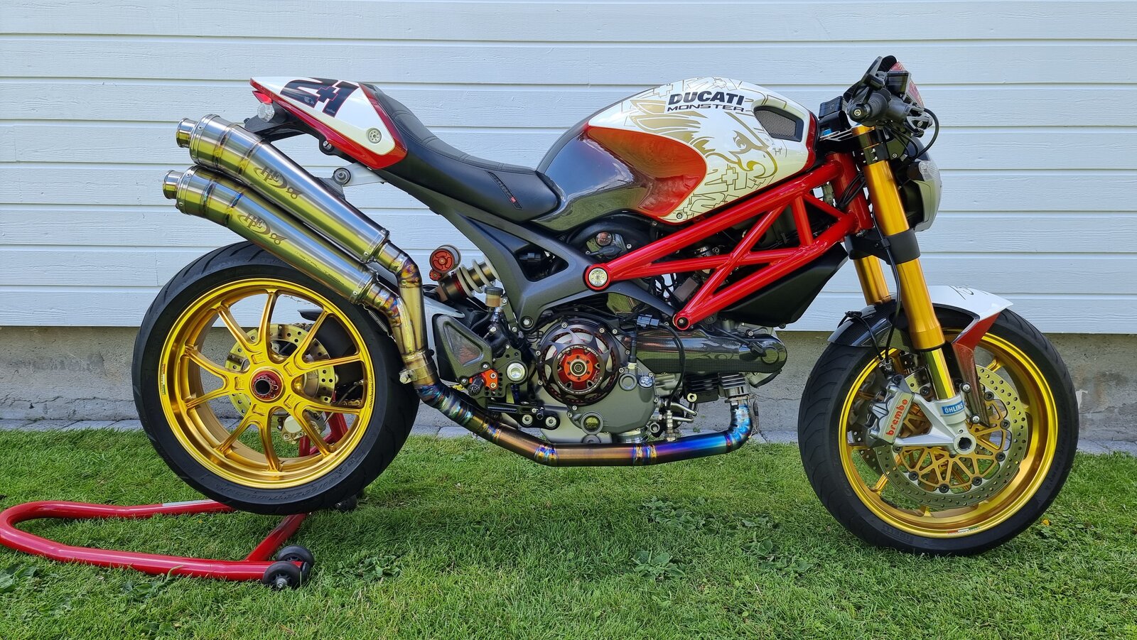

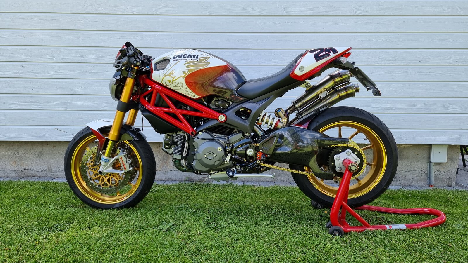

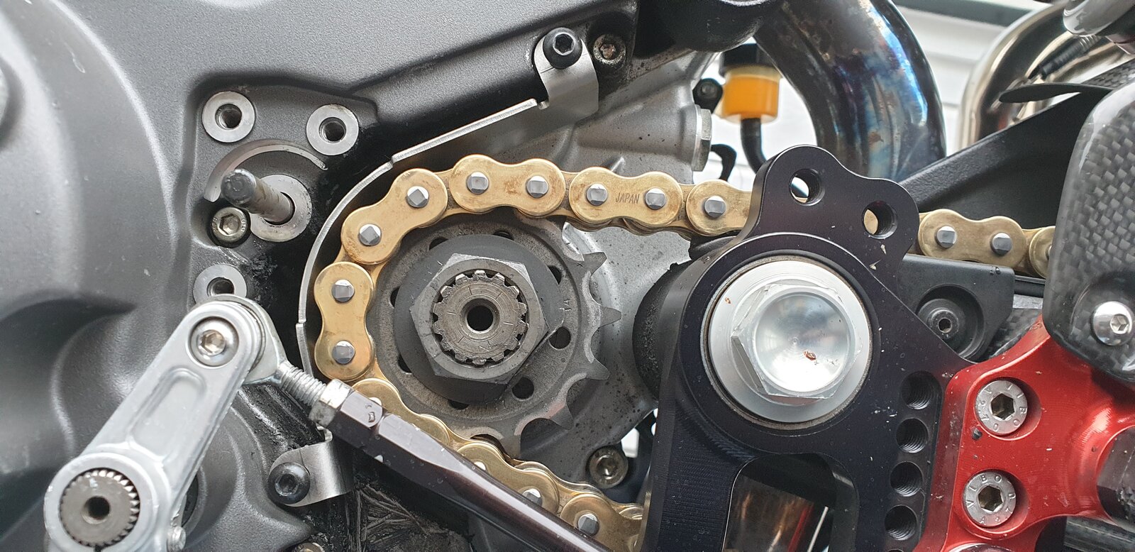

  18. Here are some new pictures of my Monster. Jan Kristiansen at mcimport.it has helped with most everything with this Ducati, everything from the import from Italy and parts. The latest is that he has had new exhaust manifolds welded up in Titan. They are made in Italy after original manifolds that were produced by HPE. The company chose to increase the diameter to 48 mm. I thought it turned out incredibly well. Sounds good too
    Was invited to take it to the Oslo Motor Show exhibition this autumn. There it was awarded as Best Street Bike
