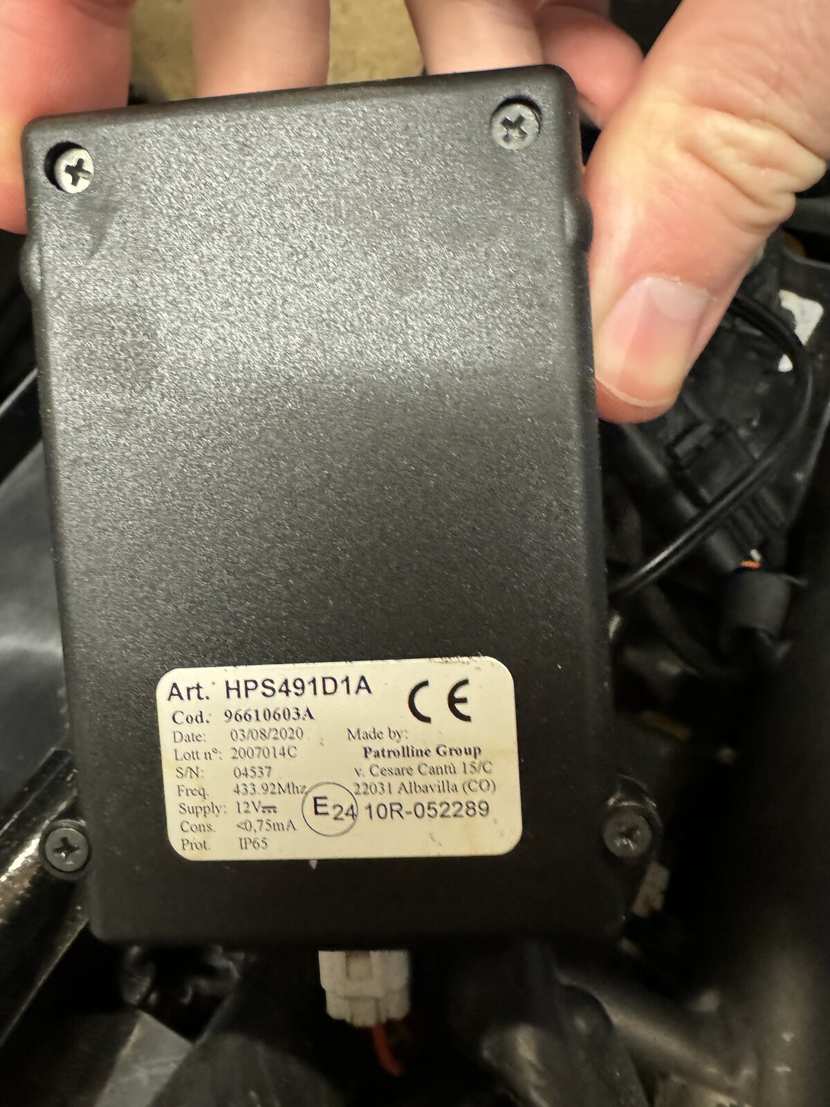

    A couple of weeks into ownership I have just discovered this box under the seat, which appears to be an alarm?
    Does anyone have one of these? I don’t have a fob, the alarm hasn’t sounded so I assume it doesn’t auto set, also starts fine so assume it’s not an immobiliser? Previous owner was oblivious too!
    I would be grateful for any info!
  2. My Italian is non existent but I believe it's a geolocator or tracker, not an alarm. Andy
  3. Googling the HPS491D1A part code throws up Ducati Anti-Theft system references
  4. If the box has a ‘speaker’ type grill on the other side, I retract my ‘not an alarm’. https://www.patrolline.it/ Andy
  5. Thanks guys, yeah it sure looks like a speaker grill!
  6. Bugger, wrong first time ...... again :joy: Andy
  7. It’s a Ducati factory(dealer?) fit alarm. You can get a replacement fob for it from your dealer and can programme the new fob to the alarm. Mind you it will cost a 3 figure sum - about £120. Best just ignore it.
  8. Thanks, yes you're probably right. Doesn't sound like it warrants that cost!
