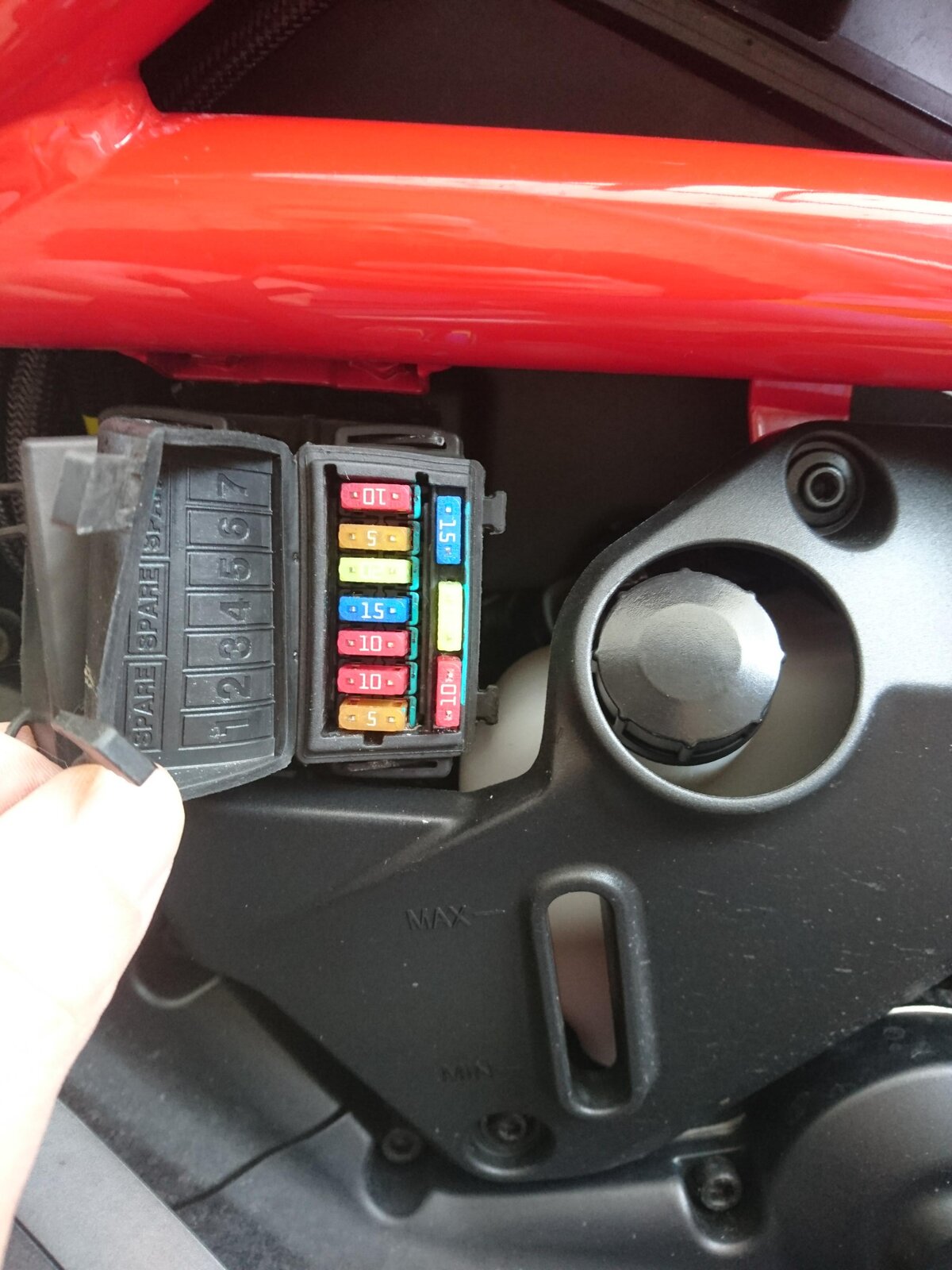

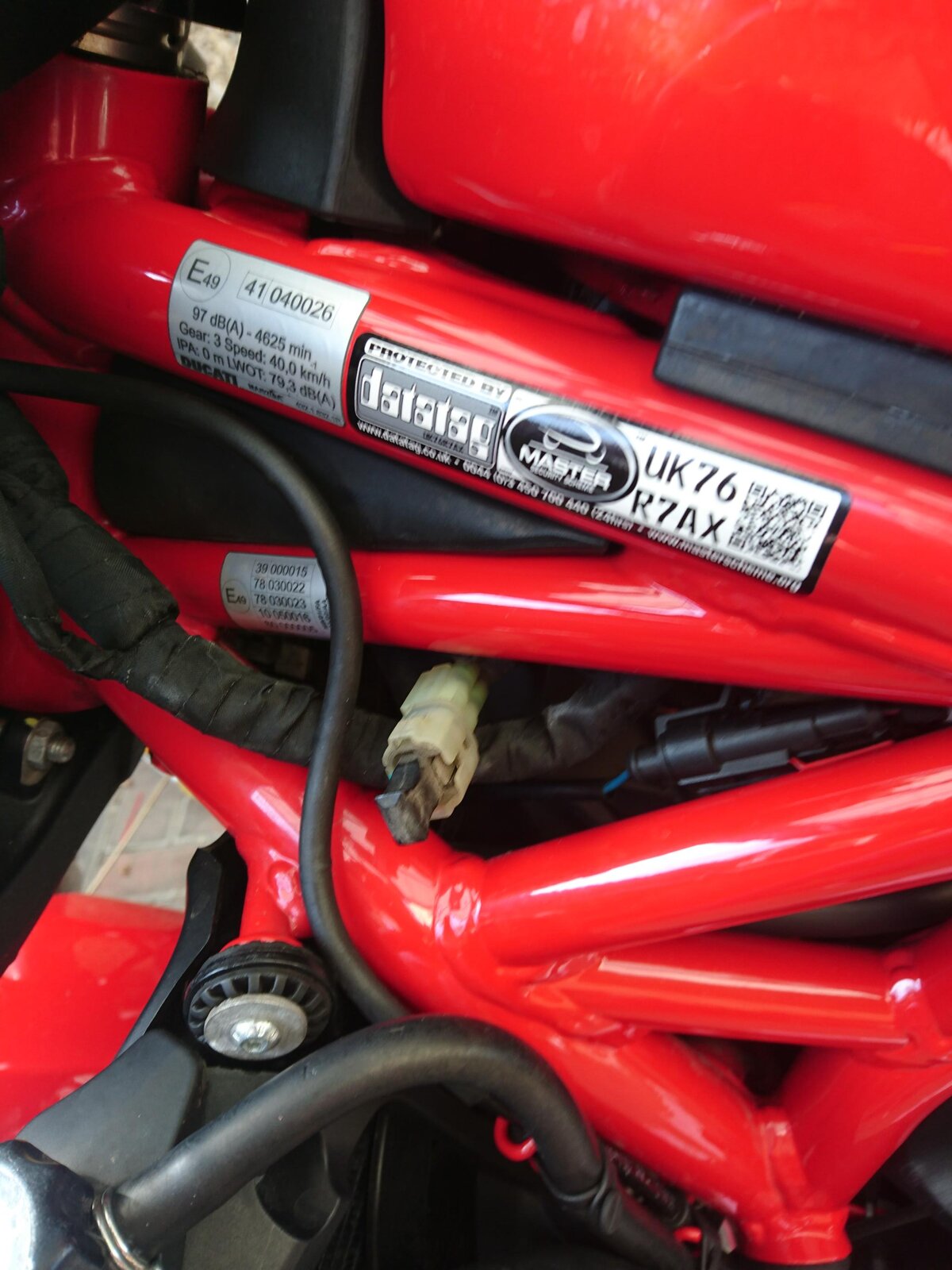

  5. I'm betting it's this one:
  6. The connector shown above is hidden behind the black cover, you need to pull that out of the way to reach the connector.

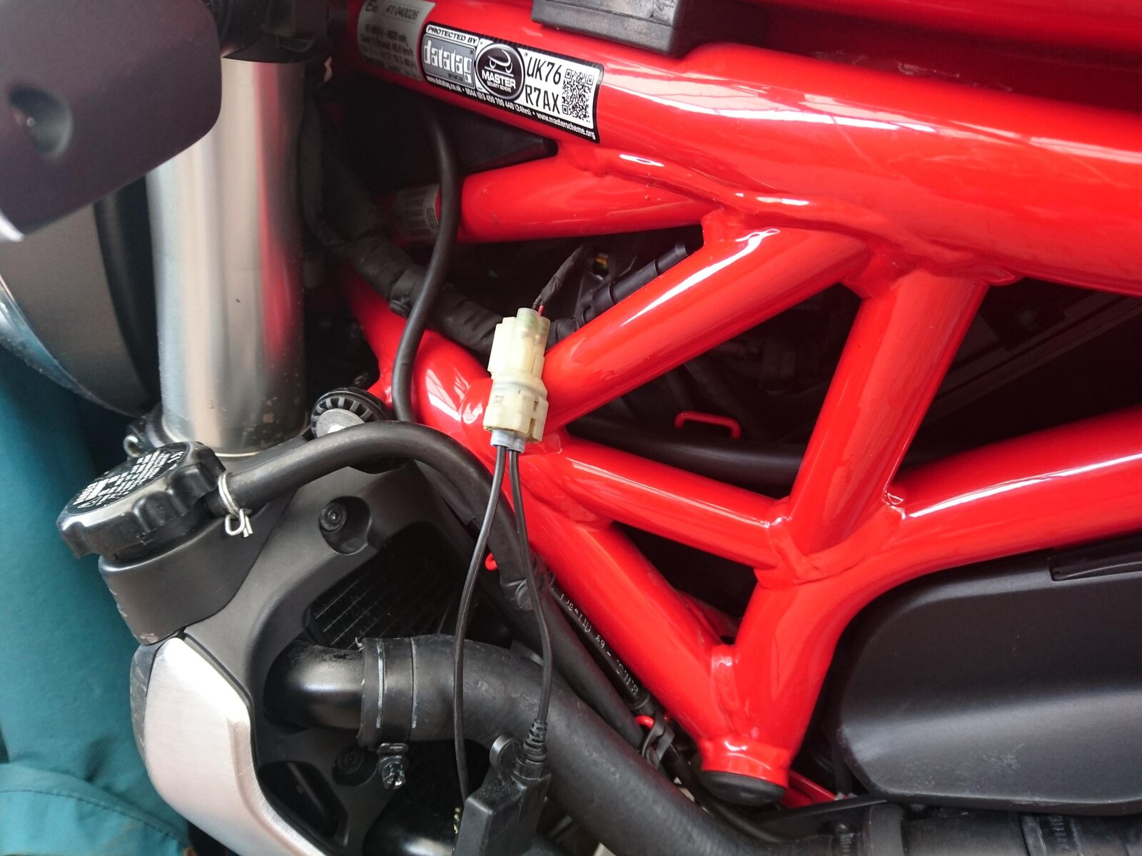

  7. This has sorted it:
    Would anyone happen to know which fuse this runs off? I can't seem to find it in the manual at all...
    Cheers.

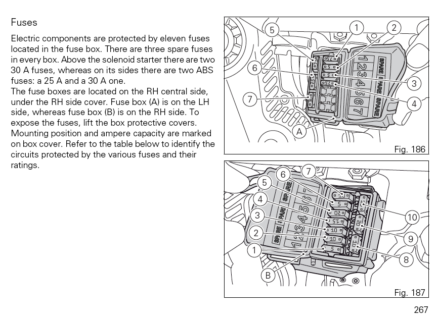

  8. It is fuse 1 in fusebox A, fig. 186 in the manual. The other fusebox from the one in your pic above.

  9. That connector is the ignition on powered one that I use for a USB port to plug phones and GPS into.
  10. That's what's thrown me, the current 'optional key' fuse is a 5A. Ideally my jacket requires a 7.5A draw. It does work on 5A I guess it would be best to leave it as 5A?
  11. Can't help you there, only have a manual to guide me. Fuse 1 in fusebox A (nearest the top) is shown as 7.5A and supplies only the heated grips connector and the optional Ducati alarm.
    I would check for power at the connector when the ignition is on then pull the fuse and see if the power is no longer there. If not, you have the right circuit and there should be no problem with increasing the fuse rating.
