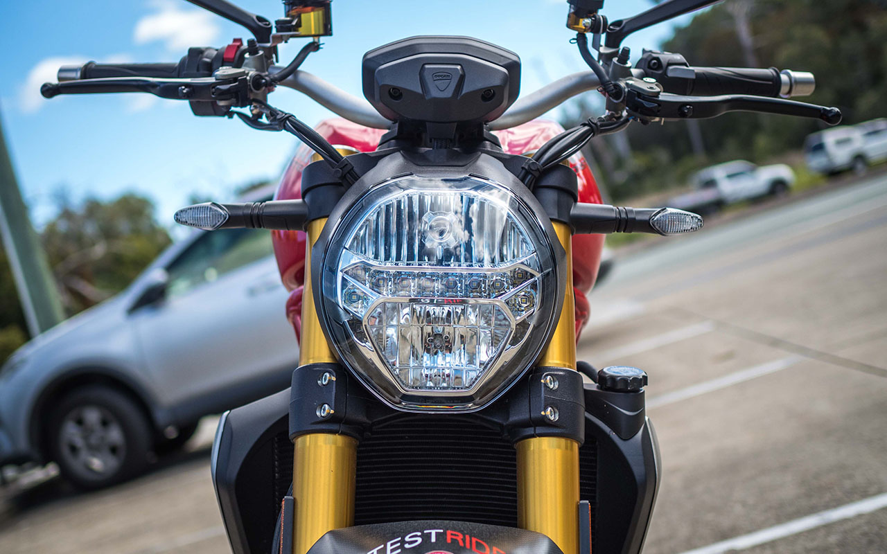

  2. I take it you know there are two versions of the performance indicators?
    For your bike it's the 96680231A front and 96680201A rear.

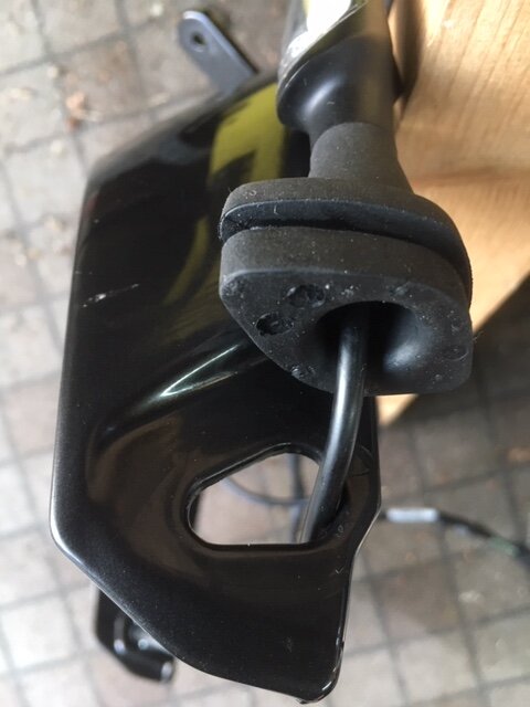

  3. @Peter Mackrell I have them on my standard 1200 monster , I`m sure the parts are the same. They were already on the bike when I bought so I cant help with what to do but I can take a few pictures and send them to you if that helps.

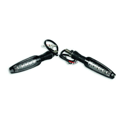

  4. 5497057E-1394-4481-8785-26FCEC3C33BE.jpeg Thanks that may be helpful, the ones I’m trying to fit are these as you can see they are miles too big for the headlamp surround.

    But I believe you need the 96680231A:
    New Monsters have the front indicators attached to the forks.. Your indicators will fit those, but they are wrong for your bike.

  7. Yea I can see the ones with the thread obviously must fit with blanking plates with holes in.
    My dealer has told me there are two types but do you know I like the new ones shape so I think I will adapt the surround to fit.
