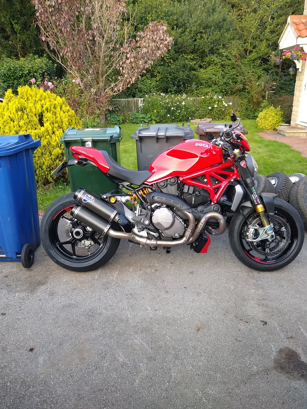

  1. I've just sold a 998r that I'd owned for 20 years. In about 2006 I rode a Ducati UK Monster S4rs and thought if I ever sold the 998r a Monster S4rs would be a good fun ride.
    But when the time came I decided that a newer monster was a better bet.
    After not being quick enough to bag a few bikes I set off in a van to buy what looked to be an immaculate 2018 M1200s about 200 miles away.
    The bike was indeed immaculate and had some nice extras on it, termi, evotech rad guards, tail tidy, dash faring, bar end mirrors and the standard parts had been retained. The deal was done and the bike was home last Friday evening. Been out a few times and the initial impressions are good. Very easy to ride, the wind blast is not too bad at all and the quick shifter up and down works well. The fly by wire throttle does feel a little different to an old school cable connection, but all the tech on the bike is very impressive after the very analogue 998.
    Looking forward to a good few miles in the sun over the next few days
    Picture including our full collection of wheelie bins
    • Like Like x 17
  2. Lovely example, congratulations and many happy miles
    is the quick shifter an extra that’s been added by the previous owner?

  5. The quick shifter up and down comes as standard on a 2017 and onwards 1200s. Pre 2017 model year 1200s doesn't have a quick shifter. .
    There is a small amount of throttle auto blip coming down the gears, only just noticeable at pootling about speeds.

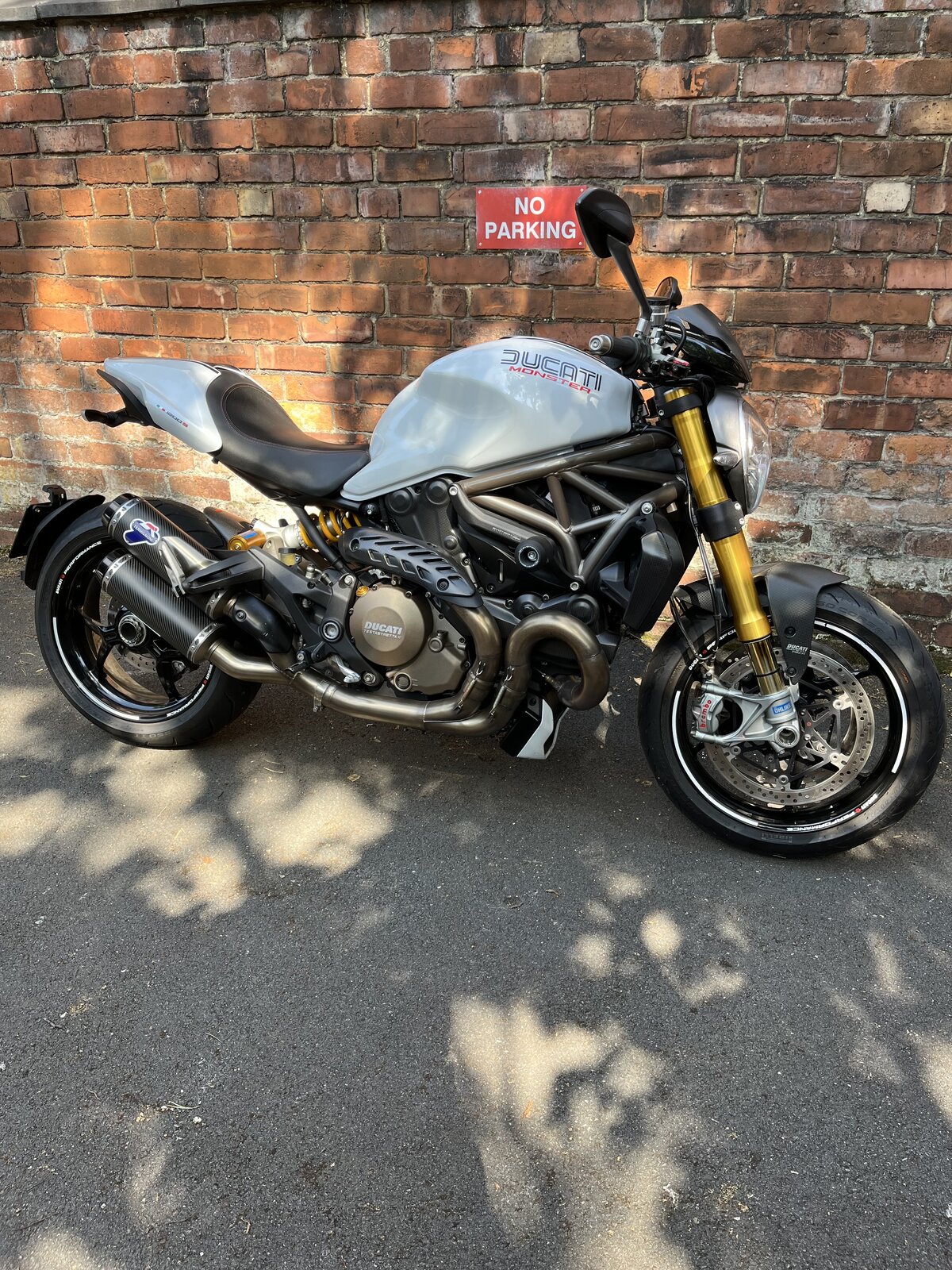

    My 2014 S doesn’t have either up or down, so I’m told, and I’ve never had the confidence to try it!
    Do like the idea of throttle spacers, tail tidy and bar end mirrors though.
  9. Nice colour, pearly white? the same as the S4rs I rode years ago.
    I think you are right, I thought I'd read somewhere that the 2014 to 2016 M1200s had a quickshifter but looking at pictures of the earlier bikes I can't see the quick shifter load sensor on the linkage.
    I've edited my post to correct that, there is enough misinformation on the internet with me adding to it!!
    On a non quick shifter equiped bike you can simply snap the throttle shut momentarily to do clutchless changes going up the gears. All a matter of timing that comes with a little practice.
    The mirrors on my bike are NCS, some sort of machined alloy, surprisingly good view, but there again I've had years of 998/996 mirrors that give a great view of your arms and elbows.
