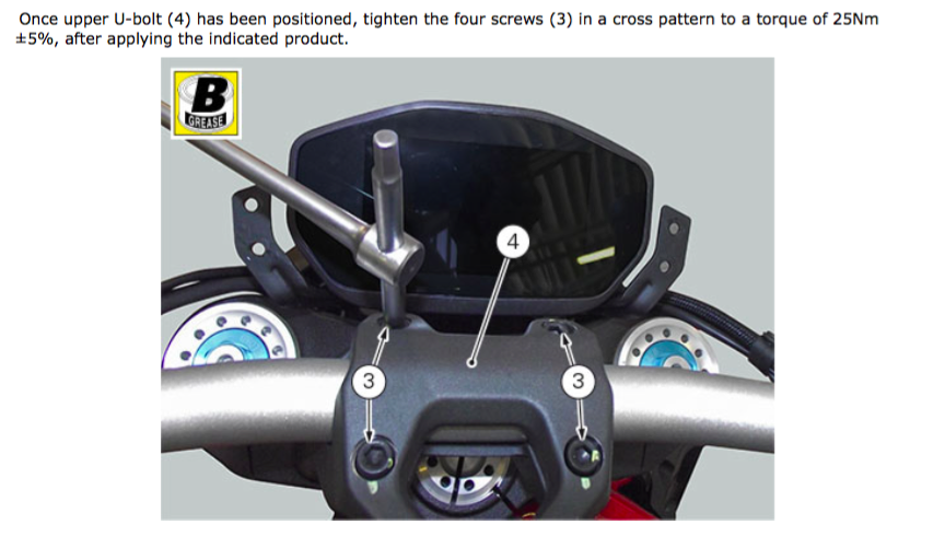

  1. Can anyone tell me the torque settings for the allen head bolts in the handlebar clamp on the 1200 monster?
    Or, has anyone found a list of torque settings or a workshop manual for the 1200 monster?
    Ta.
  2. Hey Wally - the following is from my 1200 R workshop manual. I would assume the torque is the same, but I can't confirm that..
  3. Hey 2bm, thanks very much for that. It looks like the same setup.
    Where did you get your workshop manual?
  4. Excellent, thanks for the link. I downloaded the 1200S manual, because I have the Stripe, and torque settings are the same but the handlebar clamp on the S looks different from the R, I guess because of the steering damper on the R, and tightening sequence is described as 1-2-3-4-3 (numbering from top left to bottom right). Go figure.
