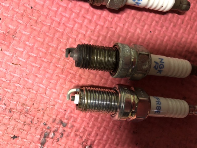

  1. 03CE56BF-78A0-46C4-AD79-717EE453B67F.jpeg Hi, hoping for some expertise here. My girlfriend has a 2007 monster 695 with the 5am Ecu. A year or so back, we were experiencing what seems like quite a common problem with these closed loop monsters. It manifested as lean pockets of the map leading to really severe intake backfires. We took it to a local Ducati guru who after a lot of investigation handed it back and said ‘fixed!!’. They explained that they’d put an updated ECU map on the bike which it had presumably missed out on because it was never serviced at a dealer. I’ve recently obtained TuneECU and can now see that it has a map called 2235PI01. It’s available on the TuneECU site. When I compare this with the Ducati performance map (2235SI01) I can’t see a a single parameter which is different so I can only assume that the two are identical, maybe the P map is just a copy of the S map or something?? Anyhow, the problem is that the DP map is aimed at bikes with a more free flowing exhaust and intake. In the absence of these mods it seems to be running quite rich. It has cured the popping issue however I’ve looked through the plug holes and can see a shiny halo around the piston which I’m suspecting could be due to excessive fuel. The plugs are coming out quite black too. Pic for ref showing virtually new plugs versus hers. My concern is that if we’re getting piston wash, that we could be doing substantial damage to the engine over time. Does this sound likely? If so, something needs to be done, but I don’t know what! One question I did have was whether the Ducati performance map can be used with the O2 sensor switched ON. Currently it’s off. My hypothesis is that with the o2 sensor on, the ECU will try to correct/trim the fuelling by leaning out the mixture a bit. Probably still better than the stock map. Is that an acceptable thing to do? Can anyone see problems with this approach?
    alternatively I could review the stock versus DP map, identify all the changes parameters and half the difference to try and lean it up. This worries me though. I’m not totally dim but if I mess up her bike, I’ll be for it!
    thanks
  2. From the photo, it doesn't look terrible, to me. What sort of fuel economy are you getting?
