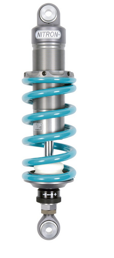

    I have ordered a Nitron R1 shock in black for the rear, on the basis that it has to be some kind of improvement as it has compression and rebound adjustment - which the OE shock does not. And the Nitron unit will be made specific to my weight.
    Figured that must be worth the upgrade and should be straightforward to fit.

  2. If you can change the rear shock a fork internals change IMO is no more complicated, talk to Nitron they may have an internals kit for your Monster. I service my own forks on my trials bike it’s pretty straightforward and IMO far easier than changing out a rear shock.

  6. Thank you for your comments.
    "talk to Nitron" - good idea.
    I watched a YouTube vid, not for the Monster particularly but rather for Nitron Cartridge set to be installed - I think it was on a Honda. Unfortunately the Monster 821 does not have the suspension options from new that the 1200 has.
    Noted about setting the sag correctly first.
    You are right about the rebound adjustment, although not so obvious as a big twisty knob on the side - forgive the non technical term. Preload, I get that - compress the spring with use of a big special spanner.
    The front forks - the cartridge kit from Nitron is not so expensive - a few hundred £££ pounds not such a big issue. I just have to be sure that whoever installs it and sets it up knows what they are doing.
    I would not be that familiar with what you describe to set the bike up properly. Maybe practice on a old dirt bike but not about to start that learning process on my lovely new Ducati. But useful information for someone who has had a bit more experience than me !
    I looked at them as well, but will probably go with Nitron front and back. Either one has to be better to have the adjustable rather than the stock non-adjustable that we both have now.
  7. I'm have a Nitron shock on my R1200S (bought with it already fitted) and I can't fault it. Will now look at fork internals from them to compare to Andreani cost.

  11. Sorry - I was all set to spend some money on upgrading the Monster 821 - Dymag wheels and Nitron Shock. Dymag did not have the measurements to make the wheels straight off, so they would need to take the measurements from my bike to make a set of wheels. So that was off. Cancelled the order for the Nitron shock and traded the Monster in for a new Suzuki GSX-S1000 with adjustable suspension as standard.
