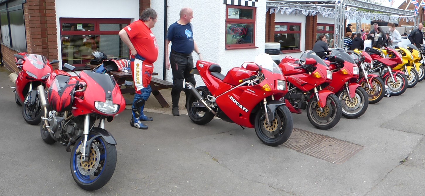

  7. just had a look and found this pic not the best but mine is the one with the blue front wheel on the left

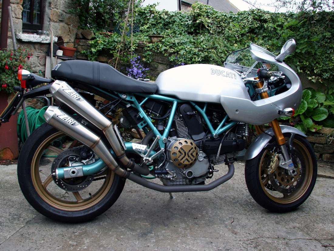

    Later Monster guard on my old PS SC using same mounts as SSie forks
