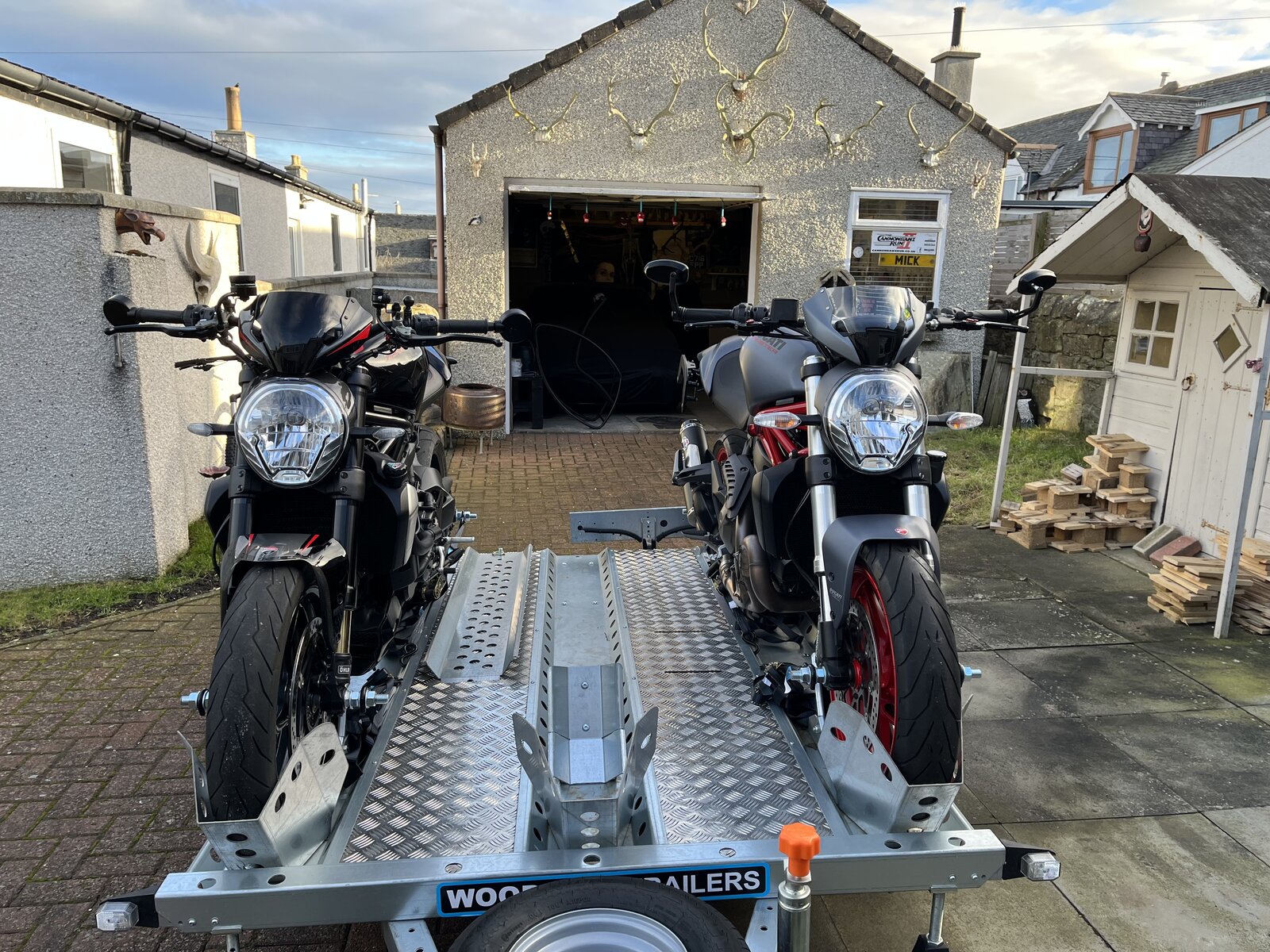

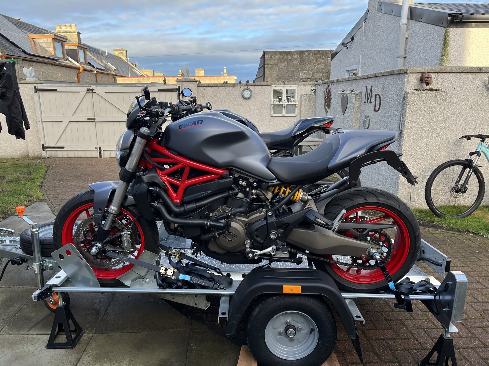

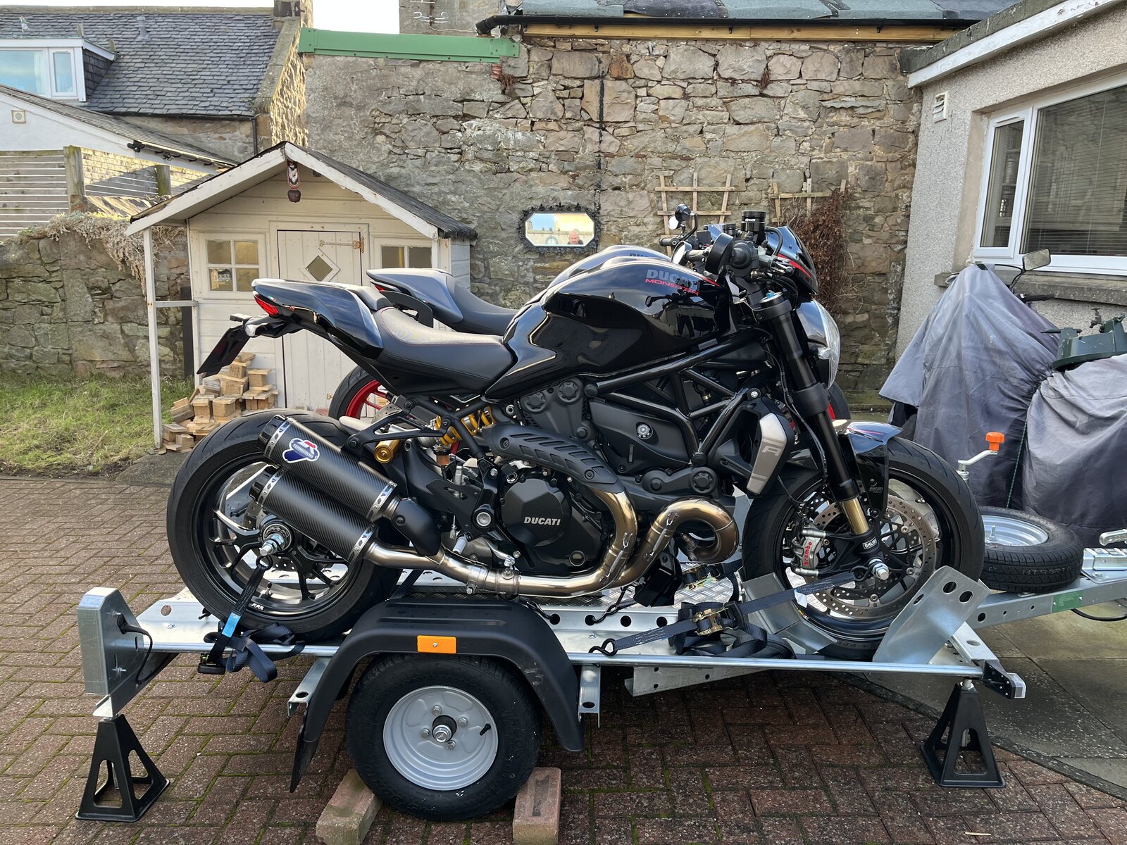

  1. Bought this Woodford 3 bike trailer to take the bikes with us when we go away with our motorhome. Had a trial fit of the bikes today. IMG_2472[1].JPG IMG_2473[1].JPG IMG_2475[1].JPG

  5. I have a small concern with your tie downs. Both are pulling the bike away from the front chock whereas IME, you need to pull the bike into the front wheel chock. What I learnt from the driver who transports out track bikes to Spain is to strap the bike from around the foot rest area. My V4 rear sets are ideal, on the Diavel, I thread the tie down through the trellis and on the Scrambler, I use the rear pillion foot rest hanger. Put some body weight on the foot rest when you pull the tie down up and the bike sits square. Andy
