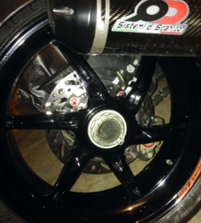

  5. new fluid will help for a while, but isn't a lasting cure. I used RBF600 fluid which lasted the longest, but the rear brake would still become inefective after a long day in hot temps and lots of use.
    The only way to get a sensible back brake that keeps its minimal travel and works ok is to remove the cat (gets rid of the major heat source that seems to do the most to pedal travel), and potentially fit HH pads.
    I contacted brembo regarding pads and their view was that the standard rear pads are as good as any.
    They did however suggest a change of disc, so I have fitted a Brembo Serie Oro (Gold series). This is noticably better, to the point where I can use just the back brake for normal riding and slowing for junctions.
    I have also fitted the heat shield now, but its early days so can't really comment if its helped any, given that the pedal stays firm anyway now without the cat.
    Hope that helps.

  7. I did all of that too TT, but the only lasting improvement for keeping the pedal for significantly longer was removing the cat, and change of disc to get better performance.
    Prior to cat removal I could get a long pedal easily within a days riding when used a fair bit whilst two up and pushing on. Three days into a trip and the brake would be useless. I will find out for sure over the May bank holiday if this is fully cured now. Fingers crossed ! :)
