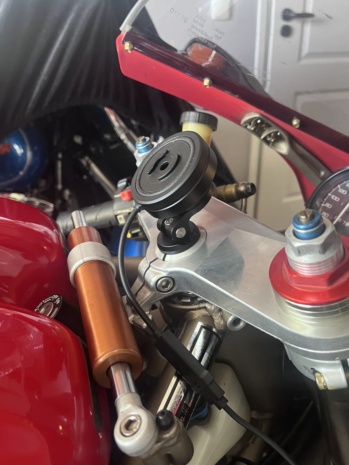

    For those who are still interested, a little push to this thread. I just recently figured how to use this standard equipment of SPconnect.

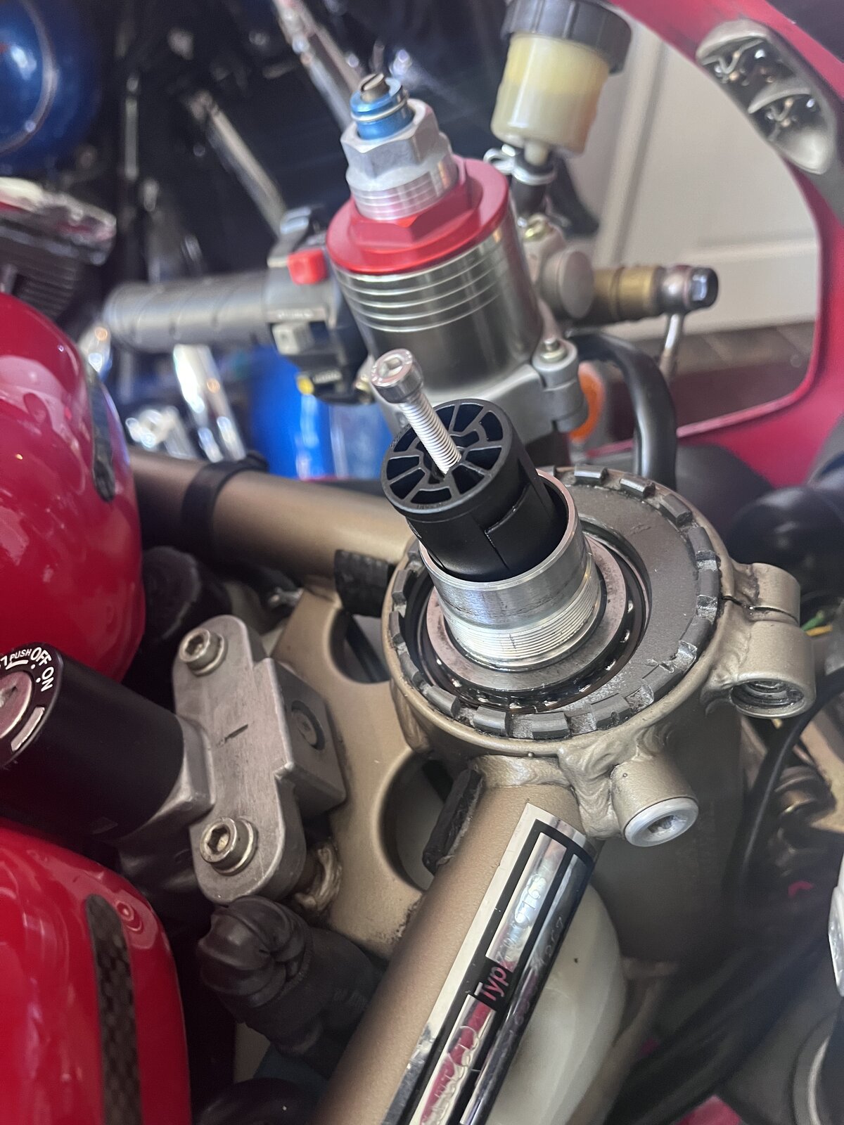

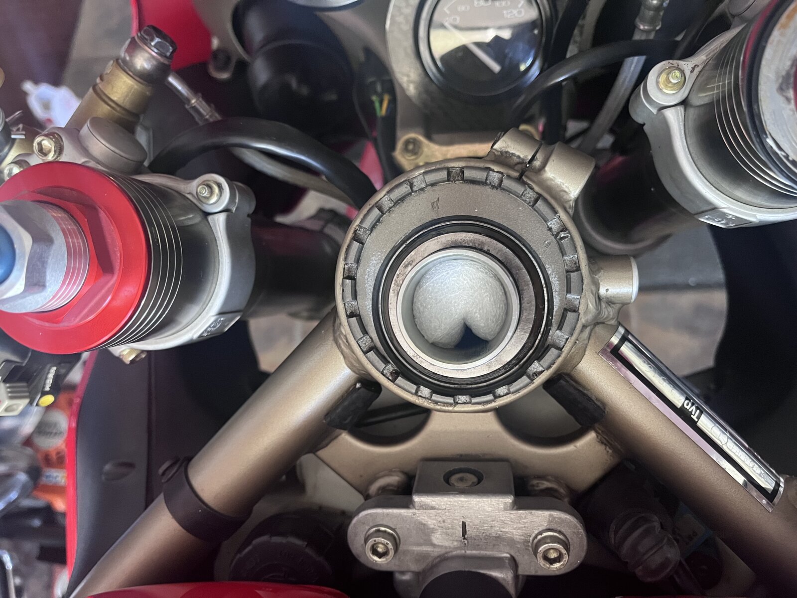

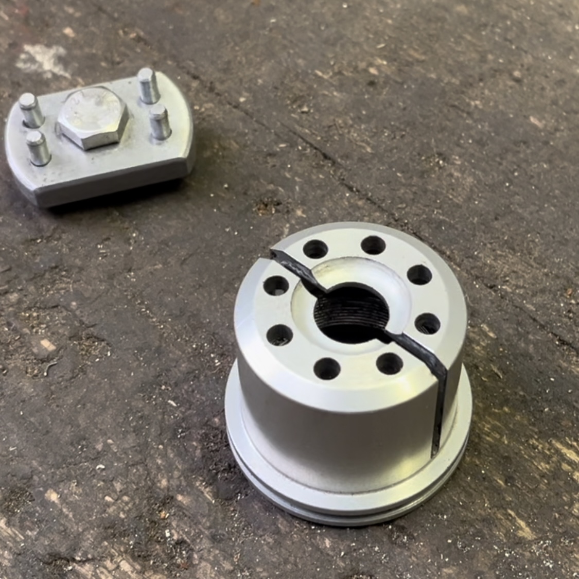

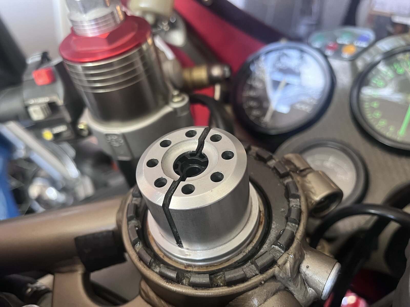

    Thinking of how this would work for my Ducati I measured the inner diameter of my steering tube. I first found myself a second hand steering stem nut to make a hole in. Not to take any risk with the original :)
    Inserted a little peace of foam to prevent the plastic clamp falling too deep… leaving a gap for any water to drain.
    torque and adjust the steering nut
    For me, it sits in place nicely. The wiring and 12V to 5V inverter I totally replaced, soldered and insulated with braided sleeve towards the fuse box.
    There I used one of the spare fuse-sockets and wired it onto the ones switched via the ignition switch…
    I hope anyone find this useful.
    Enjoy the evening, cheers
