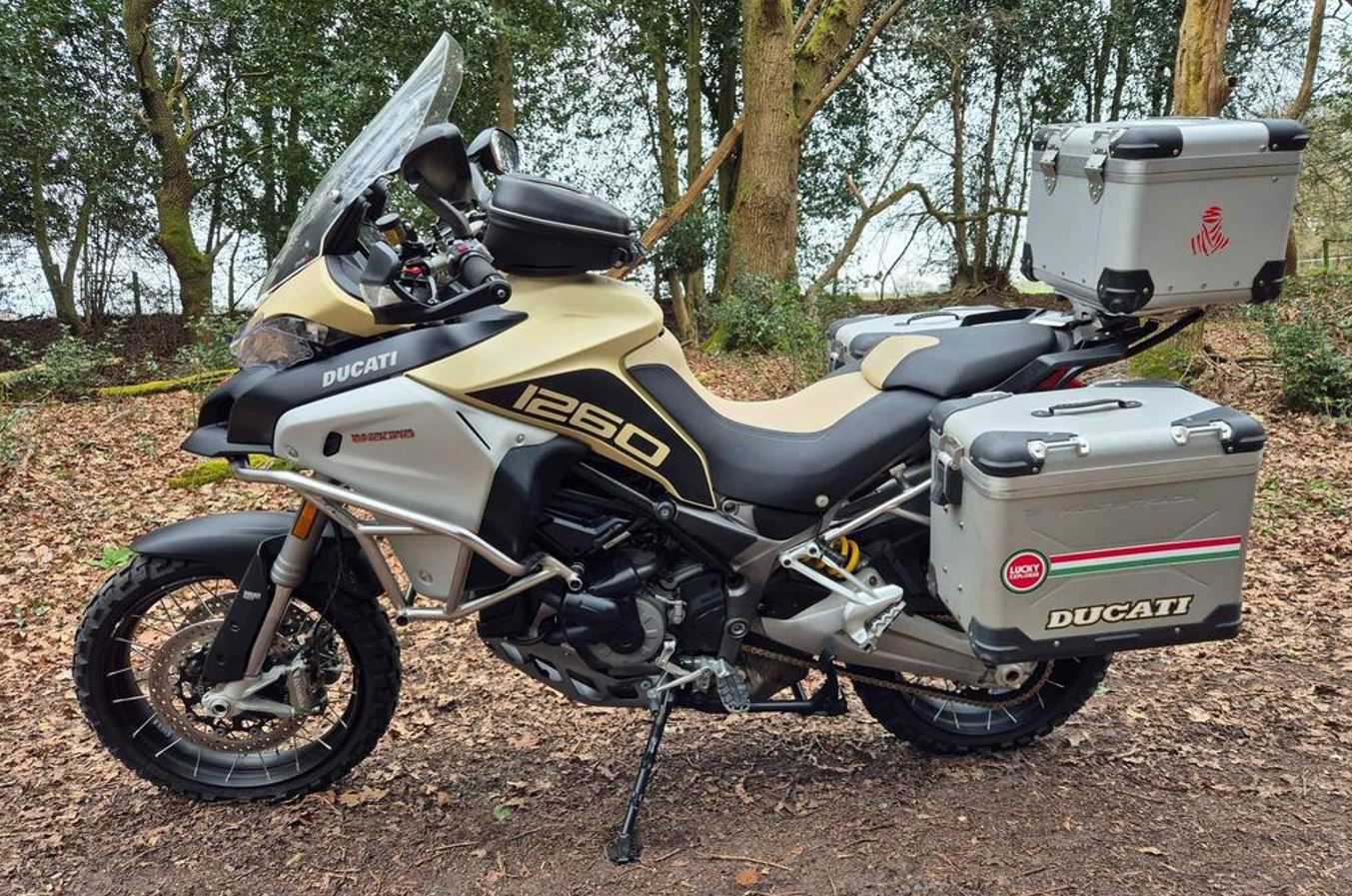

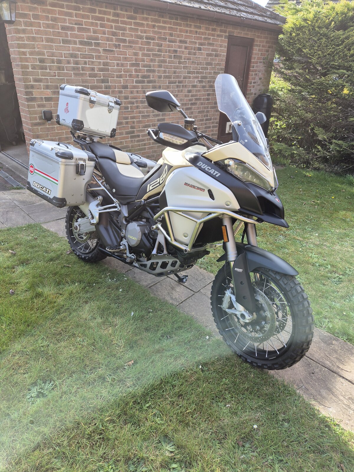

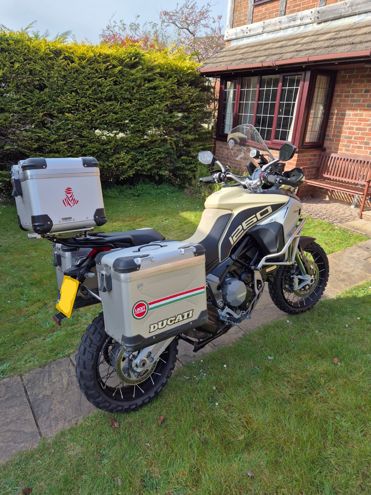

Normally at this point I’d be introducing you to a Bike that came home with me in a van, either in bits, bent, with known faults, or simply a non-starter, but this time it’s different, I purchased a bike that’s not only in good condition, but appears to run and ride well. It’s the right colour, has some nice accessories, the Belts and Desmo service were done a few months ago by Snells, and it was a good price. In fact I could just leave it exactly as it is and use it, but you know I’m not going to do that. Flicking through the owner’s manual really brings home how much the on bike tech has moved on. It’s 14yrs younger than my next youngest bike, my 999, so as you can imagine it’s all a bit mind boggling. She’s home: But due to family commitments today all I’ve done is tuck it up nicely in the garage. The rest of the images in this thread are from the last owners advert.

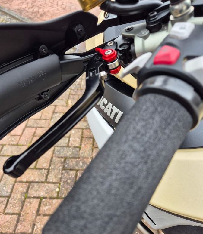

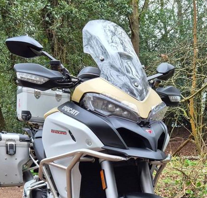

The PUIG screen and Headlight protectors are nice, the feeling of sitting in a pocket of still air behind the screen at, Cough, 70mph on the way home was a revelation to me, being more used to having my head buffeted around and straining my neck muscles. But the standard screen came with her, so I might try it. The PUIG screen is a few inches longer than the standard one and sat on the bike my eyeline is just above the screen, so the top of it is a bit distracting and in just the wrong place for a clear view forward, but I’ll see. Apparently there are Evotech radiator and Oil cooler guards fitted, so I’ll have to get a better look at them. I’m not sure about the Evotech levers: I’ve never liked short levers so might try to get hold of some standard ones.

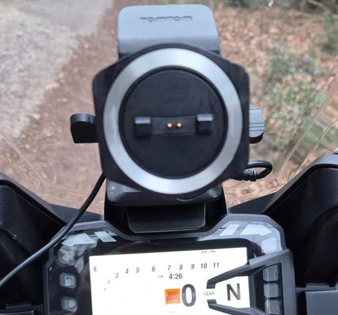

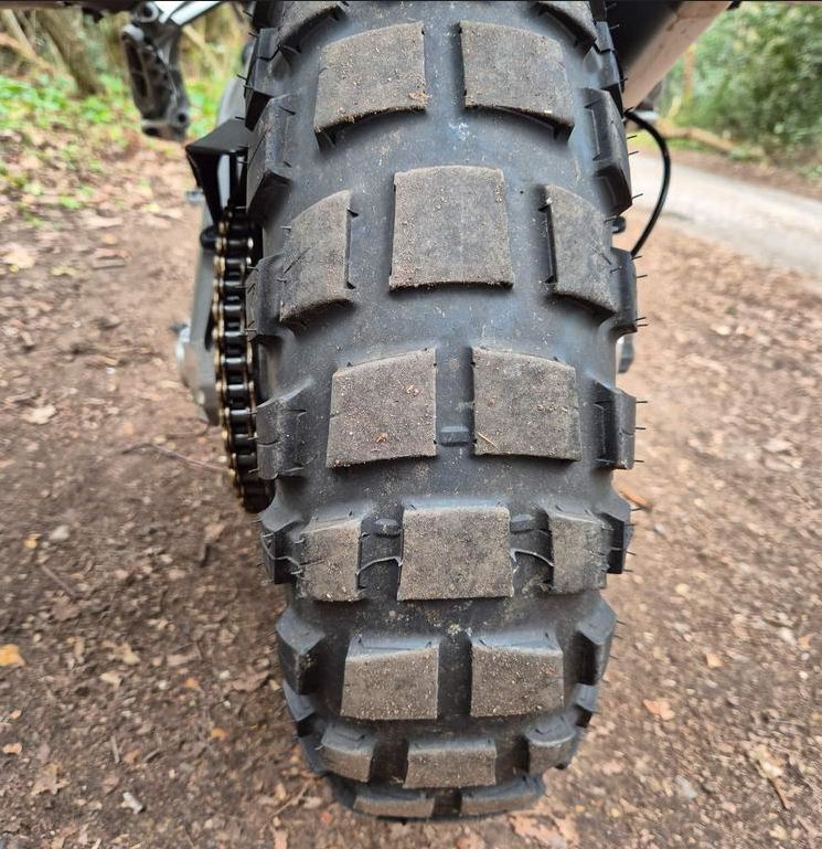

There’s a Satnav bracket fitted and a TomTom Rider42 was supplied with it, so I’ll have to give that a go: That side of things is where I’m going to need some help and advice. I’d like to fit my helmet out with the gear to be able to hear the SatNav instructions, and possibly listen to music, but I’ll investigate a bit first as I don’t know where to start. I needed it upright to save space and having not had a bike with a centre stand for 40yrs I struggled a bit to use the one on this bike, but I suppose it is a bit of a lump. There are threaded holes for paddock stand bobbins, so I’m going to try that instead. And talking of paddock stands, my favourite style of under headstock ones won’t fit this bike to lift the front wheel, so I’ll have to go with the type I don’t like under the bottom of the forks to get the front wheel out. Question – Front paddock stand and Rear Paddock stand, or Front paddock stand and fitted centre stand? I’d rather the former, but the later might be more stable. The first thing I need to do is get the wheels out to get the tyres changed, so I’ll need to make my mind up quickly. Oh yes, the tyres. The Michelin Anakee Wilds fitted handle better than I’d expected but vibrate and are noisy. Yes they look great: But they are being replaced with a pair of Continental Trail Attack 3s which I hope to get done on Friday.
And now for the things I don’t like: The Lucky Explorer stripes and Ducati Logos on the panniers will I think have to come off. The tank bag is useful being a Ducati specific GIVI one on a filler cap ring. And of course you can plug it in to the power socket below the dash to charge a phone etc, but it looks like an afterthought, a ball balanced on the tank. I might see what I can find that’s smaller and lower in profile that I can possibly modify to accept the GIVI clamp and power connection. Also, despite specifically wanting the Sand coloured version of this bike I don’t like the body coloured panel in the seat. I’ve already sourced a fully Black riders saddle from a Red bike and now need a Pillion pad to go with it. Can anyone confirm if the Enduro Pillion pad is unique, or is it the same as the other 1260 Multistradas? I think that’s enough for now.
