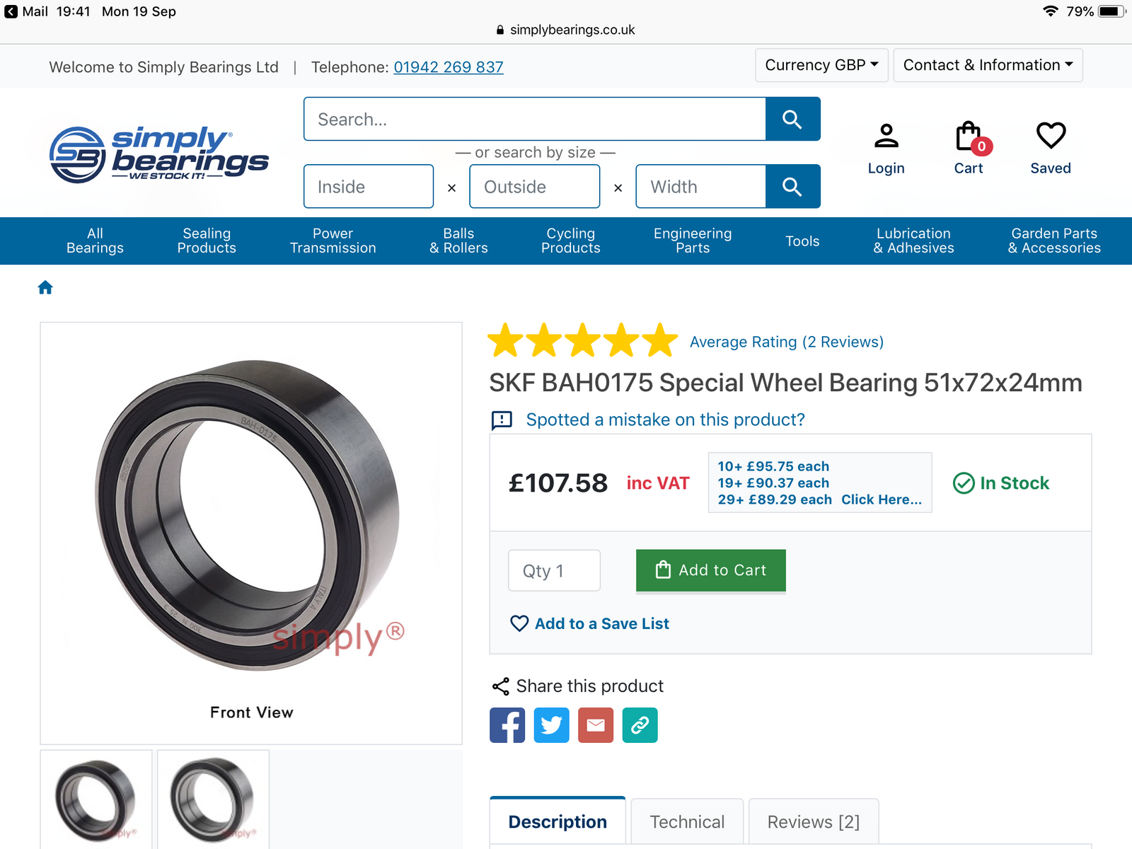

  1. I have been asked if I can replace the rear hub bearings in a 1200MTS that's failed its MOT for 'Play in rear wheel bearings'. I haven't seen the bike yet so it may turn out to be something else. Now I know that some on here have replaced the eccentric hub bearings and if I'm going to take this on it will make my job easier (and quicker) if I can have the bearings beforehand ready to fit. Can anyone tell me the numbers and spec for the hub bearings?
  2. upload_2023-5-2_13-51-24.png This is the bearing. It is on a thread here somewhere. I took it down for future reference.

  3. I can't find a 58 x 72 x 4 seal any where. Plenty at 7,8 and 10mm but nothing at 4mm.
    I guess that there are 3 seals altogether including the 93010102A Ducati one.
  4. To my knowledge, there is only 1 oil seal, a BFOB that is easier to buy from Craig at MR. Andy
