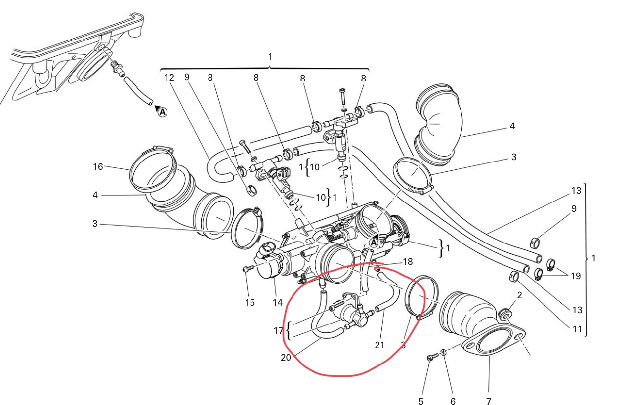

  1. When I start the engine at my old MTS idle rice up to a constant 3000rpm, I can’t find why?
    Anyone have clue what on earth make this happen?
    Al wires is ok and correctly adjusted!
  2. Idle control valve (stepper motor) stuck open?
    If you are lucky, then flushing it through with carb cleaner may un-gum it

  6. Chris. I'm really sorry, I think that's a Fuel Pressure regulator you've identified.
    And the item #14 is the TPS.
    I don't think there is an idle control valve in the system

  7. It’s the Idle Control Valve connected to the throttle body inlets. How would it control fuel pressure when the fuel circuit is shown at 1.
