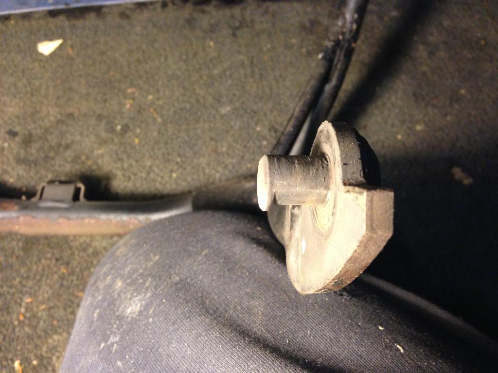

    I removed my stand yesterday, and was surprised to see the left hand side pivot bolt is significantly worn (maybe 3 or 4mm). That's fine, because the bolt can be considered sacrificial, and easily changed.

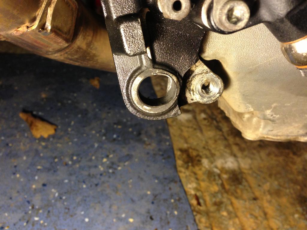

    On the right hand side the pivot bolt is fine, but the frame is worn instead :eek:

  4. hopefully attached are some pics:
    This is the left hand side pivot bolt showing its wear
    This is the rhs pivot point, part of the frame !

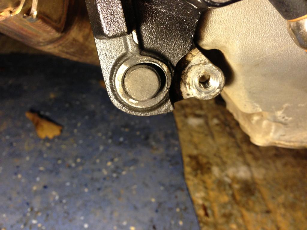

  5. Same pivot point with the pivot bolt inserted from ther wrong side, to show the wear.

    Having one of them use an alloy frame component as its mating bearing surface without any insert (bush or bearing) is not.
    I would also expect these to be an item on the service list so that they are greased (or at least inspected and lubricated) at each service.
    I believe this is a design fault, because it is crazy to have a major section of the frame that becomes sacrificial in this manner.

    Shimming is not necessary imo. that would remove lateral movement, and this wear is caused by rotation.
    The right hand side is where the spring is, so this frame member is also under pressure all the time.
    There is insufficient 'meat' to allow anything but a small roller cage, or something like a phosphor bronze bush.
