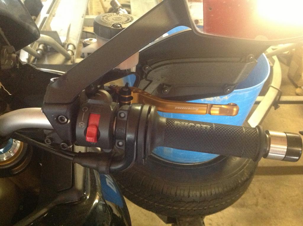

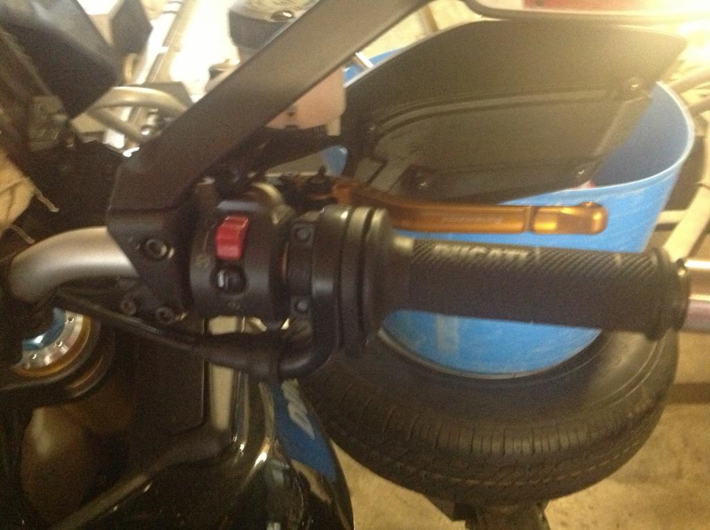

  7. The starter button is covered by the red kill switch, if Andy is getting the fuel pump sound he'll have depressed the kill switch to start the ignition. Sorry if I'm pointing out the obvious, but Ducati have changed certain bikes starting procedures.
    see below.
  8. I was of course joking. We've all been there though. I was once 20 minutes late for work because I forgot the bloody kill switch :D
