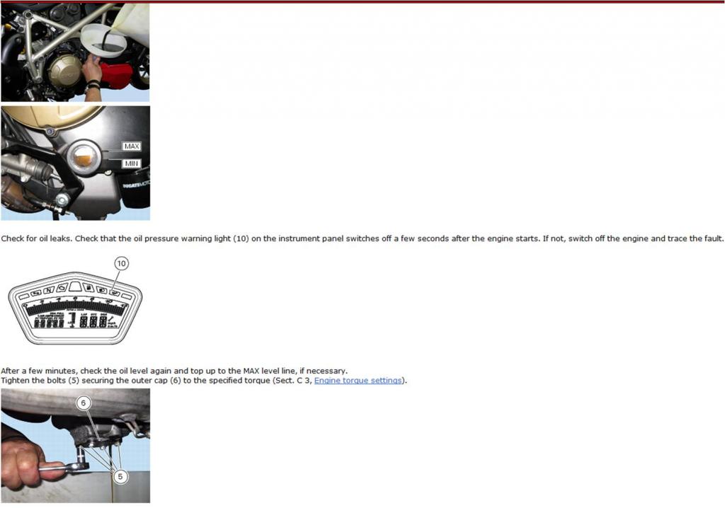

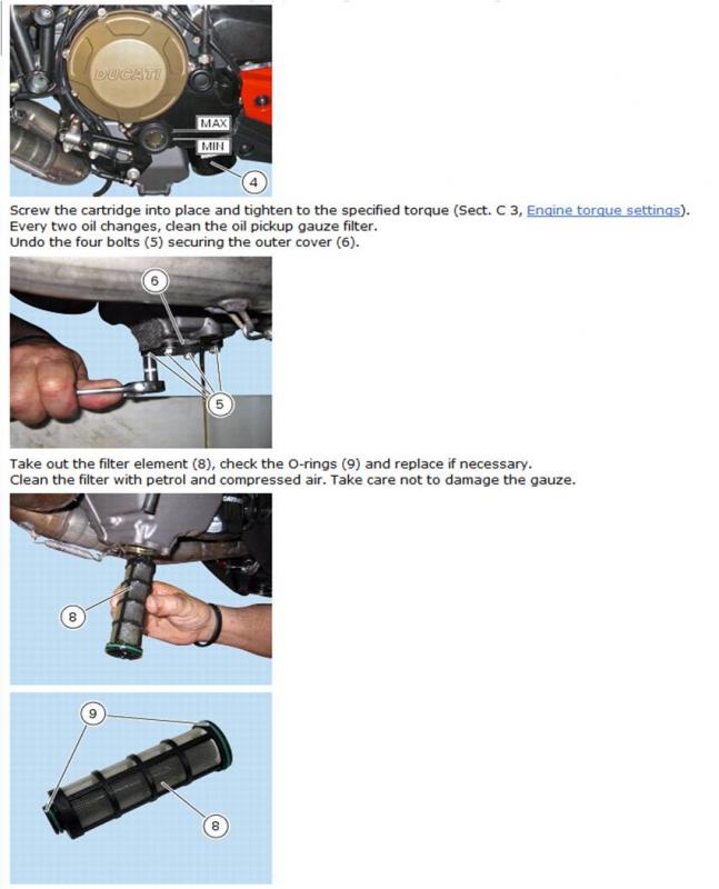

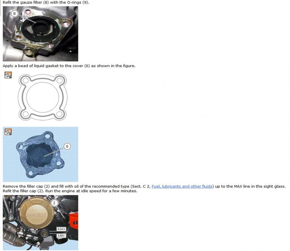

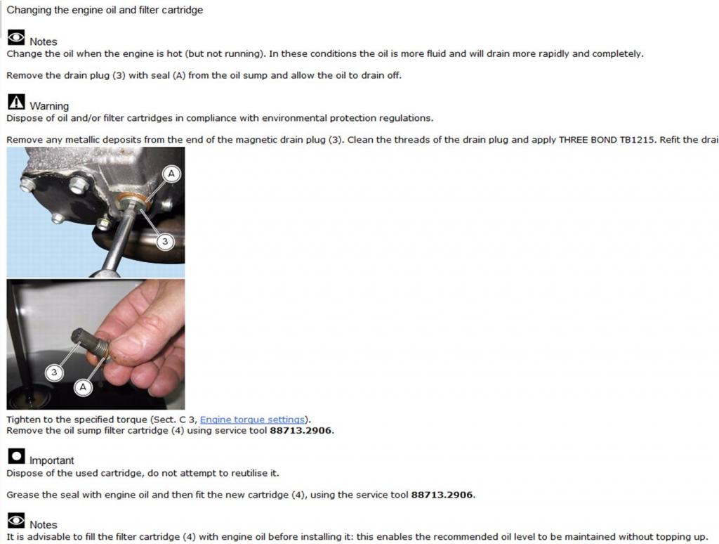

  1. Hey guys, gonna do a quick oil change on my streetfighter tomorrow and looks pretty straight forward tbh. I know my old KTM had two separate oil screens to be cleaned as well as a dry sump and sight tube so the first oil change was a bit of a learning process. Not hard mind, just different. The duke has a wet sump and oil sight window so guessing its as straight forward as it looks? Anything to watch out for while i'm in there? Also is there a service manual available to download? Thanks again guys
  2. Excellent stuff Robarano, cheers mate!
  3. Oil change completed...easy peasy...
