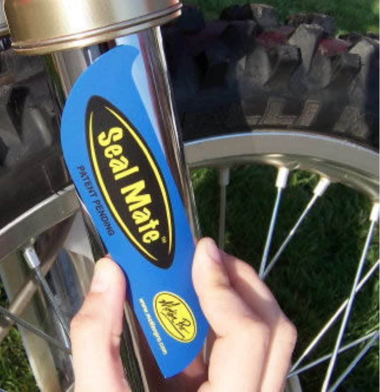

  8. Are you sure it's blown?
    .... you can get grit trapped up there
    Try using a tool like this or old film negatives cut to shape to try an ease out the dirt...
    Worth a try... used it on mine loads of times.
    Amazon about £7
  9. Hi Aircon
    I ordered one of those sealmates last week and it arrived yesterday.
    Actually i think it might have done the trick, i will have a better idea this evening when i get home from work. I will have done a 60 mile round trip by then, which should be a good test.
    If so i will cancel the JHP booking.

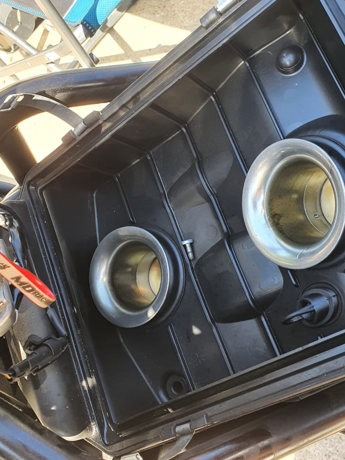

  11. @Expat Jack found this when I lifted the tank......
    So I agree, speak as you find.
  12. Try getting them to 'fess up to that if it got into the chamber. Well you'd probably never be able to recognise anything in fact.

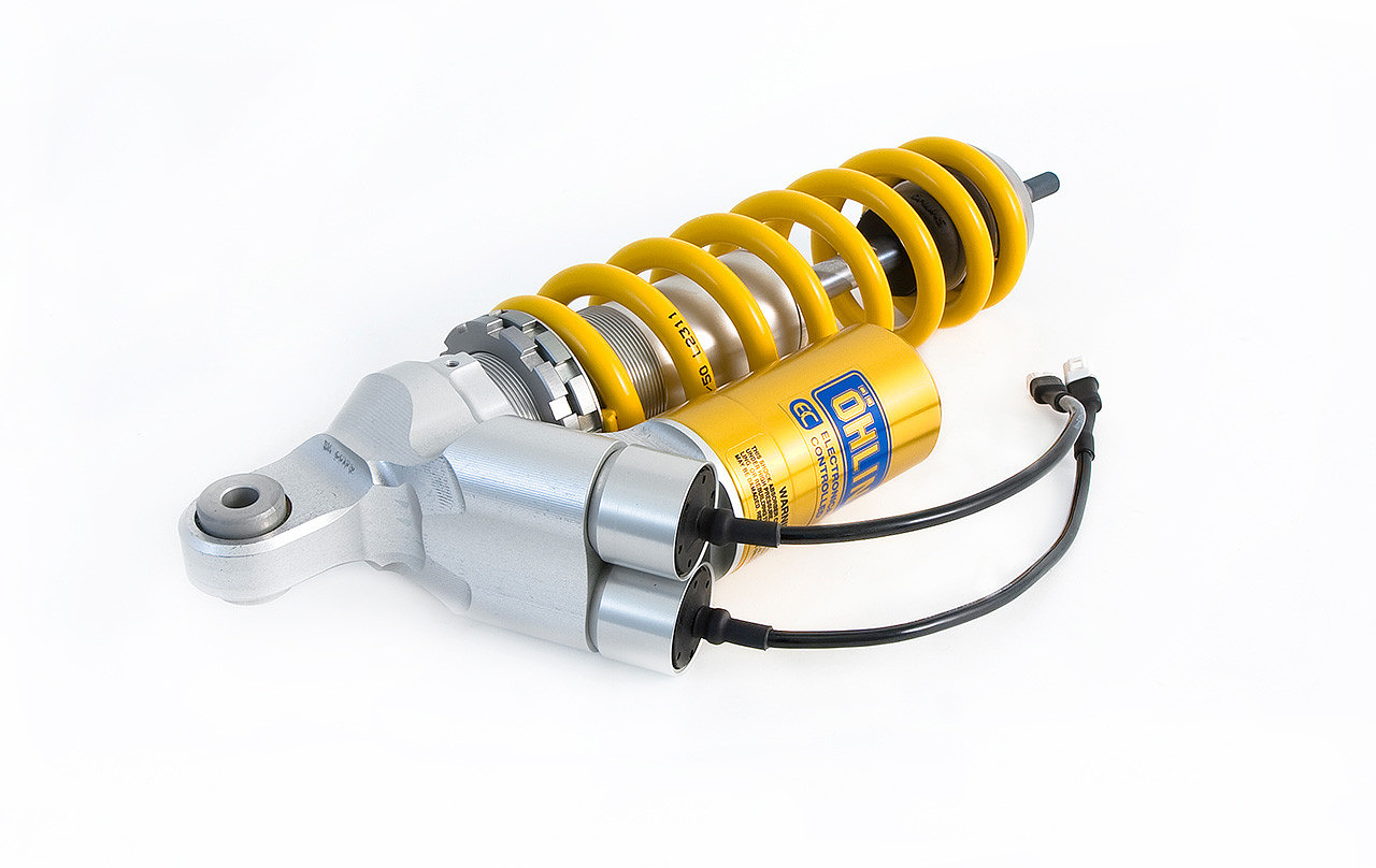

  16. I've had all my Öhlins rebuilt by FTR Suspension.
    One time I purchased a brand new TTX electronic rear shock for a very cheap price - supposed to be display only.
    It sat on my desk. I wanted to take it apart to see how they worked.
    One end said "Warning - Pressurised system ...blah blah blah"... so I thought don't take out that screw.
    The other screw didn't have a label......... sooooooo
    Lovely oil print relief on the wall ceiling of a human.

  19. In all my years of off road racing I’ve never done a fork seal and believe me the front wheel takes far more of a hammering than any road bike. However I’ve had many many weeping seals due to a small bit of crap. As it says above these things work, make your own from a piece of plastic milk bottle cut to shape.
