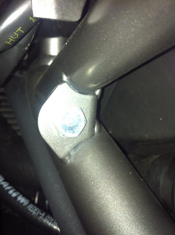

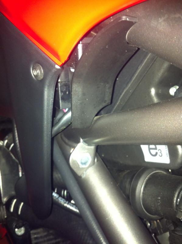

  10. No pic but it is a triangular gusset with a threaded hole towards the headstock under the side fairings.
  11. Is this the one?
    I didn't know what they were for but noticed them when the threads started to rust up - hence the greased up bolt! :rolleyes: My bike's a 2012.
    Mark H
  12. That's the ones
