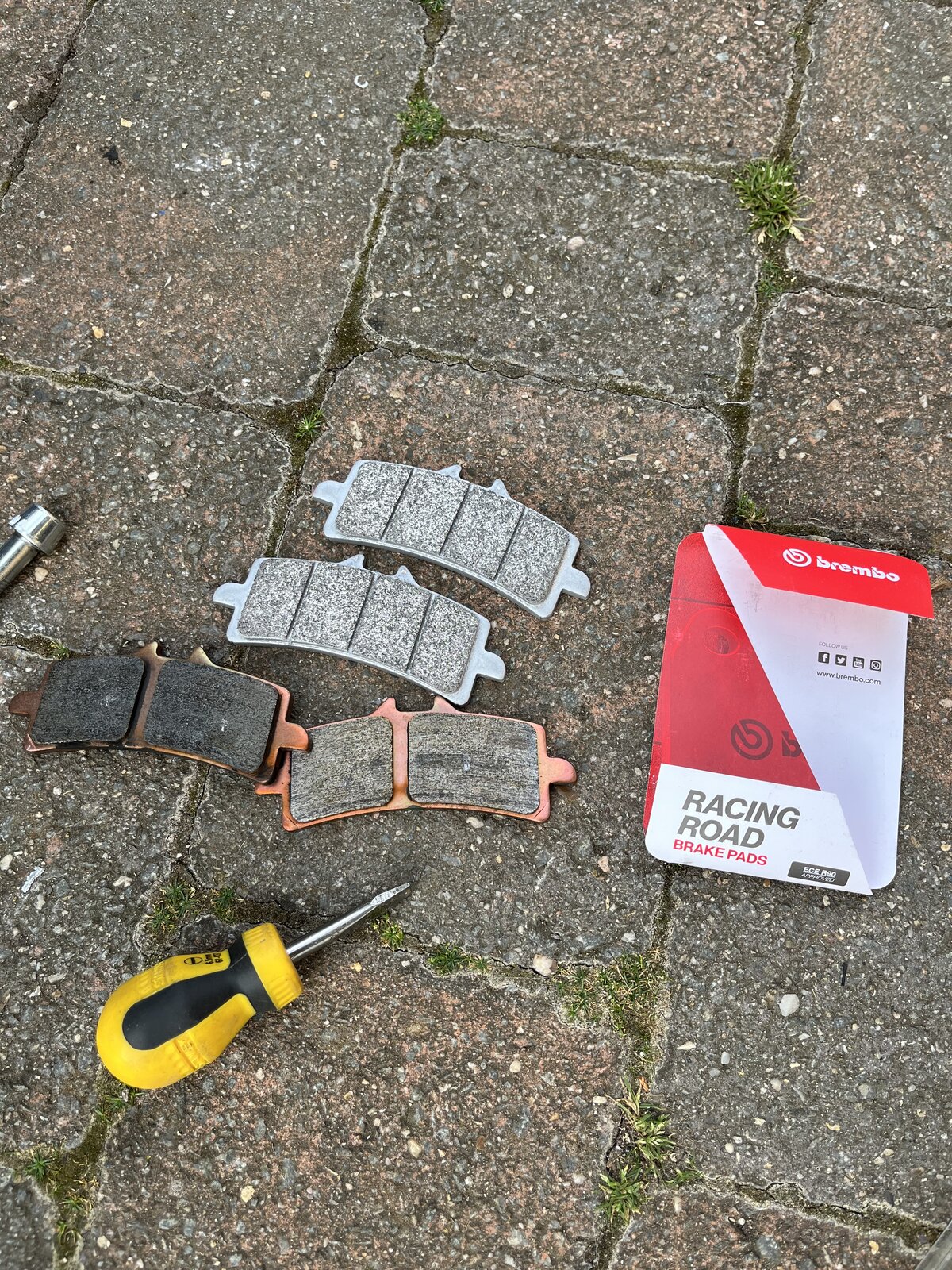

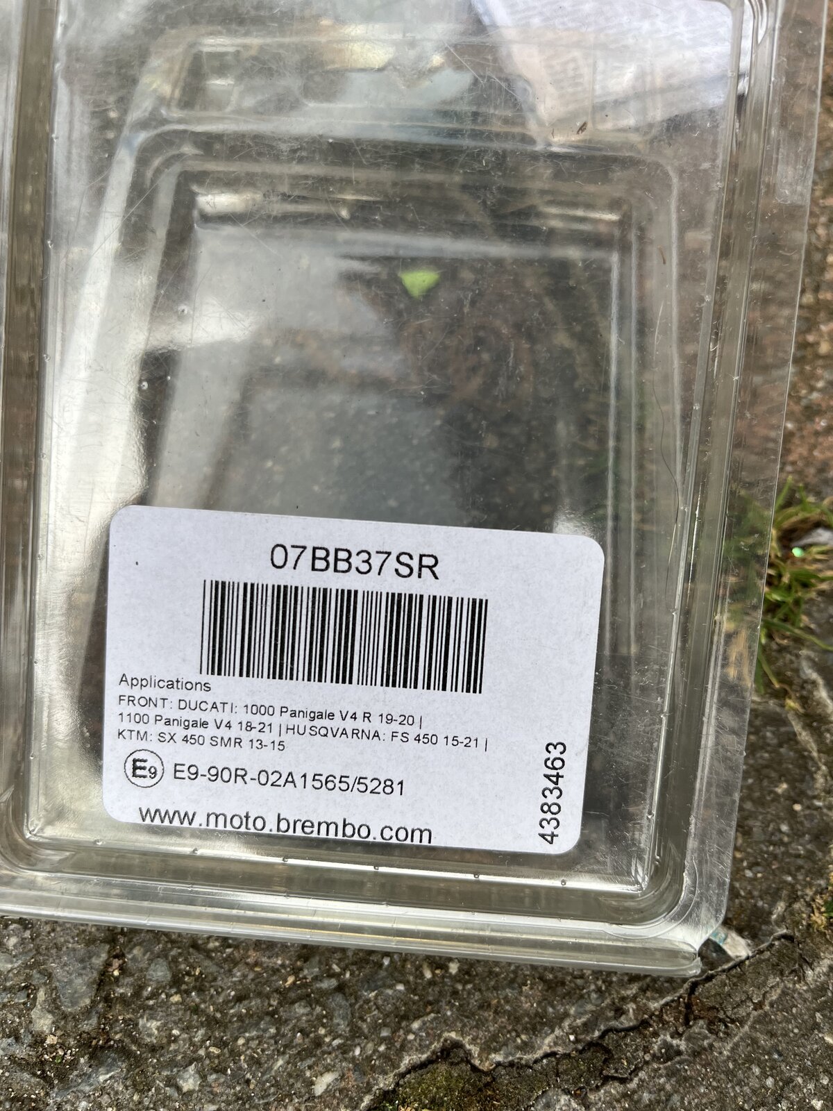

  2. 9F872589-D4F2-4A0B-B52D-196515E68909.jpeg 38DC1E4F-FD7A-466A-86E9-3532D8C3F138.jpeg Brembro Race Road pads , Ducati Coventry recommend as asked the same question as finding I wanted more bite .

  5. Not had chance yet as on holiday now for 2 weeks , once back I will let you know . Feeling is that it will improve due to the material change , so this will be an improvement on the touring pads due to be better heat dispersing, which in turn make the brakes better and your fluid cooler on those days of hard riding .
