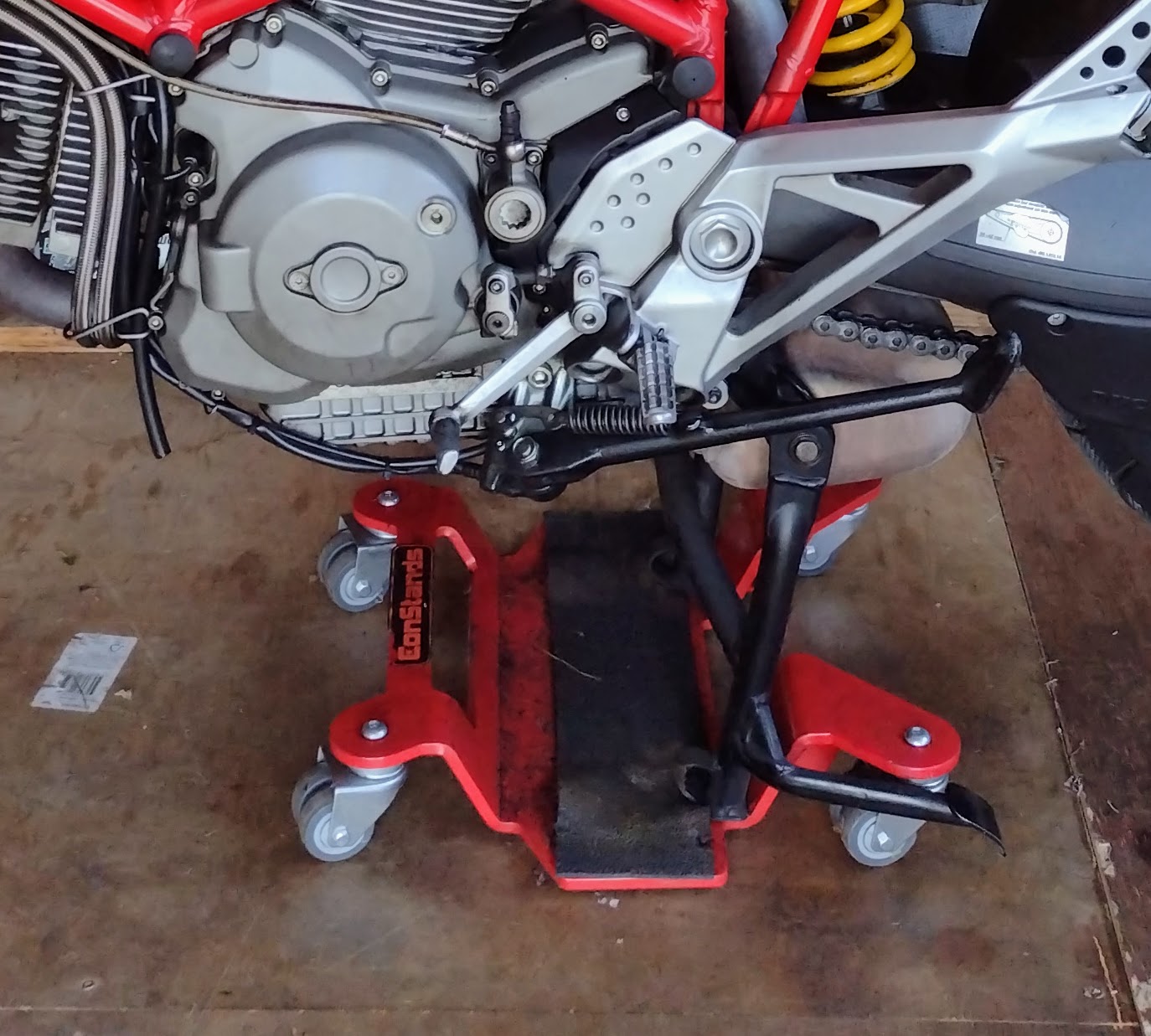

  17. Hello Analog Dave,
    I hope this is the right way off asking a question.
    Did you solve the problem with the ride hight position?
    Is it possible to post some pictures from the centre stand mount fitting?
    I have the same bike, I do not have the original 1100 stand, instead I will give it a try with a ST2 stand.
    But pictures would be off great value to me!
    Greetings from the north of Holland,
    Nico.

  19. Hi, I'm still around.:).. I was notified by email about this post.
    In answer to your question I had a professional company adjust my suspension to the correct
    settings and it now has plenty of ground clearance.:upyeah:
    https://www.kais-ohlins.co.uk/
    I'm not sure if the stand is a stock item or afterermarket. I'll post a close up of the mounting bracket later.
