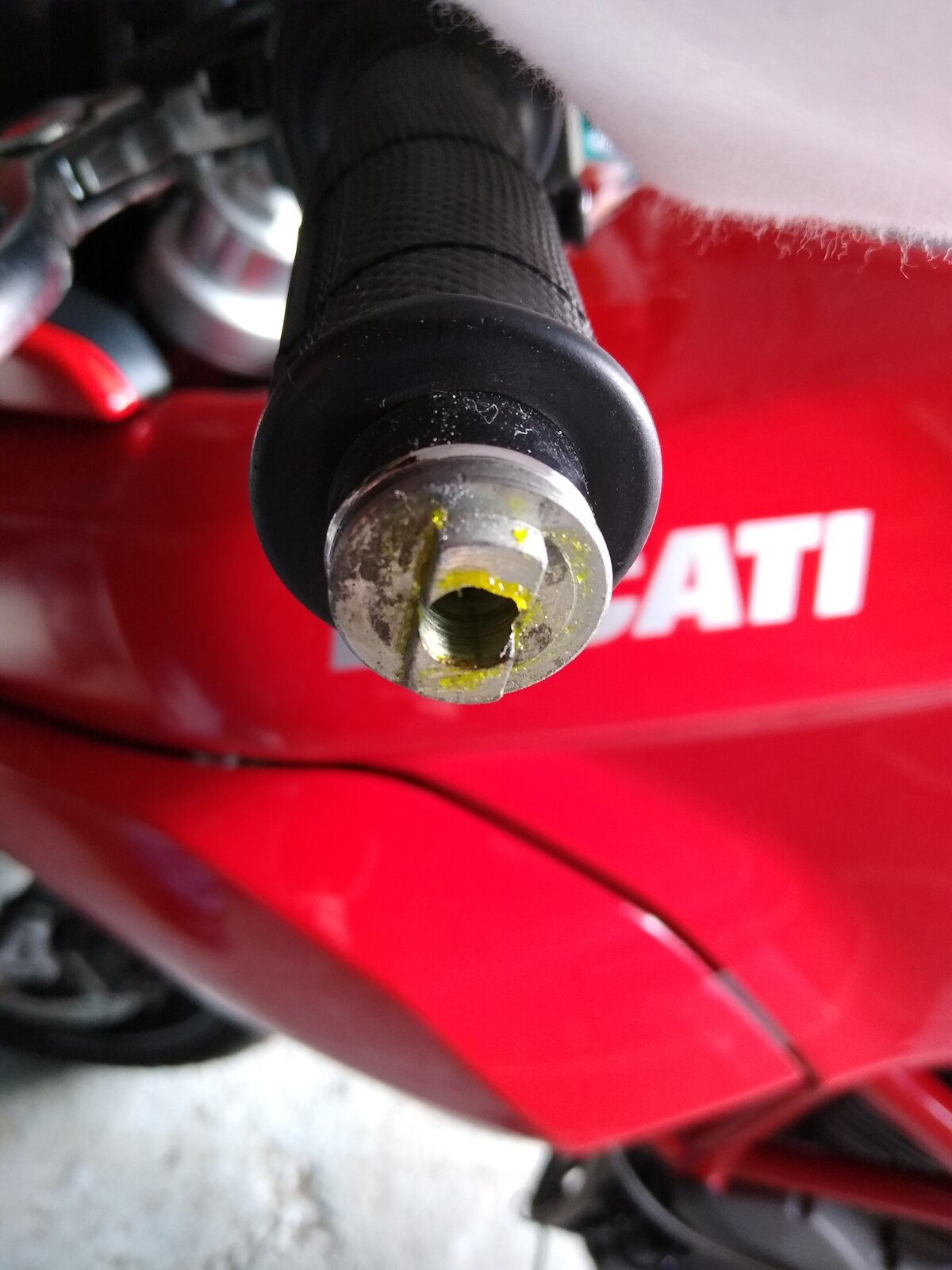

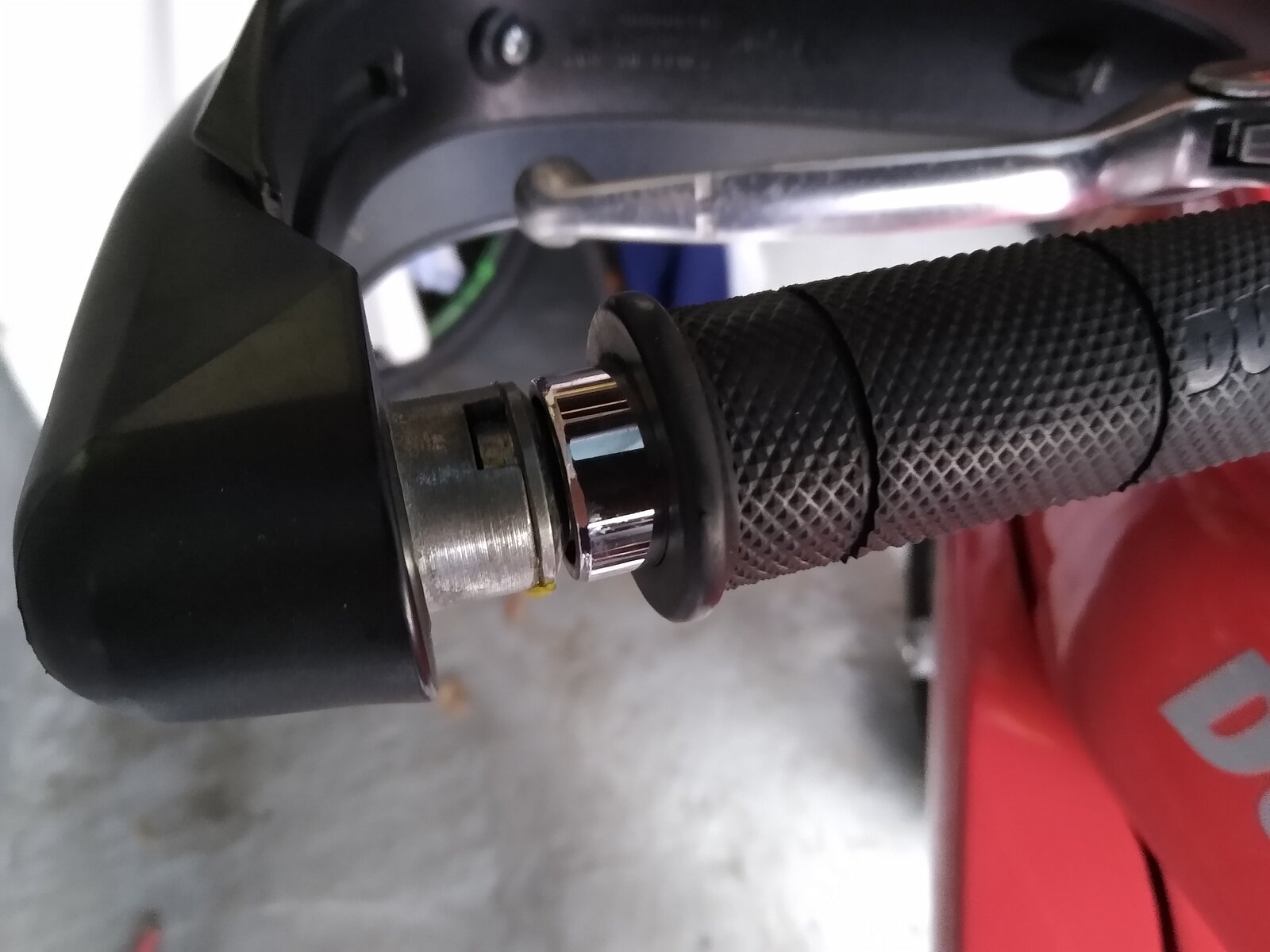

    I have a Ducati Multistrada 1100 year 2008 fitted with Acerbis hand guards. I want to take them off but I cannot get the expander bolt in the handbars out. Do you have any advice on how to take out the expander bar out?
    Thanks
    Some pictures
    #1 DukeNellington, Feb 21, 2021
  2. Have you encouraged the threaded end that expands in the handlebar with a hammer ? Once you have knocked the expander loose into the handlebar, it should be just a matter of mole grips on the end with a twist and pull motion. Likelihood is it’s corroded in place and will need a bit of force. Andy
  3. Thanks for the tip Andy I will give it a go.
  4. Managed to get these out eventually. I gave a slight tap with the hammer and then tightened the screw back in a little and then pulled / wriggled it out. That was fun. Thanks for advice Andy
