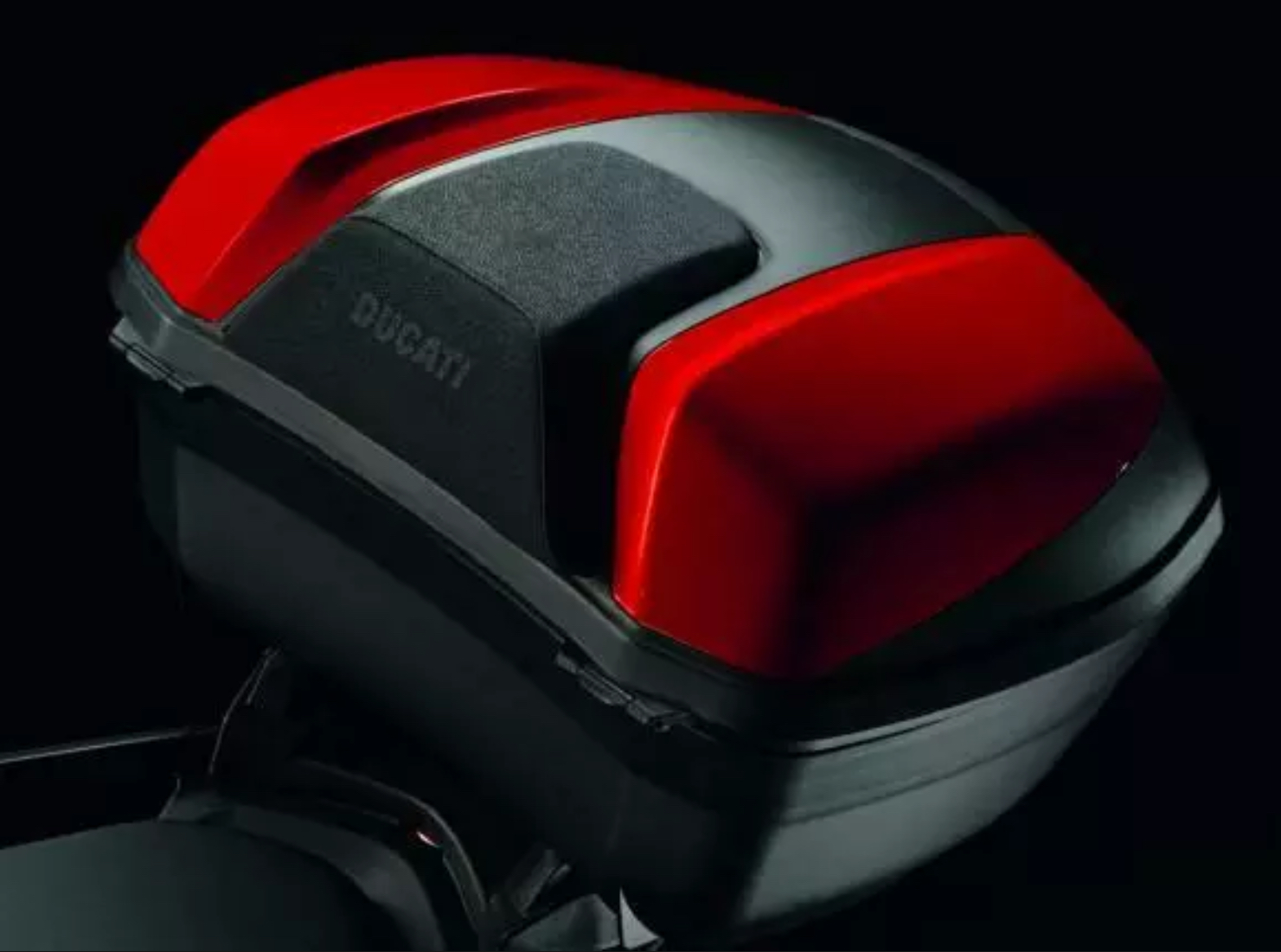

just bought an original Ducati top box 2nd hand but no fittings with it. my bike came with panniers only. I’m struggling to find the mounting plate and correct brackets for this. Is this a dealer item. any help, links, appreciated

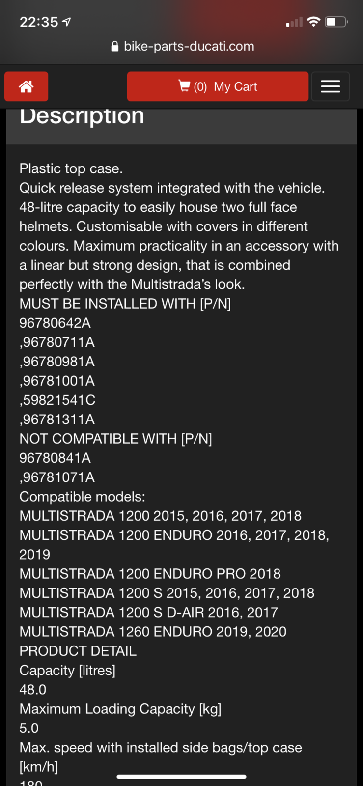

The top box part number is 96780692A and I think it comes with the the mounting plate/frame, can’t find a part number for the plate/frame alone so I don’t think it’s available to order?

SW Motech do a plate that fits the Ducati top box. I have one it has a quick release adapter plate which you can take off when not using the topbox so you just have the plate fixed to the bike. Also has lashing points on the plate for a roll bag if needed.
You do need the support arms that run down the side and attach to the under tray. Friend with an Enduro bought alternative top box and this broke his grab rail in fairly short order.
