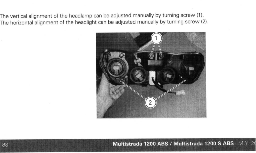

I read a while ago on the multistrada.net site that the manual was incorrect. This may help: My headlights came from the factory WAY too high. Best low beams ever, but I was consistently getting flashed from other drivers at night. The downloaded service manual switched the up/down and left/right adjustments. The two that are close together in the middle adjust the left / right, NOT up and down.
Really?...... Looking at the positioning of the adjusters I would imagine the owners handbook to be correct (1) to adjust height and (2) alter alignment left or right. Adjustment....good article here on setting the right height for motorcycle headlight beams: How to Adjust a Motorcycle Headlight | eHow.co.uk ....and a copy of what Ducati say in the handbook: Motorcycle Info Pages - MTS12 Servicing & Maintenance > MTS1200 Headlight Adjustment
No wonder, because our server is banned from those sites and I cant read a thing so on the # 2 ( the ones close together ) I'll turn counter clockwise to bring them down? Then apply the left/ right setting on the no.1? Were you able to fix the problem immediately?
Mine must have been set at the PDI, I've never touched them......you have it the wrong way round: (1) Clockwise for down (2) to move the beam to the left or right .....do it at night as per the 'how to' link above, i.e. lights pointing at a garage door or wall and you'll be able to see exactly what turning whatever 'knob' is doing ;-)
Andy, The early manual was incorrect. Glad they have it right now or do I mean up:biggrin: NOTE - This diagram is wrong - use the one above!
Sussed now that the image I posted is from the Owners 'Handbook'........so even more weird that they could get that right but not the workshop manual! Checked the later HTML workshop manual and they have corrected the text
