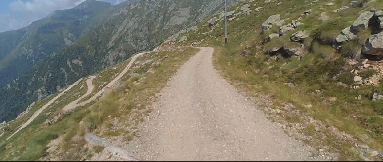

  4. I rode many km's of unpaved roads in the Alps with an MTS 1000, owned 2 BMS GS's before the Duc, riding the same roads, potholes, loose rocks and gravel. I find the MTS much more nimble than the GS Beemers under these conditions, all bikes were on normal road tires.
    I remember going up a road as you described in the Dolomites, with a BMW K100RS 16V, finding a hotel at night, fully packed with my wife as a pillion, even this bike managed without to much hassle, as long as you take it easy. So don't worry an MTS is definately up to the job.
    The kind of roads I mean:
    #4 NineNineSix, Jul 7, 2022
