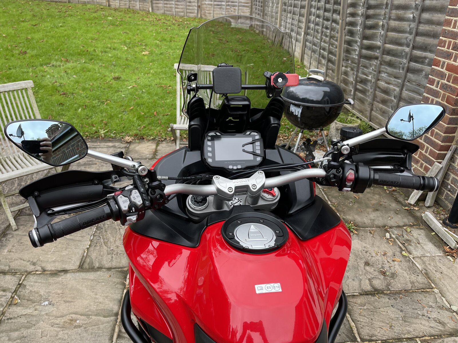

  15. Handlebar mounted BBQ, what will Ducati think of next? And don't think I haven't noticed the built in twin satellite receivers in your mirrors either, that's some bike you've got there.
