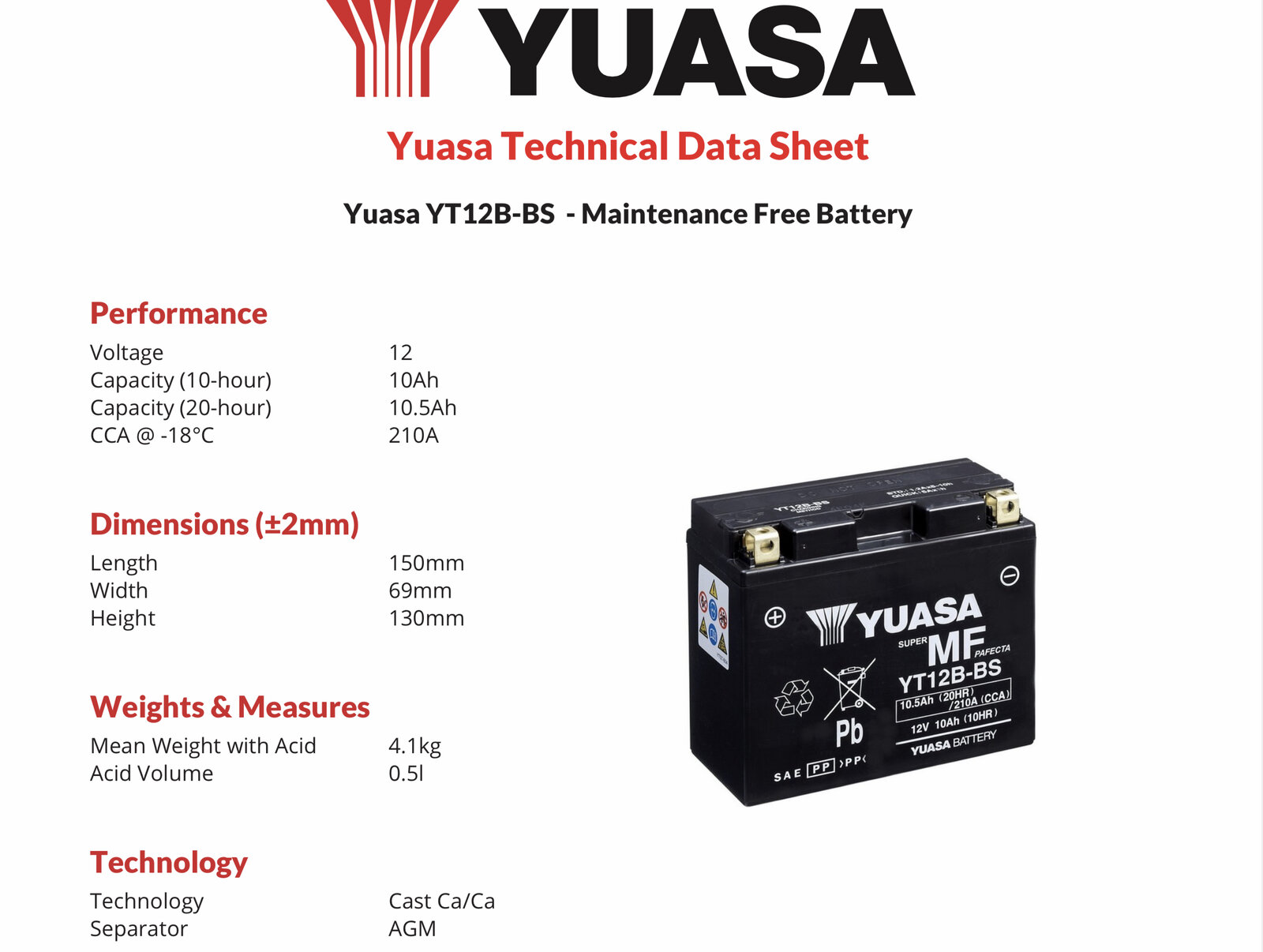

  10. I read on Halfords website that the CCA for the Yuasa is 175. The weight is not so important, but the fit is, I can manage without the Multi for at least a week so tomorrow after washing I will pull the battery out and measure the space.
  11. This is from the Yuasa website.
    One other fact I noted on the Odyssey site was that their batteries work down to -40° C. Even the above details quote -18° C.

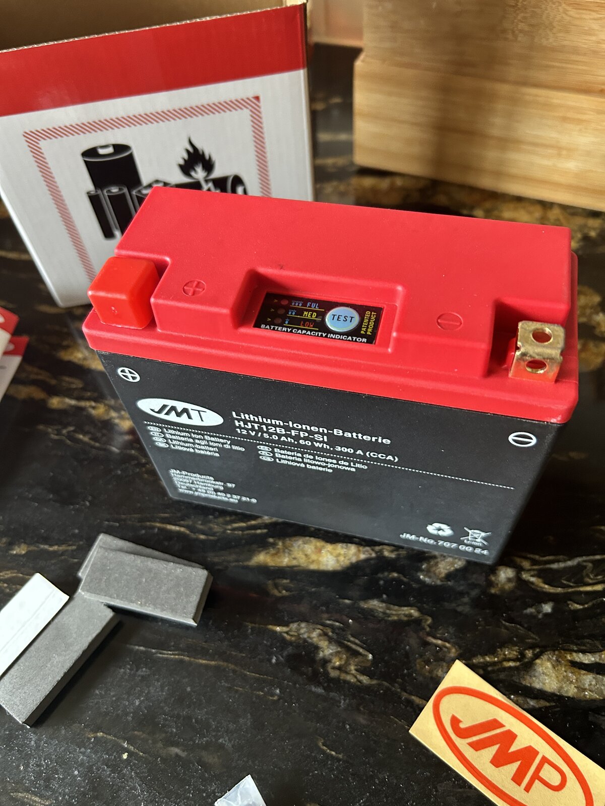

  13. I ordered this lithium battery from Two Tyres (never heard of them) Wednesday evening, received it Friday morning, excellent service. Including shipping it cost £123.90, so roughly double what I saw the Yuasa (OEM) priced at.
    It weighs nothing, fits and the bike starts, let see how long it lasts.
  14. Good for you. It should do the job for a goodly while. You are aware that you will probably need to change your Optimate, or whatever you have to prevent any damage occurring during the maintenance cycle. I believe this is due to the LiFePO4 units being sensitive to higher than normal voltages. :upyeah:
  15. Thanks for the heads up.
    I bought a Noco G3500 a couple of years ago when I drained the Himalayans battery by leaving the ignition on all night, whilst on holiday, I’ve just checked it has a lithium setting, I just need to swap the SAE or add a cable so I can use it without removing the seat.
