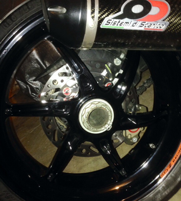

  17. 2013 Touring, 6K miles, and my rear brake is still working fine.
    Maybe less heat because of the full Termi?
