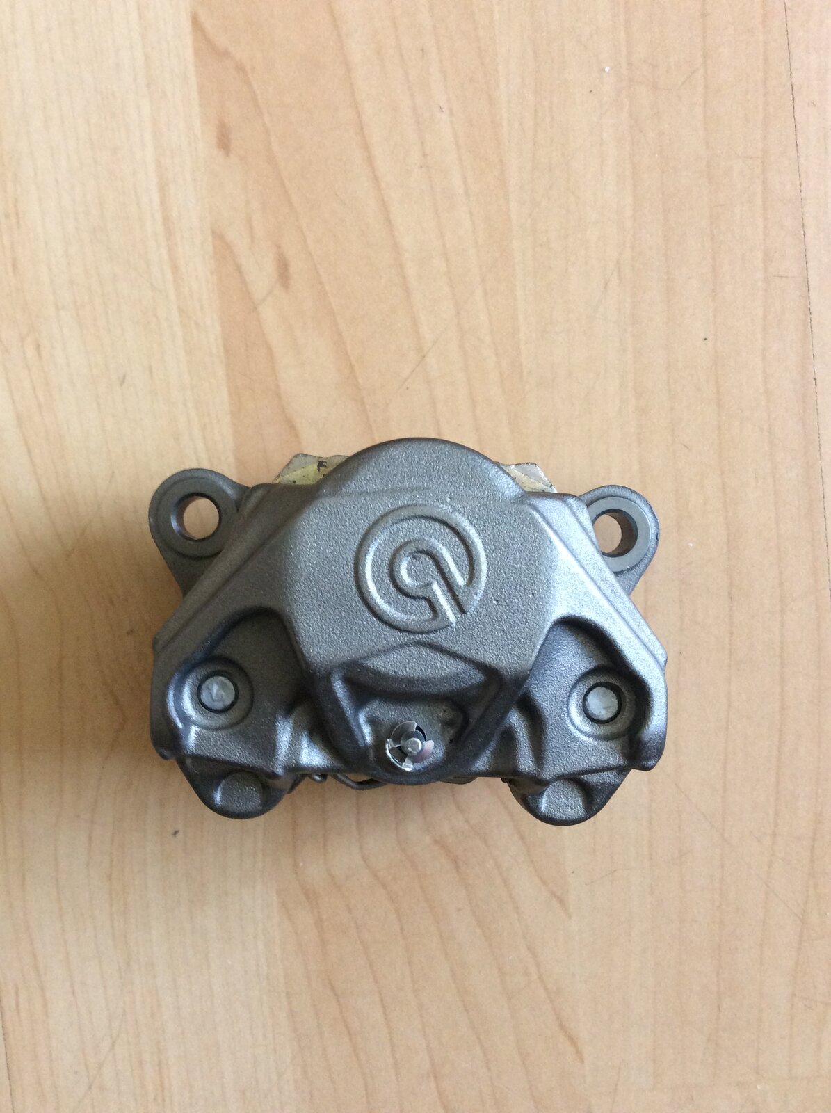

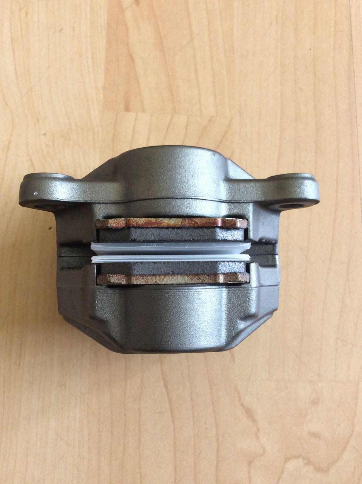

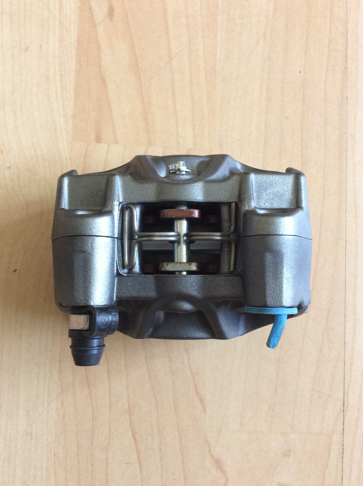

  10. This is what you would see if you could look up from under the swingarm.
    This is what you see when you take the rear wheel off.
    This is what you would see if you could look down from under the seat.
    If you could get the old pads out, the pistons pushed back and the new pads in without taking the caliper off the swingarm mounting points, you would be a better mechanic (with much smaller hands) than me. Andy

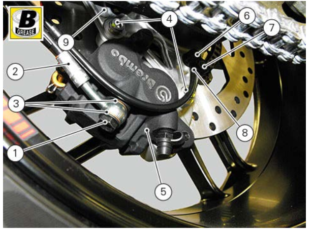

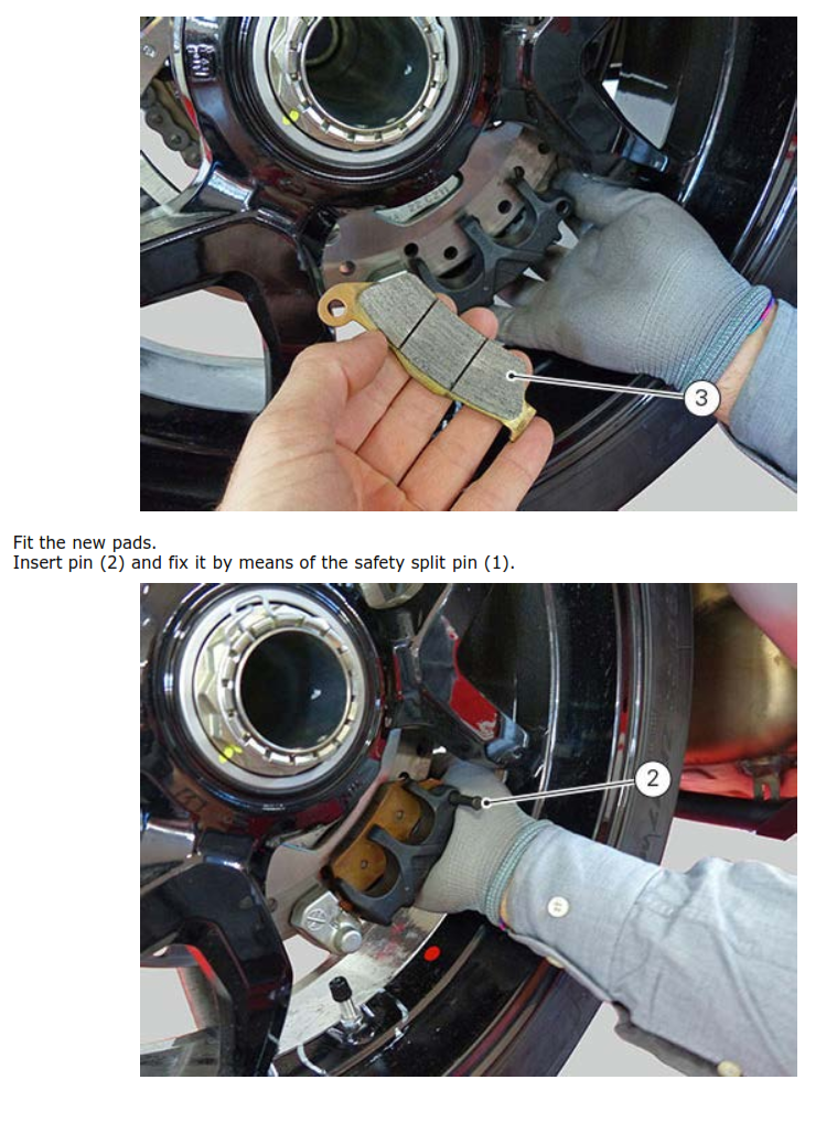

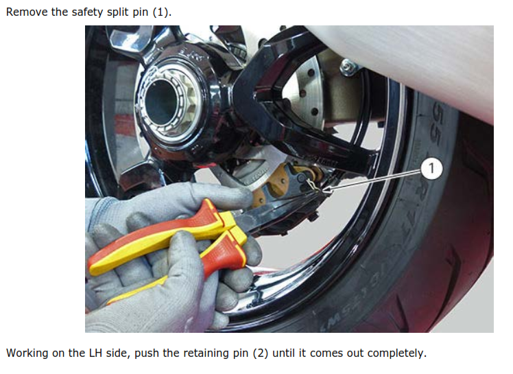

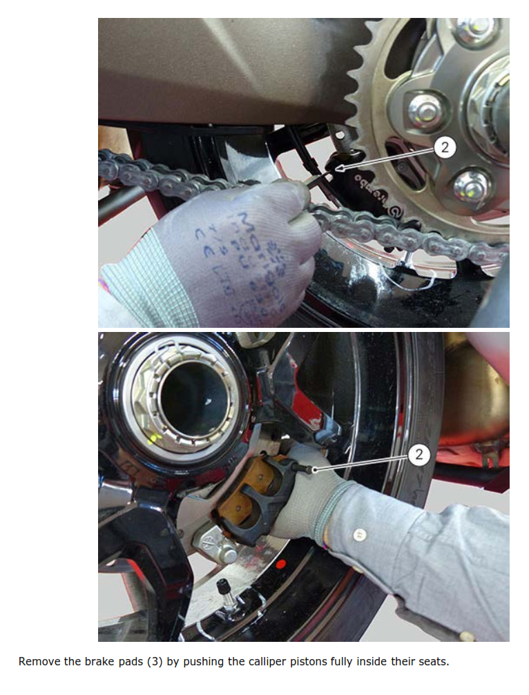

  11. @Android853sp - that's the rear brake caliper for a 2010-2014 model. The DVT models (2015-2017) have a larger rear disk and a completely different type of caliper (two pistons on one side). See photos from DVT (2015) workshop manual:
    It's very easy to change the pads with removing the rear wheel or caliper. It's also easy enough to remove the caliper and clean it up and lubricate the sliding mounts.
    I'll add some more photos in a minute.
  12. Beginning to lose the plot, thank you for the information. I have had a torrid time with the rear brake on the Diavel which looks like it is very similar to the DVT but saw on Bike Torque Racing’s catalogue, the caliper in my picture is supposed to fit the Diavel .... which it doesn’t ...... but turns out it’s the same as my first gen Multistrada. The Diavel caliper had to come off to be rebuilt but I did find the pin that the secures the one end of the pads, was seized which would have been a challenge if the caliper had remained on the bike. Every day is a school day, even Sunday :upyeah: Andy
