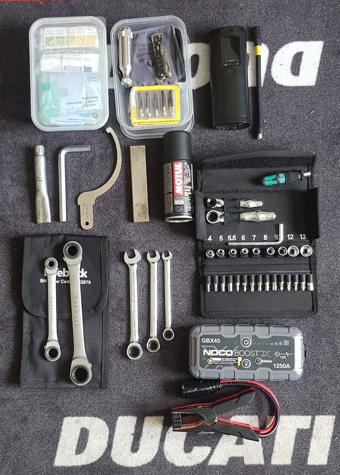

This; small first responder kit, sticky string puncture repair kit, battery powered pump (good for 4 front or 3 rear tyres), SSSA chain adjustment kit, Wera tool kit, a few spanners and a power pack. All packs away in a Kriega 20 along with spare gloves for 2 and high viz tabards, which sits on the pillion seat with a Kriega 10 attached for a change of clothes, tooth brush and my jimmy jams. Andy
