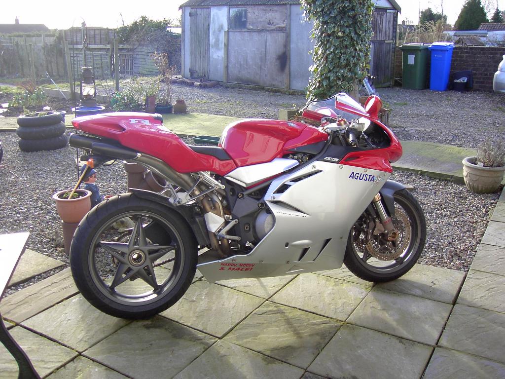

  17. I bought a motor from an SPR with only 2380 miles on it. Its the same as the SR. A lot more horses than the earlier 750 and a close ratio gearbox.
    Its a different bike and a lot better than the EVO 2 motor
    I've posted these before but I will do it again.
    get yer wallet out and buy one you won't regret it
    By the way one thing not mentioned yet they are noisy mechanically compared to Japanese IL4. Quiet compared to a Ducati though
