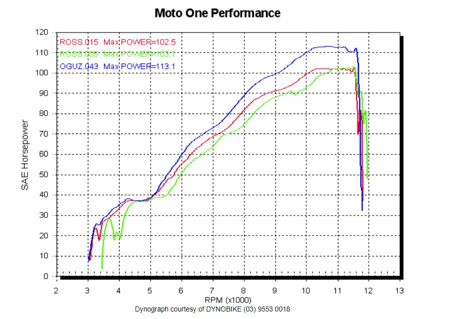

    First a reference point dyno graph from one of Brad Black's reports (a Ducati tuning guru in AU) in 2003. In it (all are 748R's) - green has the 45/50 Termi system and DP chip, Red has cams dialled, throttle bodies bored, trumpets extended and custom Ultimap chip and the Blue has all that plus porting.

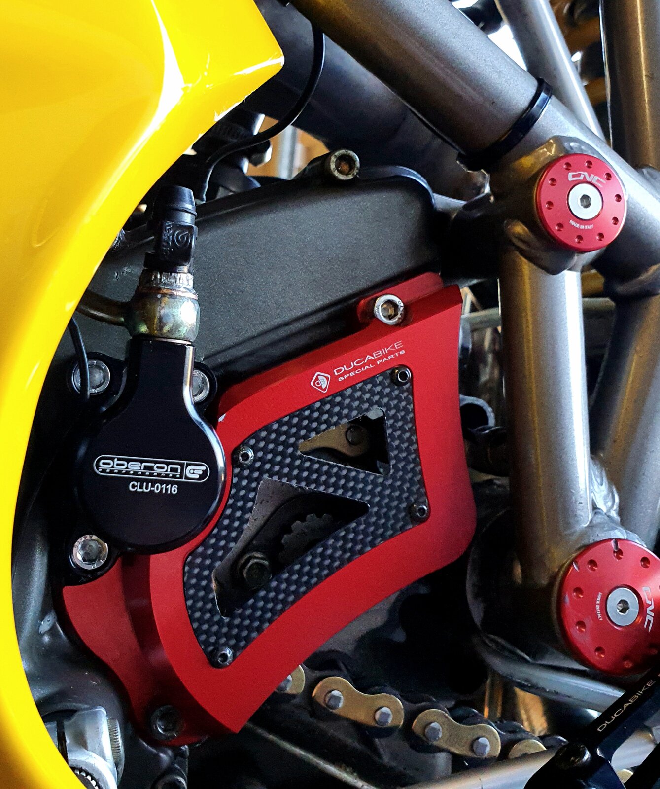

    Finally, as an aside I also fitted an Oberon slave cylinder which has lightened up the lever action a bit and looks quite nice too. :)
