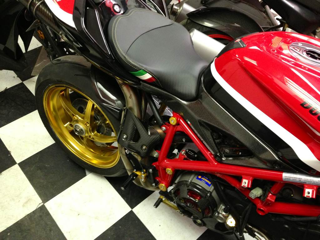

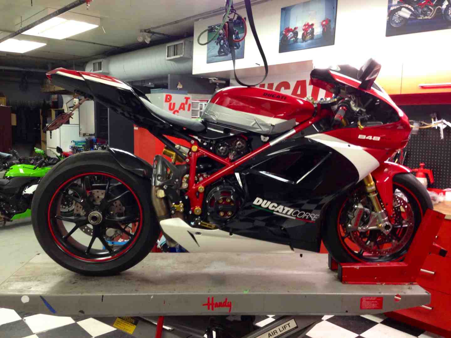

  1. I am a new guy on here and maybe you might have seen my first post in the new members thread so I have decided to build my 848 into an "R"
    I know that Ducati didn't offer any "R" from the factory so I took the project upon myself to be different!

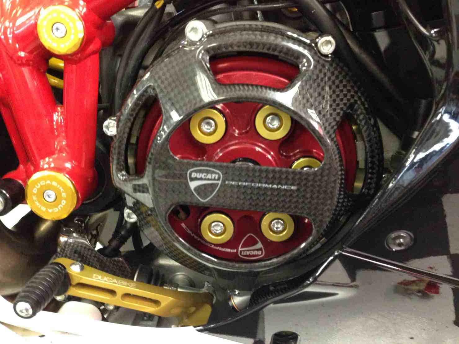

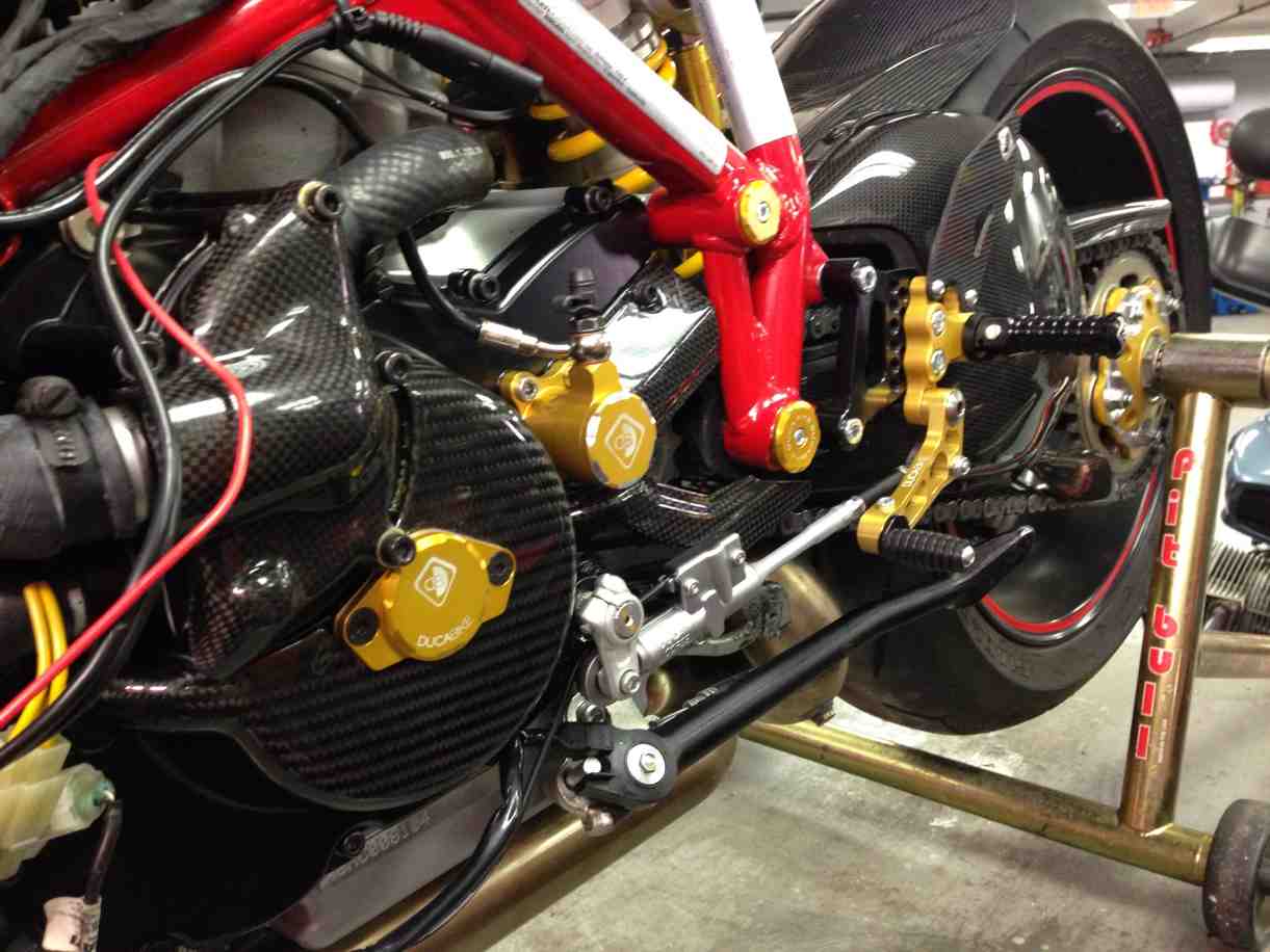

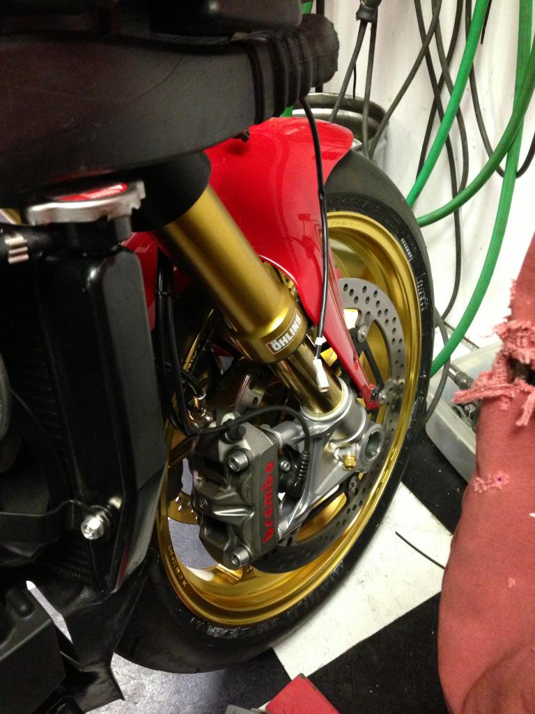

    I have added a ton of upgrades on the bike thus far from Carbon Fibre to a full Termi system to a complete Ohlins suspension to a Slipper Dry Clutch & a lightened Fly Wheel!

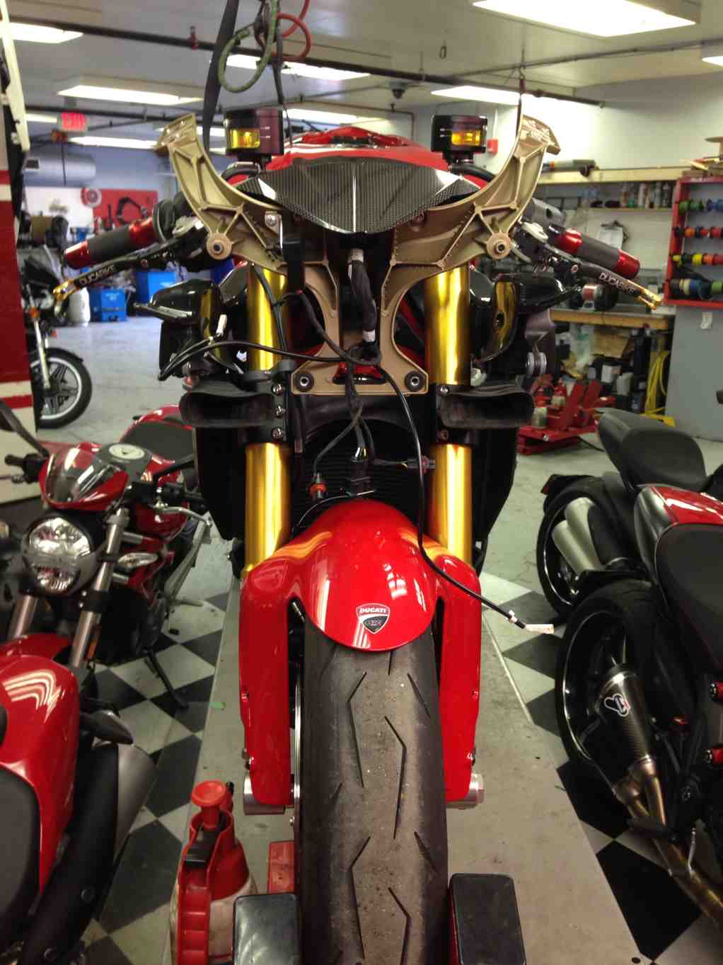

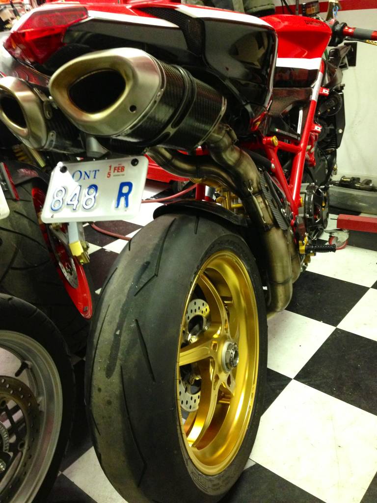

    Here are some of the latest pics so far...
    In the last week I have added OZ Wheels & still waiting for my TTX MKII to arrive...these pics were taken today!
    I even have a fitting license plate lol!

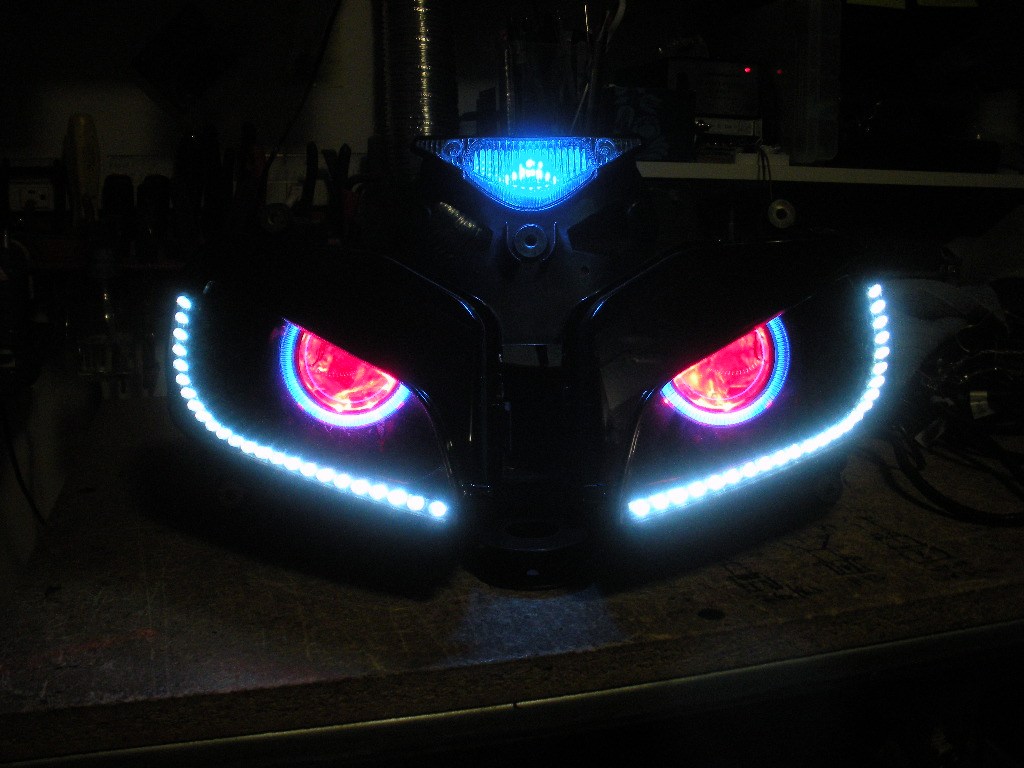

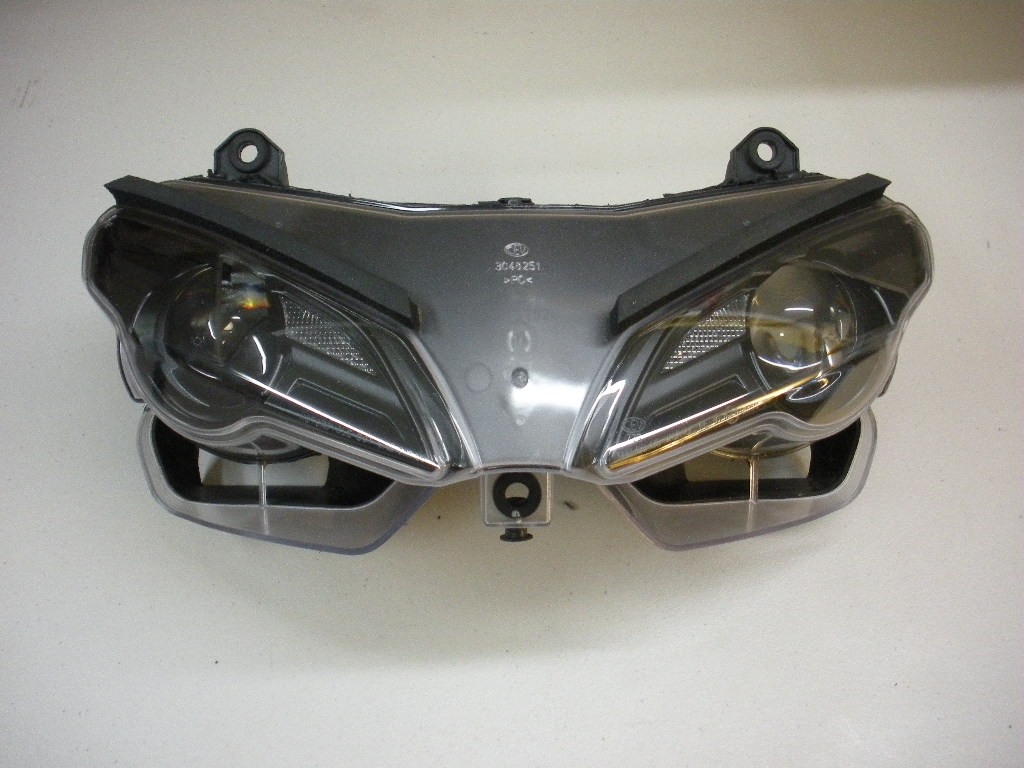

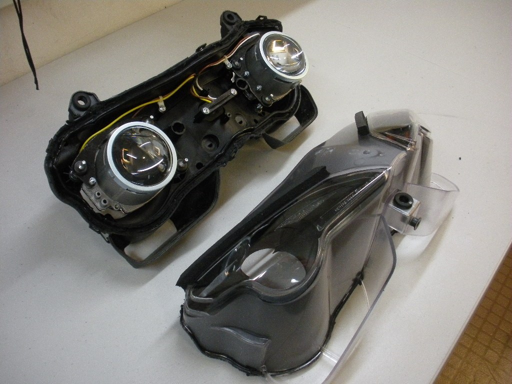

    My headlights are in California at the moment undergoing a projector retro fitment where I will have both lights on low beam on & both on high beam.
    These are not them but this will be similar to what mine will look like...
    As for the plastics they are at the painters getting some custom airbrushing...those should be back in the middle of January...pics will follow!

  2. Looks like Dementor may have some competition! :upyeah:
    Out of interest which flywheel? I thought the std 848 one was as light as the DP aftermarket one anyway
  3. We are both doing pretty well the exact same thing to our bikes with a few minor differences lol!
    Ducati Corse lightweight flywheel, Less rotating mass results in lower inertia allowing greater capability to rev up especially from low speeds. This flywheel weighs 2.12 lbs (0.960 kg) while the stock flywheels weighs 4.18 lbs (1.898 kg) saving 2.06 lbs (0.938kg). This is a great weight savings and is a noticeable upgrade. Be careful getting a flywheel that is too light as your bike will have idling issues...this flywheel has a good weight so you won't have those issues.

  6. So whats next then? Keeping paint scheme? really love the ohlins on these..carbon wheels? (another top f my lottery list)
    Interesting you went dry clutch route, cant stand the noise myself but know loads who love it and consider it part of the charm, so both Dementor and I have a sigma slipper fitted.

  8. Yes I am keeping the paint scheme the way it is but I am adding to it by way custom airbrushing...nothing to major but some subtle touches, carbon wheels are nice but I really like the ones that I just put on!
    Yes the dry clutch is a different sound and also the trademark of Ducati...either you love it or hate it!
  9. True all the R's do have titanium rods & stronger internals but for the most part mine will be about 75% as an R, if he motor ever goes then I will be going with the specs for the internals as an R
  10. Lighter gear box and many other small tweaks make up the R engine...
    Good luck to you, making it your own is what counts.. you could dump the monoblocks on go to the old 08 monster calipers that looses another xxx grams ....lol Well that's my excuses....haha.
  11. That's exactly what I am doing...making it the way I want, everyone knows that 848's never came in the R version but I am pretty close to it...and if they did have them available, so that's why I am calling it an R hahaha!

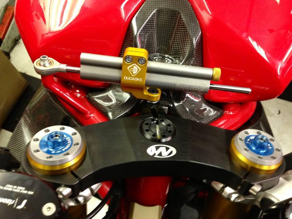

  13. Is that a corse ride height adjuster?
    im interested in the projector lamp conversion.

  16. No...that my friend is from Ducabike!
    Take a look this is where I am getting mine done, there is 100's of combinations but it will cost you about $1000.00 but work is simply amazing and it's custom!
    Click here---> http://www.sickhids.com

  17. The gold OZ Wheels that are on now are definitely lighter than the stock wheels, carbon wheels here cost $5000.00 for a set plus I don't like the 6 spoke, I am more of a 5 or 7 directional spoke type of guy...also I really hate black wheels! Lol!

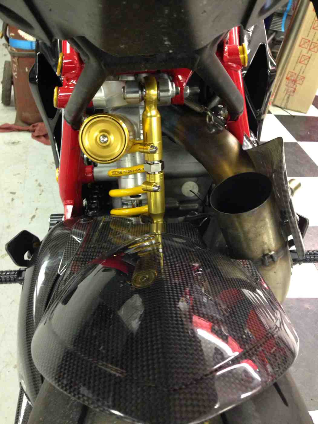

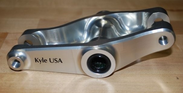

  18. Mine could do with the Kyle rocker and modding my TTX, stock spring in the TTX36 is too long as are other weight springs from what ive seen so be sure if your chopping it over to get the correct one but IMO it will never work well with the OEM rocker.
  19. You mean the track link right? Thanks for the heads up, I might have to order the Kyle unit!
    #19 Sinister, Dec 23, 2012
  20. actually its the shock length that is shortened to go with the kyle rocker..........i have a couple of the shorter bottom eyes that achieve this if anyone requires them....you would also need a shorter tie rod too....its all about levers and moments..not bling and bull:wink:
