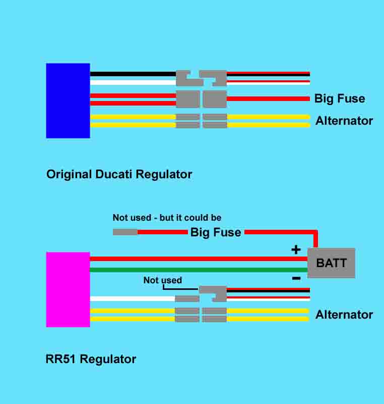

  2. Fit an Electrex RR51 reg rec......Their wiring diagram isn't that good for what you do with the defunct wires etc, so if you want a simple diagram for tidying that up....
    AL

  6. Can't help with that Gaz........all I can tell you is that my SS has got an RR51 reg rec fitted........It wasn't wired up very well when I got the bike, so I did it properly.......
    .....but I didn't solder the yellow wires (which were the same size from the reg rec as the alternator ones), just used big push fit connectors and waterproofed them.....
