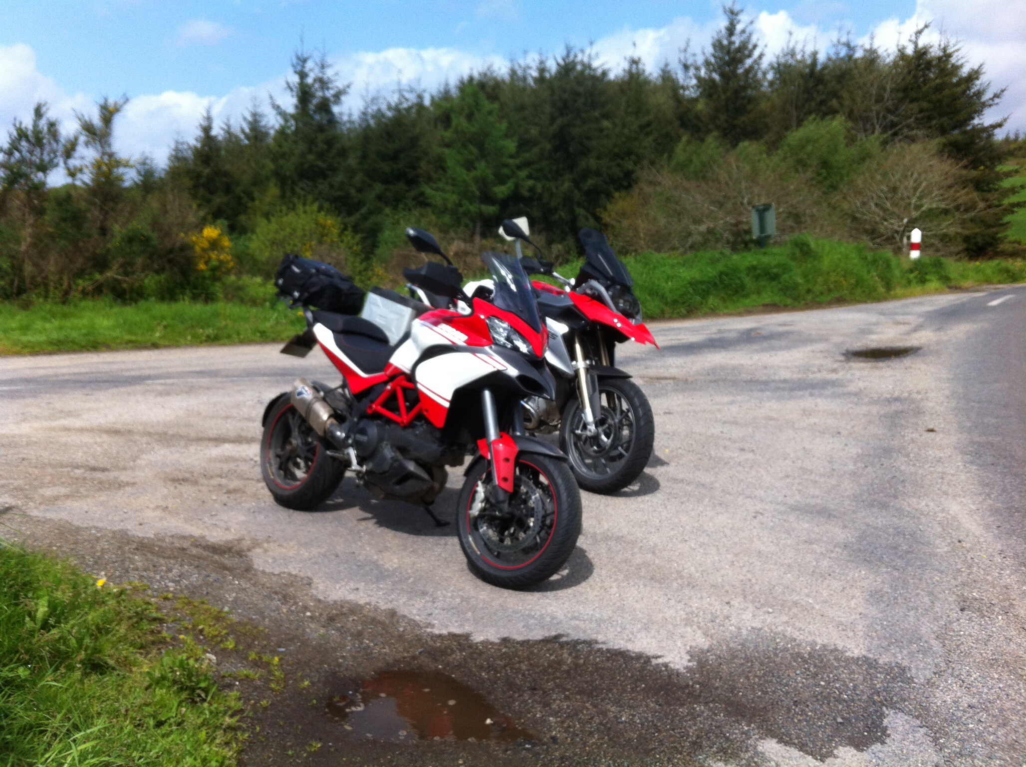

  16. Just back from 2000 mile trip around France and no issues with the bike, quick shifter etc. the only issues which, Chris from XBikes I understand is liaising with Wayne from Tuneboy on, is smoothing out the QS at slightly lower revs and we need to sort out a slightly rich fuelling on what we think is a closed throttle. Have read elsewhere, but weirdly I am sure the fuel consumption improved the warmer (further South we went) the weather got! Below is a picture from the gorge d'ardeche, stunning countryside.
