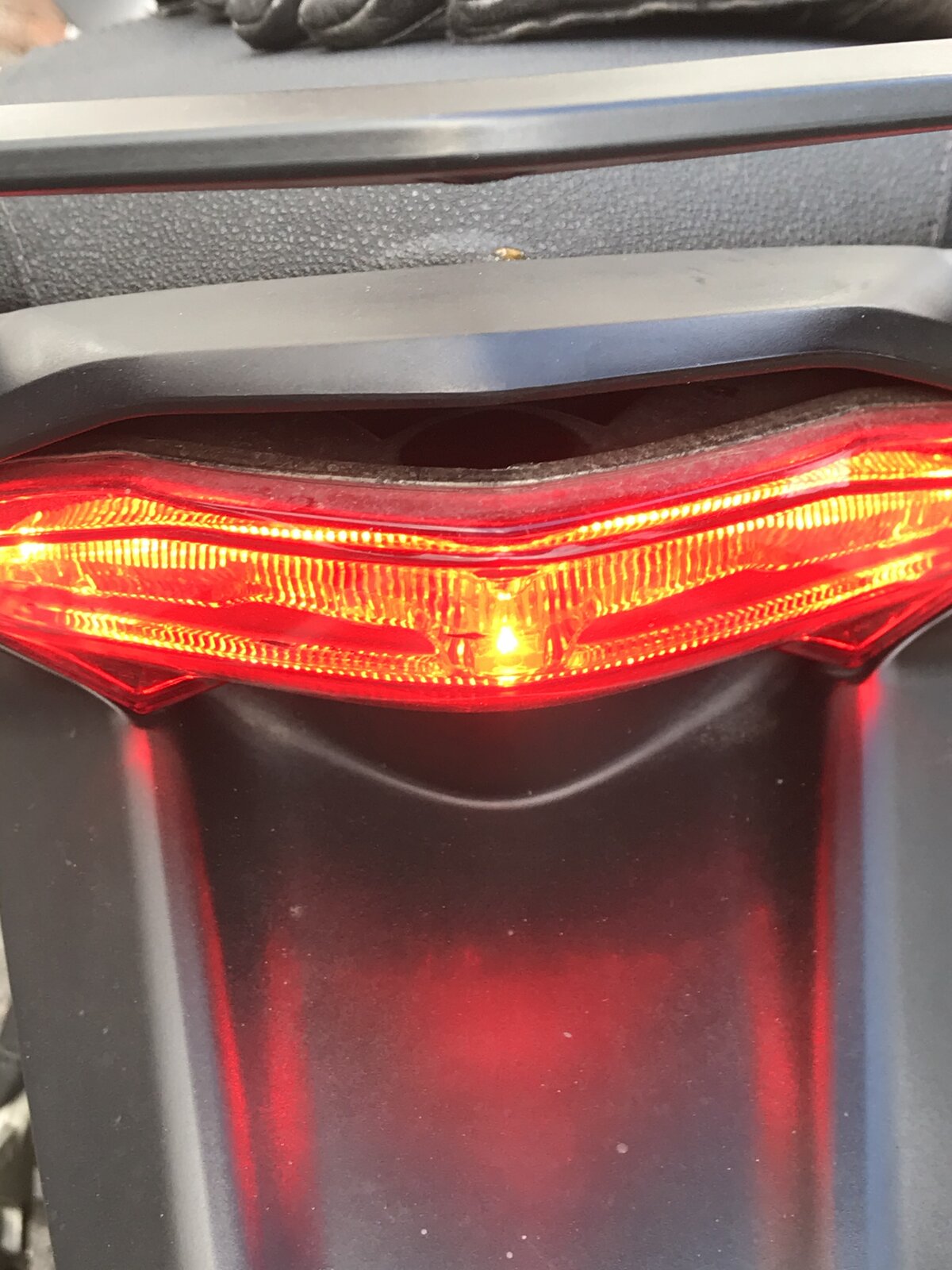

    Ref Rear light cluster movement and gap at top appearing.
    Over time my behind seems to have more and more movement of the entire black plastic light holder/ number plate holder . I have tried tightening the 4 bolts under the passenger seat to lessen the movement, seems they are as tight as possible and the problem remains. Riders following think it’s going to come off. Is this a common issue? There is also now a gap appearing above the red rear light
    lens too.
    Any ideas TIA.

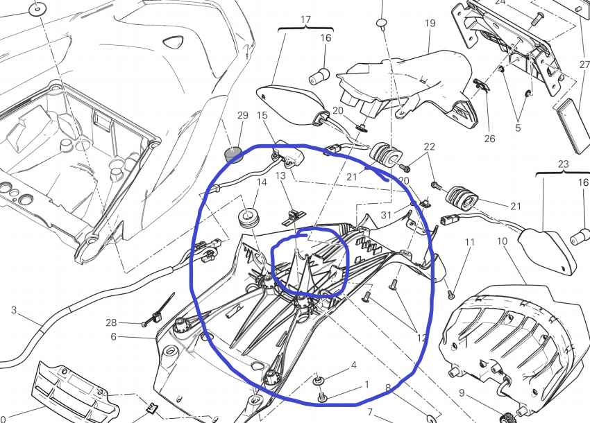

  2. If you look at the inner circle of the attached pic, you will see a half round plasctic tang. If my memory serves me correctly, the rear light is held in place with this tang pushed or affixed to the light assembly and two screws that go through two rubber grommets which are at the lower corners each side of the rear of the rear light. I have a feeling the top of the light has popped out of its location, hence the droop.
    If you look at the rear of the light, you'll see 3 round tabs. These are the fixing points.
    Remove the rear under-tray and the light comes away with it. No need to detach anything else. Just the 4 under-tray bolts. Hope that helps.

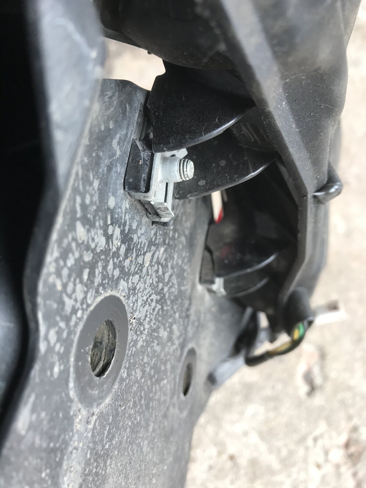

  7. Think I have found the problem, now to find a second hand lens cluster. 0A79BD5F-25A0-43ED-8F08-89E143635EF5.jpeg
  8. What year is your bike? Reason I ask is I had a similar issue on my 11 plate. I made a pair of small u shaped brackets(flat bottomed) and fitted them between the two vertical tangs that are shown in your pic. I drilled the plastic and affixed the u brackets with fine, small rivets. The screw plate (as per your pic) slid onto the bracket and it all screwed back as per normal.
    You could try plastic welding it all together again.
