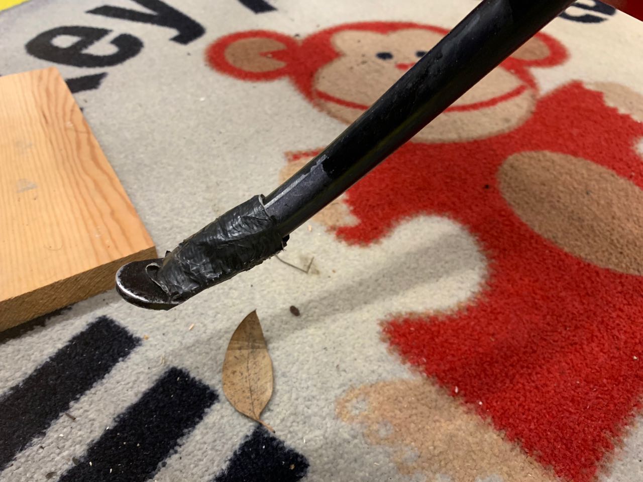

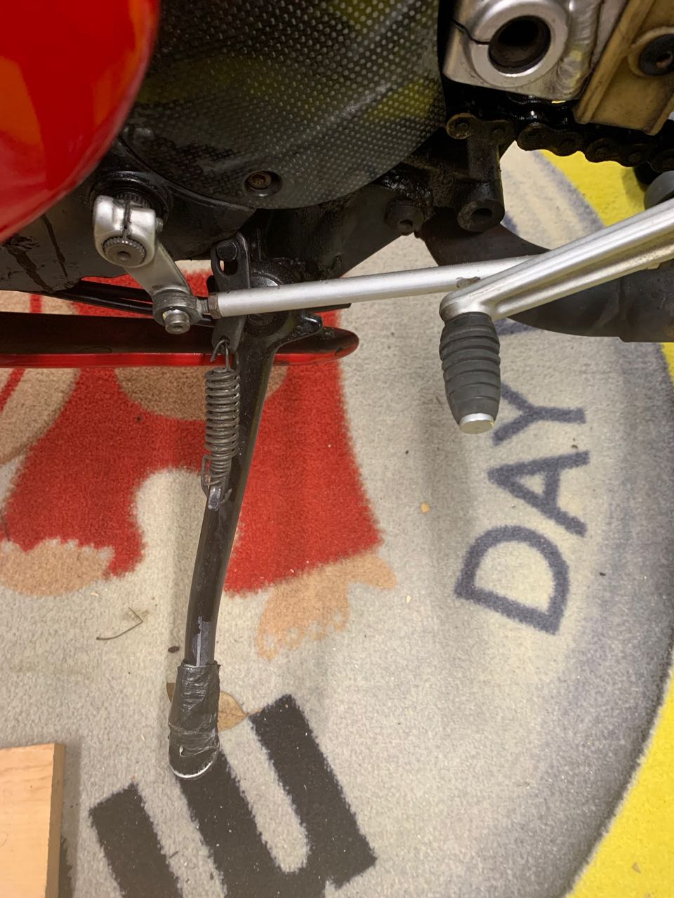

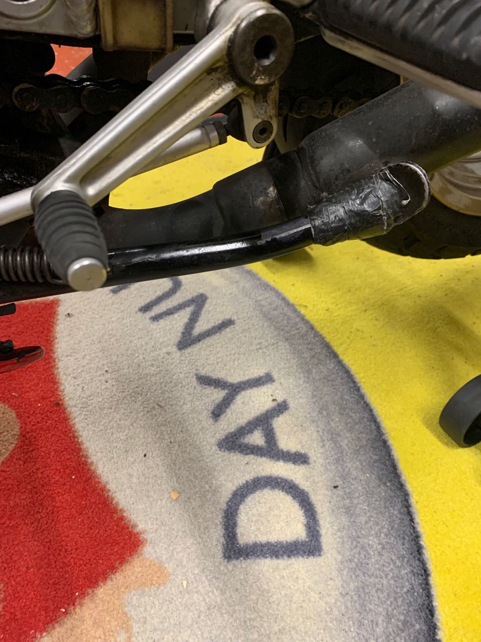

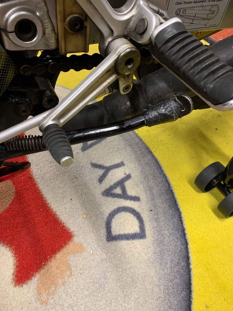

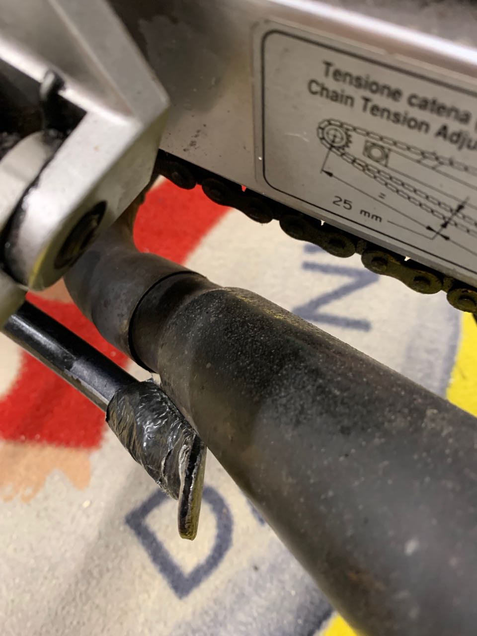

  1. Any idea why this happens, it it just bent? Previous owner has wrapped black gaffa' tape around the end. 1993 750SS.
  2. I don't own an SS but i had a look on ebay to see how it looks /goes together,

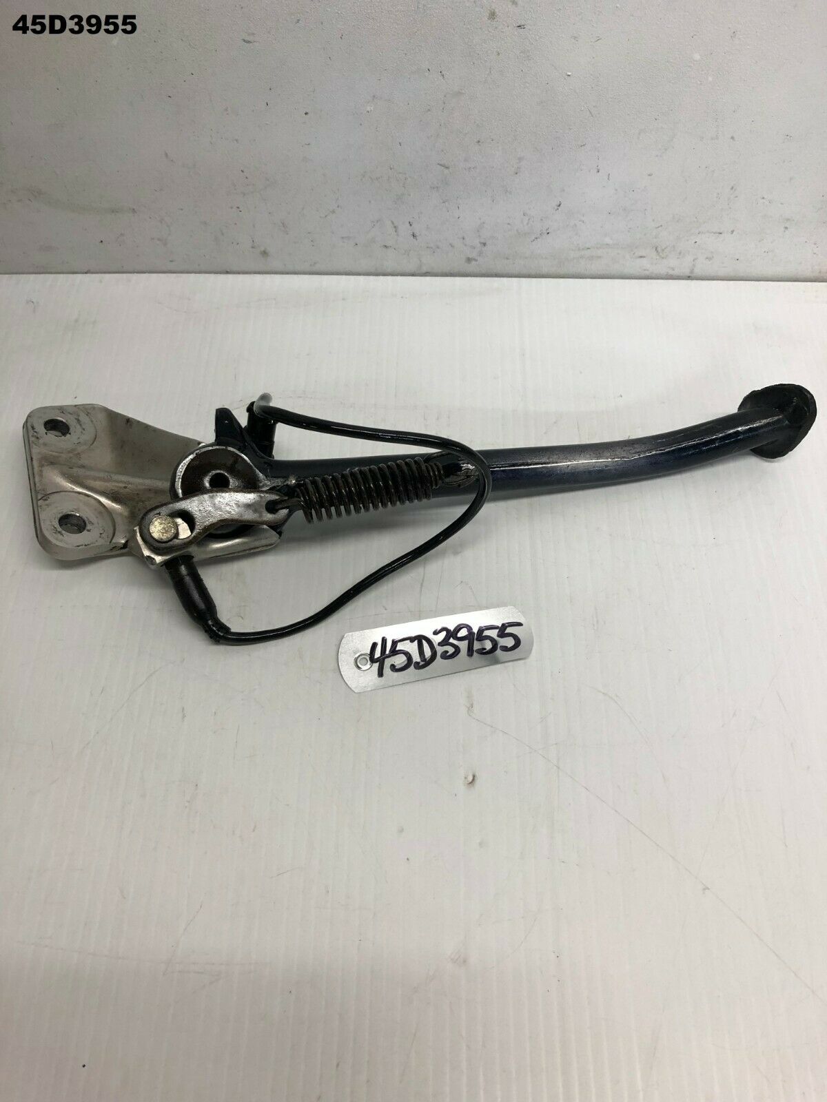

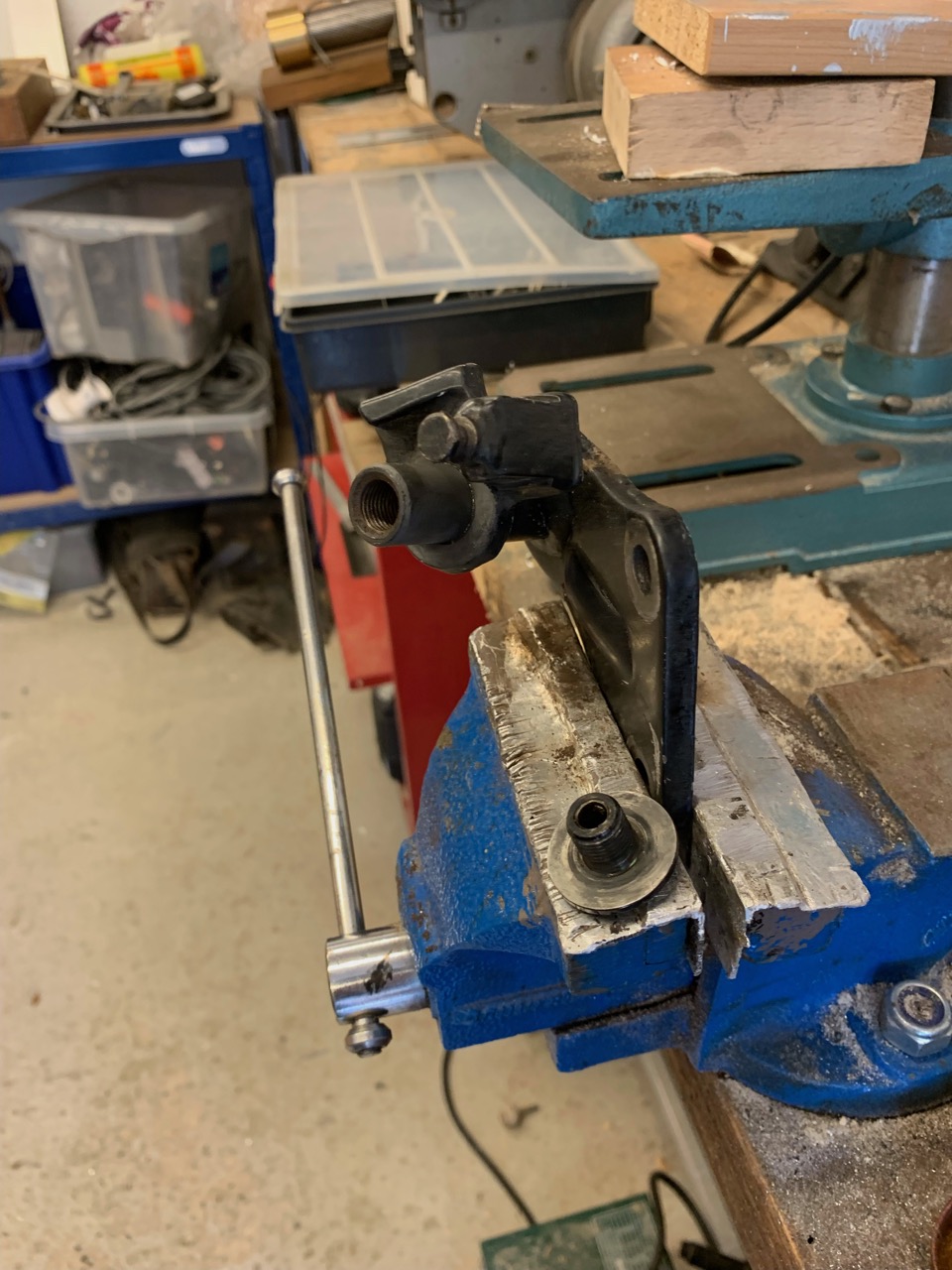

    I would take the complete stand off to check the backing plate it all bolts to has not got a slight bend in it and if not unbolt the stand and maybe put a washer to shim it over a bit as it might be worn from usage, i would think some part must be worn out, in the second link could be worn were the stand slots on to?
    Ducati 750 SS Bj 1993 - side stand A1802
    Ducati 750SS 1991-1993 Side Stand Bracket Plate Mount OEM 55610031B
    A tip when i need to look at parts etc to see what it is, i look on ebay for the parts and you will get a few photos that might help.

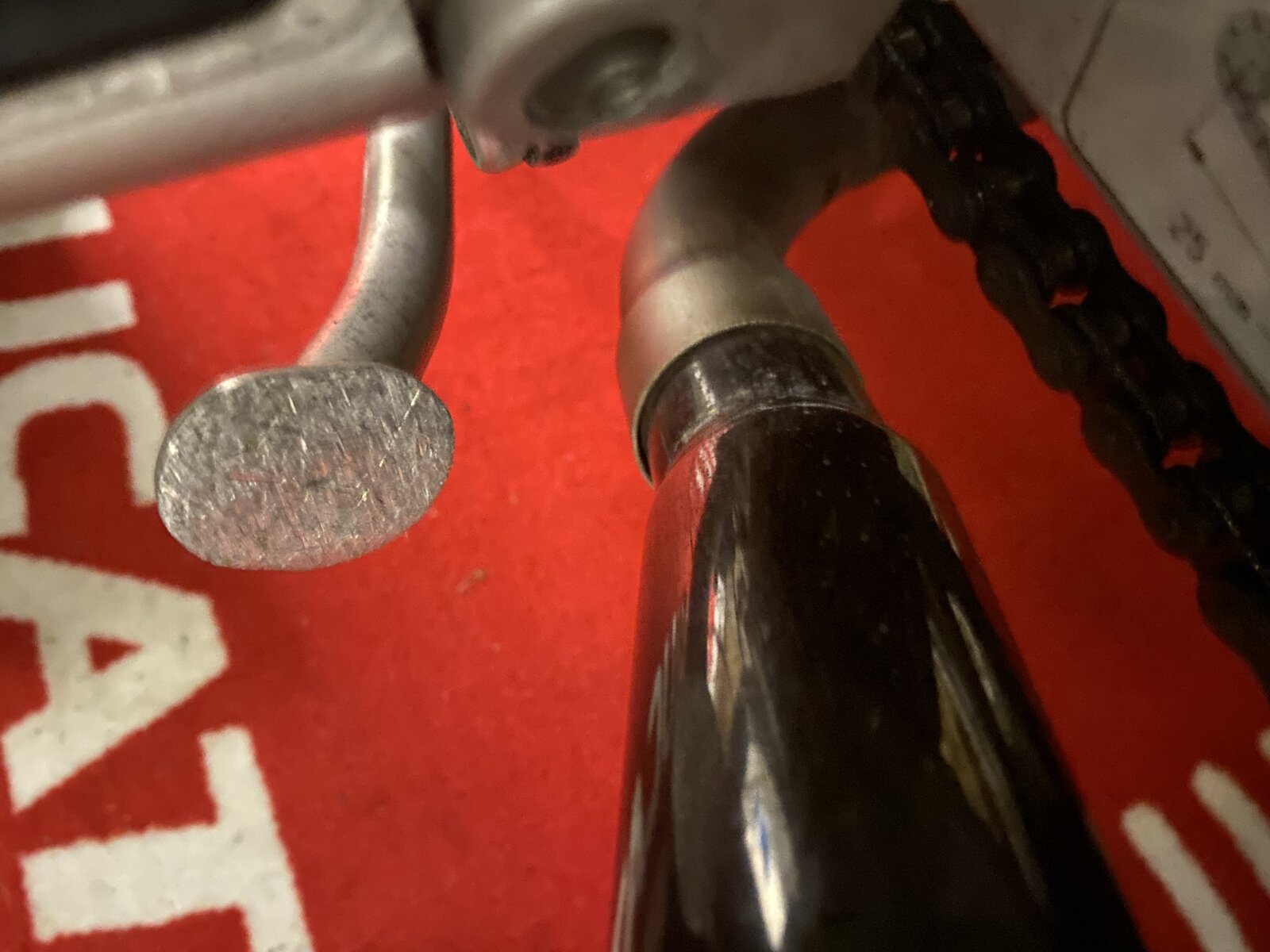

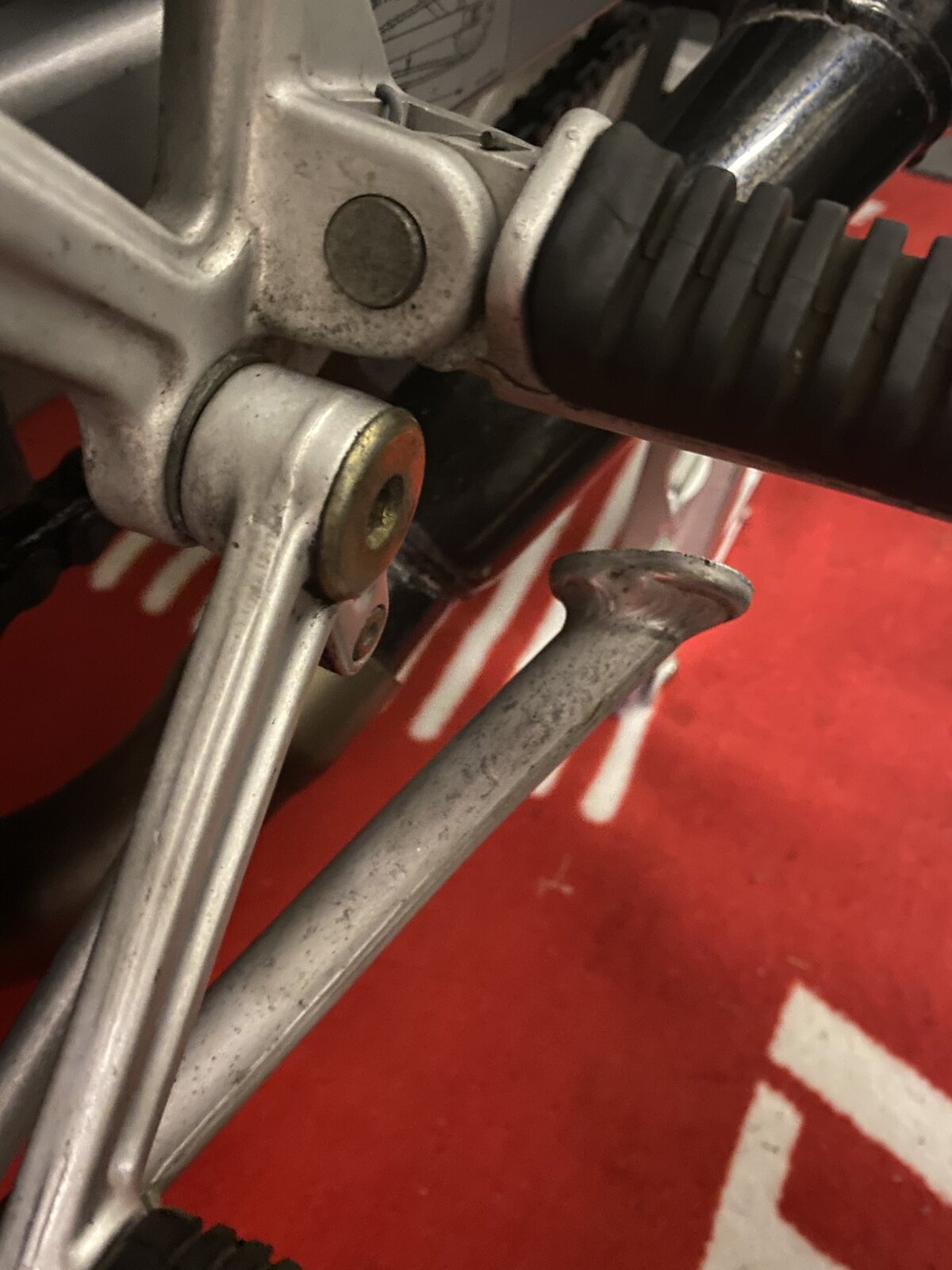

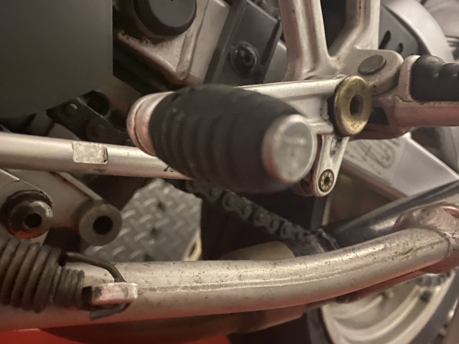

  4. Hi @gurth I have a ‘96 750SS carby and have just nipped to the garage to take some photos for you. Looks like your side stand is bent in comparison to mine.
  5. My 900 ‘97 looks identical to yours except the previous owner welded a larger foot plate on it to help with parking on a soft surface
  6. Mine is actually a ‘97 too but I think that was the crossover year?
  7. I've got this problem, I put some washers in behind the mounting plate, to bring it out a bit
