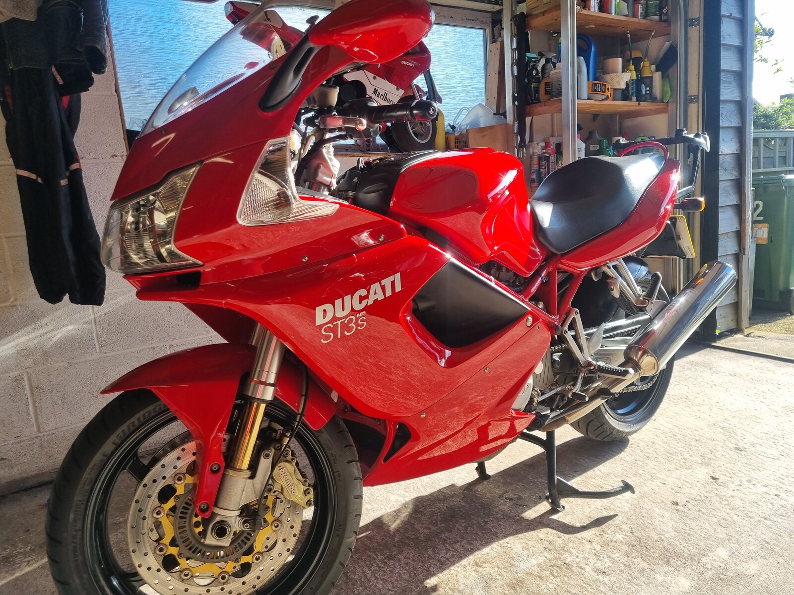

  1. Hi all
    Very happy to be back on a Ducati after a break on other bikes after selling my 888 and Multistrada
    I wanted one for a while and this lovely one owner fully serviced one is my bike of choice now its sunny!
    Its smooth as a swiss watch except its a tad jerky from closed throttle at low speed and with all the 20/30mph zones its a pain
    I looked at Fat Duc 02 manipulator as i liked them on my multi but would rather get the ECU mapped if the mapping supplier has done an ST3S before - I am in Mid Wales and i dont really want to take it for dyno time if the map is already on file - any ideas welcome.
    Maybe a front sprocket change is recommended ?

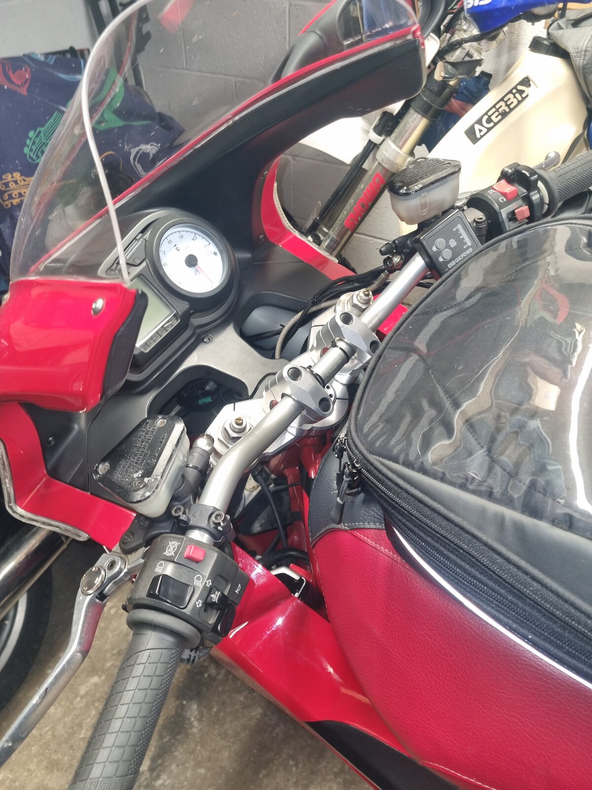

    I have (dont cry) swapped out the front yoke and clip ons and put normal bars on with a yoke from ABM in germany - for me it has worked a treat and i can share info and pics if interested -

  5. ABM kit is one of the best things I've done to my ST3

  8. Agreed works a treat + adds lots of adjustment
