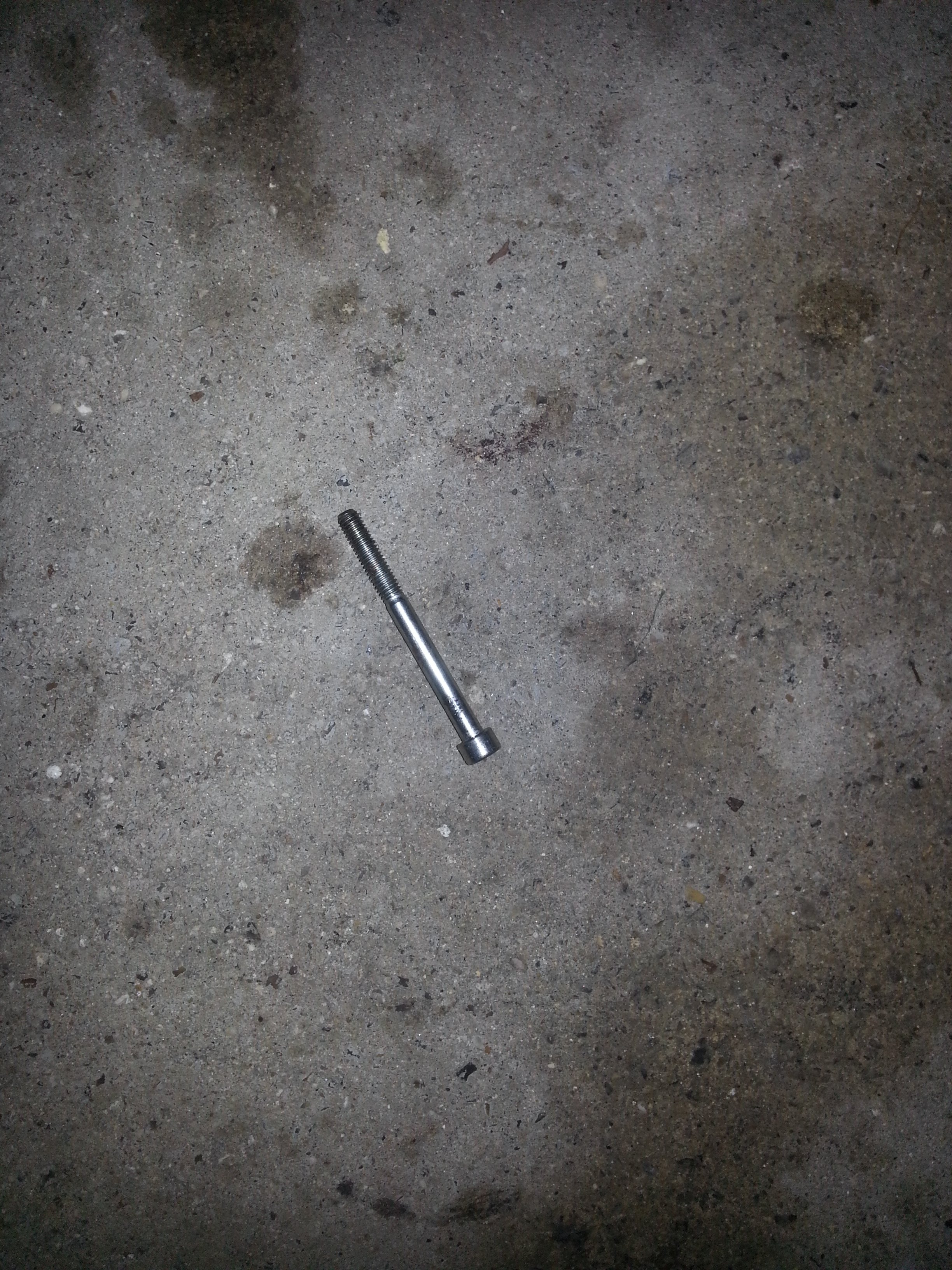

  1. Hi
    I have had to replace starter motor in my 999s... now after i have put everything together one bolt left... it is i think m6x65
    I have taken only generator cover, pump cover and bviously clutch slave.. scratching my head if there is not something inside i did not screw back but before i open it again somebody will shine some light on me?
    Could not find it in service manual either in part manual
    Thanks

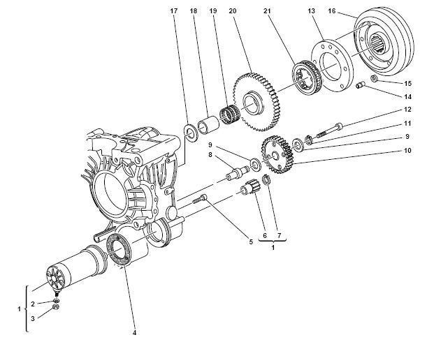

  6. Could it be No 12 in this diagram.
    Steve[​IMG]

  8. [​IMG]
    Another pic of that gear and bolt.
    Steve

  12. I think your family has a sense of humour :)
  13. Birdie spot on. You are a star! Thanks
