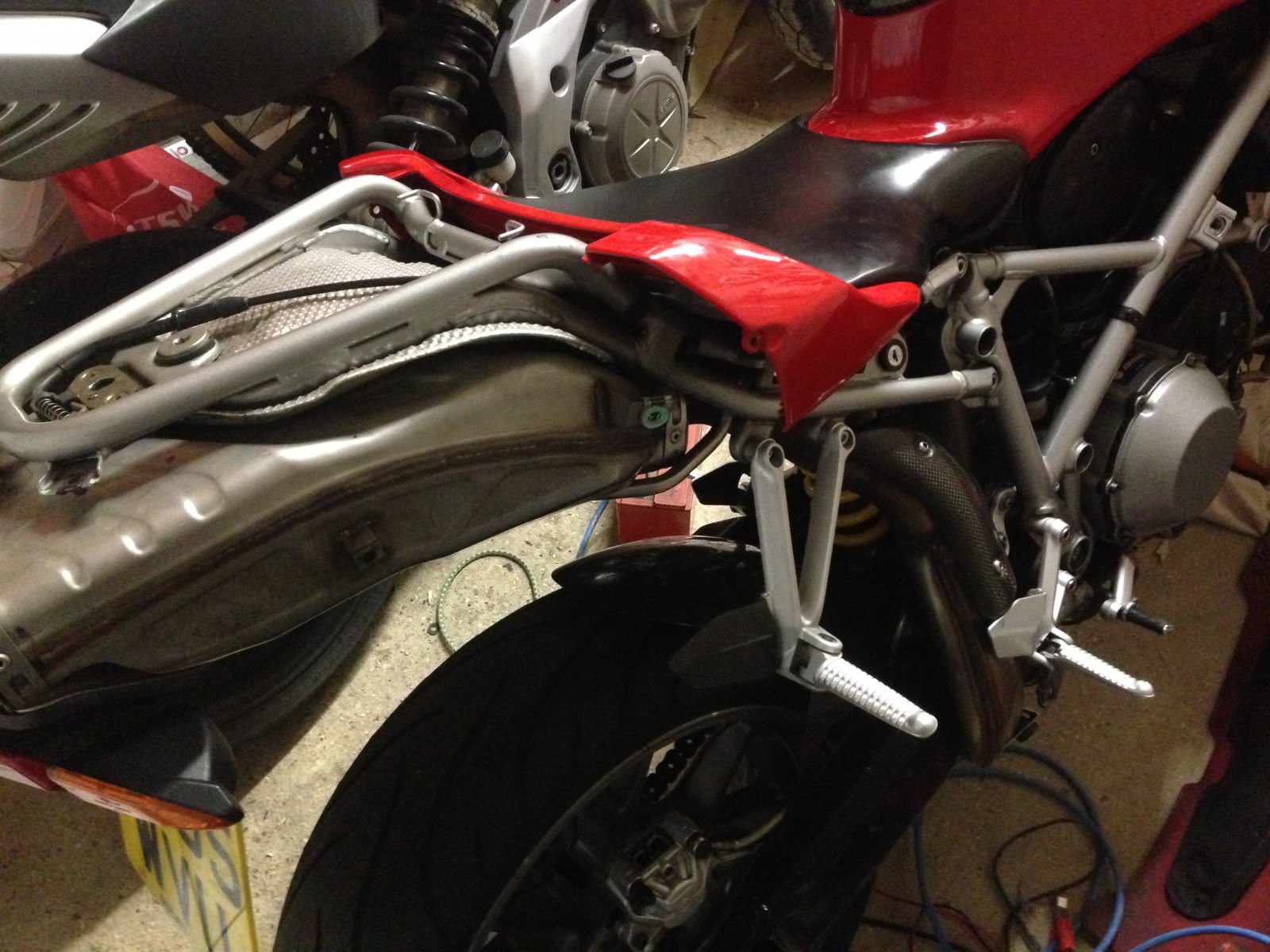

I've recently bought a 55 plate 749 which has an exhaust like shown below. The can has "For Race Use Only" stamped on it. I'd like to turn it back to stock any ideas what the exhaust might be and can i just swap the end can without a change to the ECU etc?
Will most likely be a Termignoni system. The ECU may be the DP version to match the can. It's a PIA to get to the ECU as it is on the back of the battery box behind the heat shield. If you can get the info off the labels then I can tell you what is fitted. You should really fit the stock ECU for stock cans. You will need to refit the stock link pipes as the rear CAT is inside the can and the front in the link pipe. If you don't have the original system they crop up on eBay cheap.

mate,,, that looks to me to be a full Termi system,, that ( afaik ) is the exhaust of choice for most 749 /(S ) owners , as I have myself ,, I cannot see any reason why you would want to revert back to OEM with all the hassles and cost involved.. just be glad you have got one and enjoy,,,,,,,,,,,,,,,,,,,,,, I expect there are many on here who would willingly and eagerly lighten you of that and give you their standard in exchange....

from what i can gather all Termis are marked like that,, fwiw mine was mot d the day before i bought it,,,,, dont worry about it..
