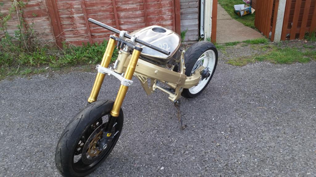

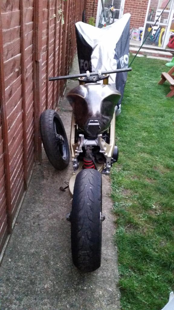

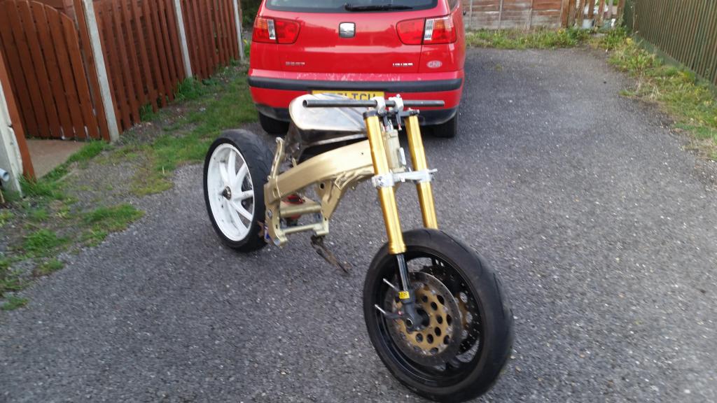

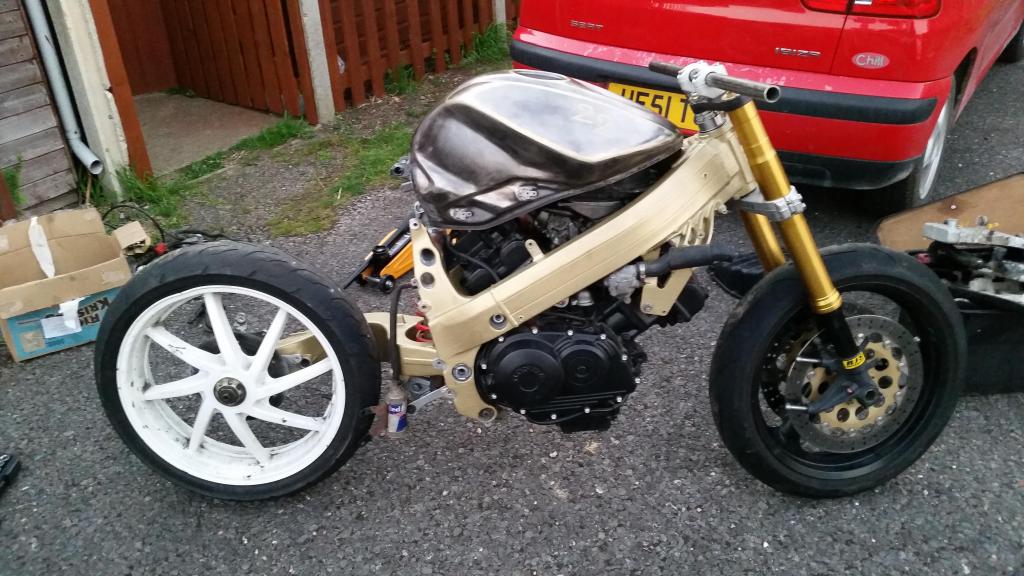

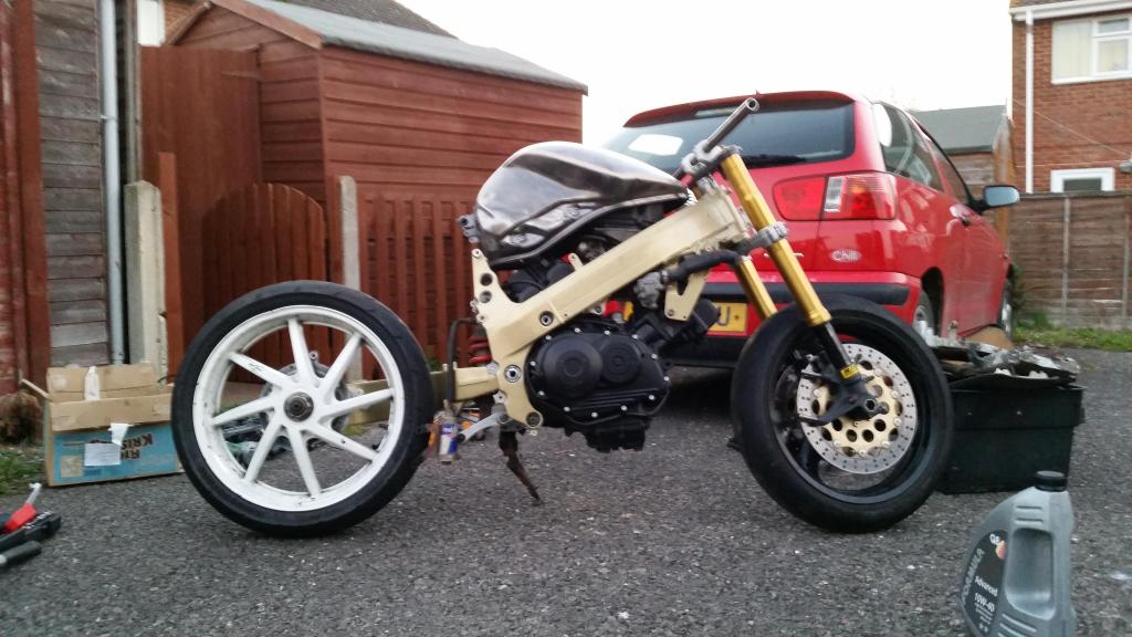

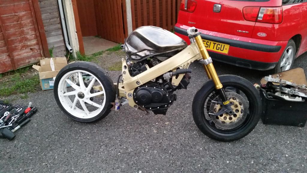

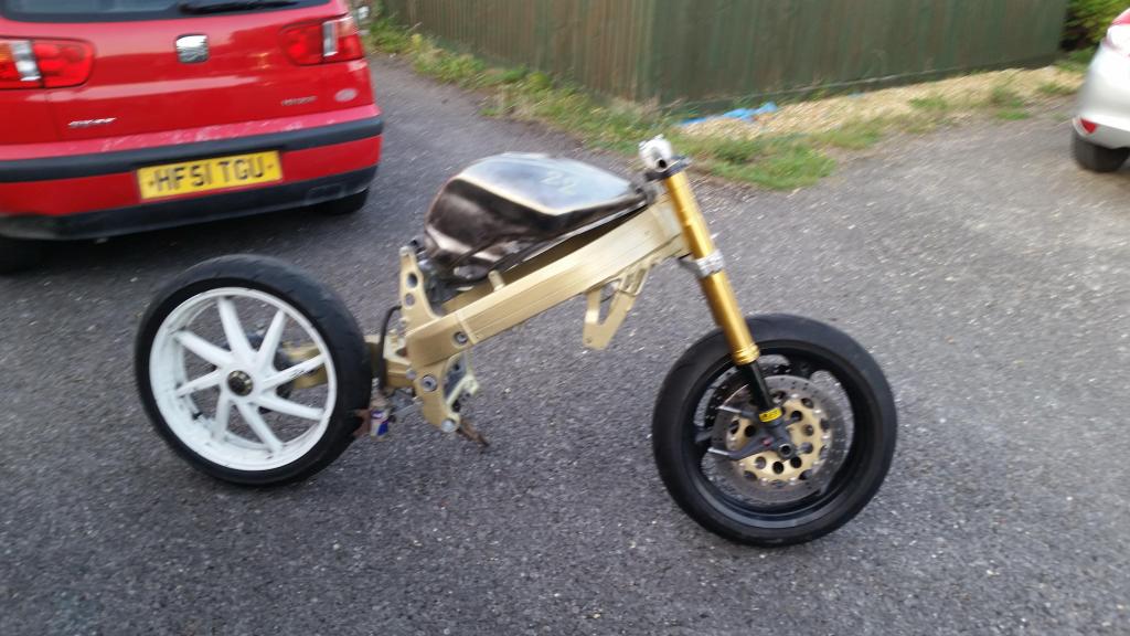

  9. Please forgive me for the crappy photos.
    Today I had a spacer fabricated to pack out the headstock and now the GSXR forks and yokes fit. I also drilled the top yoke and fitted some Triumph bar risers I had in the shed. I'm using a piece of tube to move the bike around, but they're not actually usable bars. Tomorrow I should take delivery of some bearings to fit the original front wheel. I took the old bearings out today and discovered I do have enough space to put 2 bearings in each side. I'll be less concerned about the bearings failing if I double them up.
    All of the components show in the image are balanced on, I haven't been able to torque up any bolts correctly, nor even locate all of the engine mount bolts. The air box is too large to take the triumph tank nicely which may cause problems down the road as I have heard that the air flow can be problematic if altered.
    I may also look for a cheap second bike over the winter to find spares.
