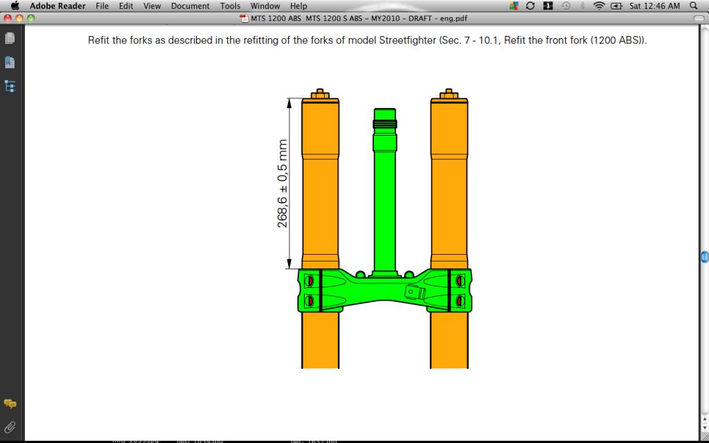

  3. Here's from the manual.
  4. Ok thanks lads
